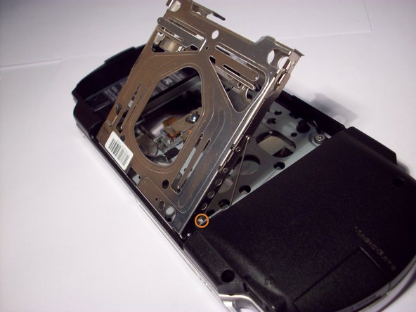

  • Next we want to remove the Disk Tray.
  • Lift up the tray while applying a little pressure to the left.
  • After the tray comes loose, notice the small catch on the right near the hinge. apply the same pressure to remove the tray.
Image #1 Image #2

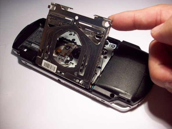

Add Note Edit Step 15  ¶
  • Hold the tray on the left side and slide it to the right.
  • Remove the tray.
Image #1 Image #2 Image #3
