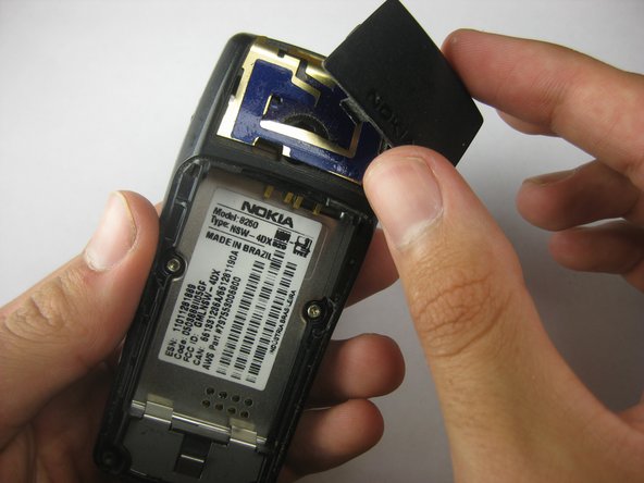

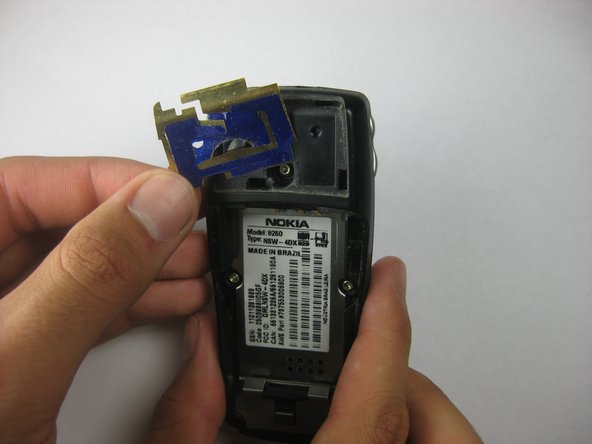

  • Remove the antenna door.
Image #1
Add Note Edit Step 10  ¶
  • If the gold antenna remained stuck to the door, you have finished removing the antenna from the phone.
  • If the gold antenna is still in the phone, carefully remove it and stick it onto the back of the door.
  • Try to keep the antenna as flat as possible. Do not bend it.
Image #1
Add Note Edit Step 11 — Circuit Board  ¶

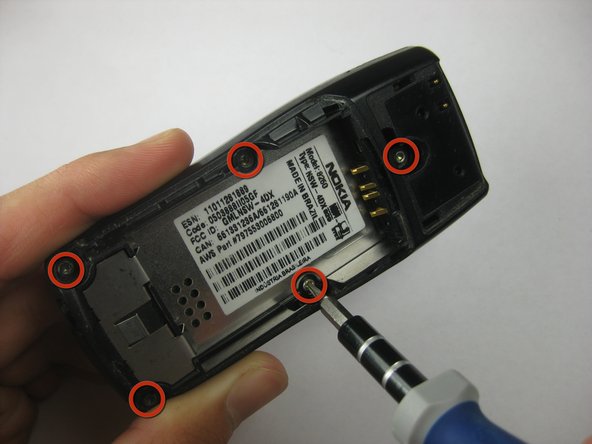

  • Remove the five screws with the Torx Screwdriver: two near the bottom, two in the middle, and one under the antenna door.
  • The two bottom screws are longer than the upper three.
Image #1
Add Note Edit Step 12  ¶

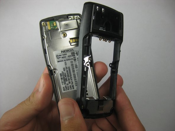

  • Remove the back covering.
Image #1
Add Note Edit Step 13  ¶

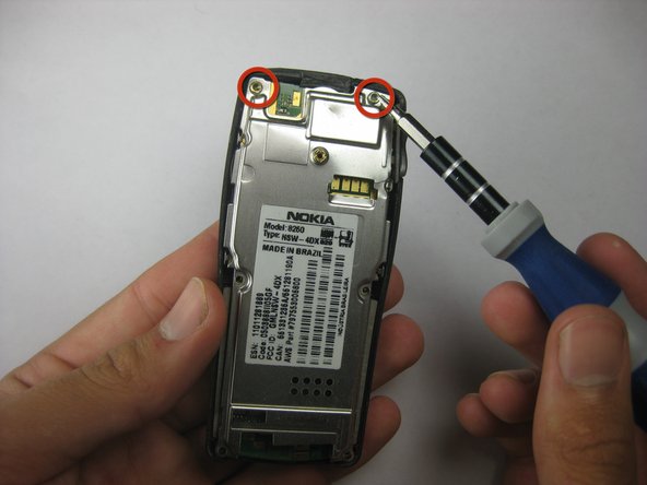

  • Remove the two screws at the top.
Image #1

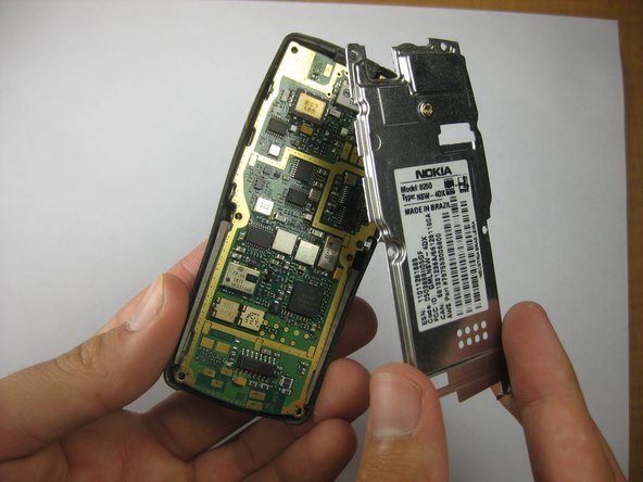

Add Note Edit Step 14  ¶
  • Remove the metal plating and the circuit board.
  • There is nothing holding the rest of the phone together. Handle the rest of the phone carefully.
  • The LCD will be attached to the circuit board.
Image #1
Add Note Edit Step 15 — Speaker  ¶

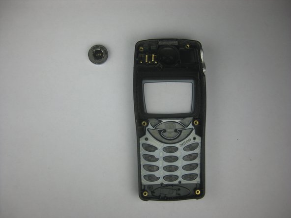

  • Remove the speaker.
