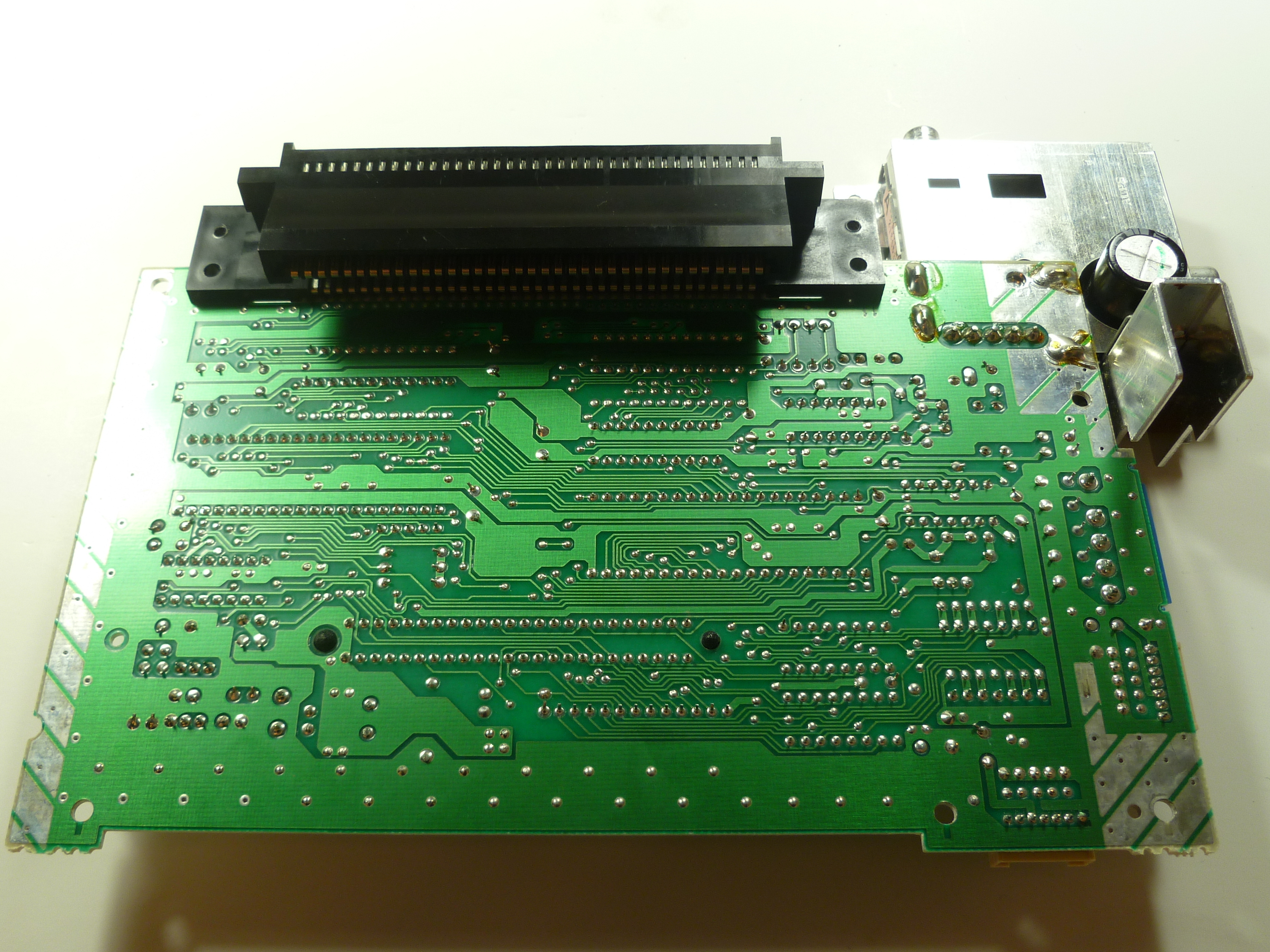

Add Note Edit Step 4 — Motherboard  ¶
  • Remove the three 13.25mm Phillips screws that secure the motherboard to the lower case with a Phillips head #2 screwdriver.
  • Pull the motherboard assembly straight up and out of the plastic case with your hands.
  • Turn the motherboard assembly over so the metal cover is facing you.
Image #1
Add Note Edit Step 5  ¶
  • Disconnect the wire harnesses from the motherboard assembly:
    • Player 1
    • Player 2
    • Power
  • Make sure you remember where player 1 and player 2 cables are plugged in; do not mix them up. A good technique would be to write each title on a piece of tape and wrap them around the appropriate wire.
Image #1 Image #2 Image #3
Add Note Edit Step 6  ¶
  • Lift off the EMI shield (metal cover)from the motherboard assembly with your hands.
  • Turn over motherboard assembly so the 72-PIN connector is on the top of the motherboard assembly.
