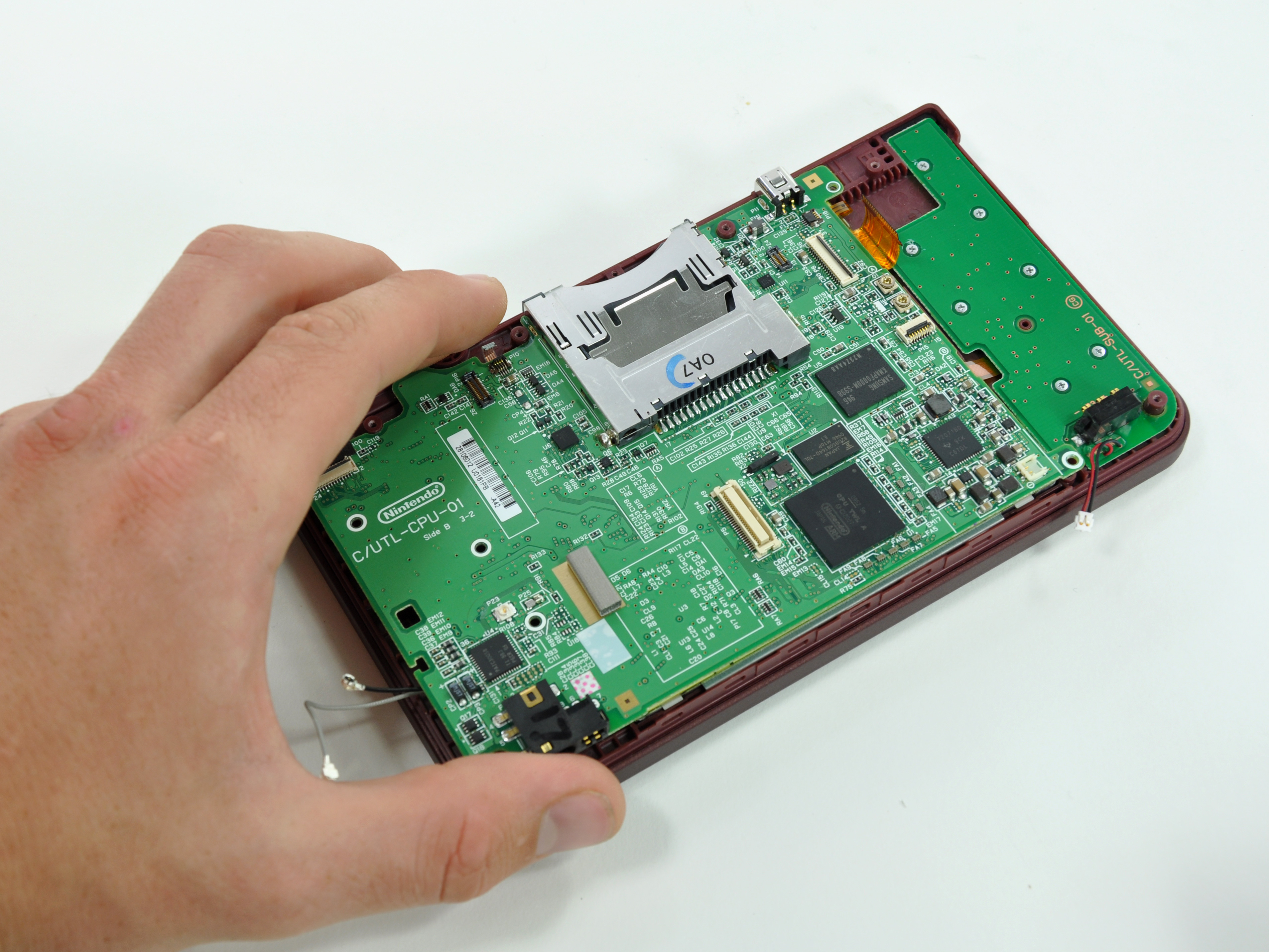

  • Remove the screws securing the motherboard to the upper case:
    • A single 2.5 mm silver Phillips screw
    • Four 3.7 mm black Phillips screws
Image #1
Add Note Edit Step 18  ¶
  • Deroute the microphone and antenna cables through the slot in the motherboard.
Image #1 Image #2
Add Note Edit Step 19  ¶
  • Rotate the motherboard off the lower case.
  • The motherboard cannot be completely removed yet. It is still attached by the upper LCD's display data ribbon cable.
Image #1 Image #2
Add Note Edit Step 20  ¶
  • Using the flat end of a spudger, flip up the retaining flap on the upper display data cable ZIF connector.
  • With the pointed end of the spudger, pull the upper display data cable from its connector on the underside of the motherboard.
  • The motherboard is now free from the upper case.
