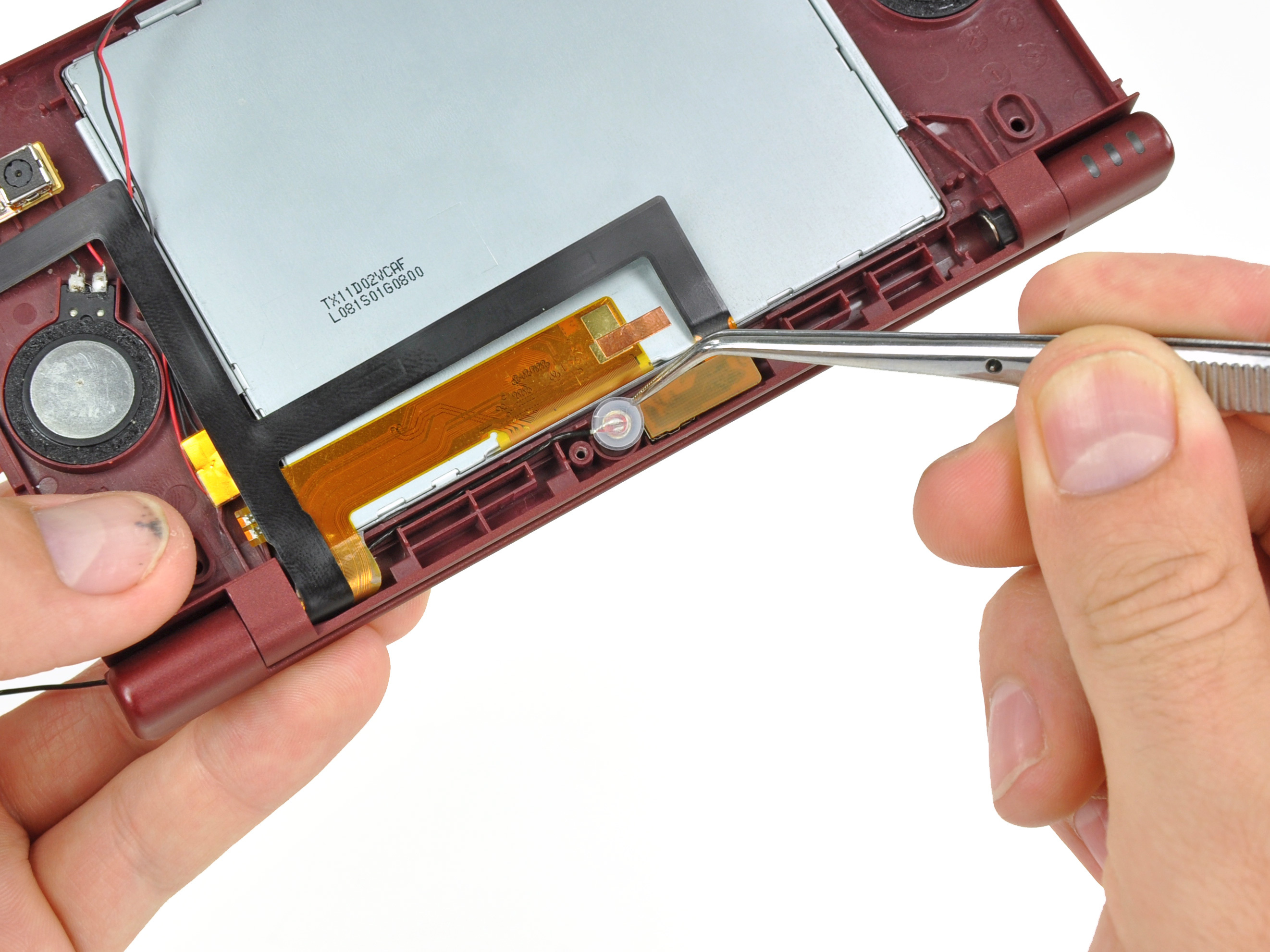

  • Close the DSi XL and turn it over.
  • Using a pair of tweezers, pull the microphone out of its housing in the front bezel.
  • De-route the microphone cable, and pull it through the right hinge.
