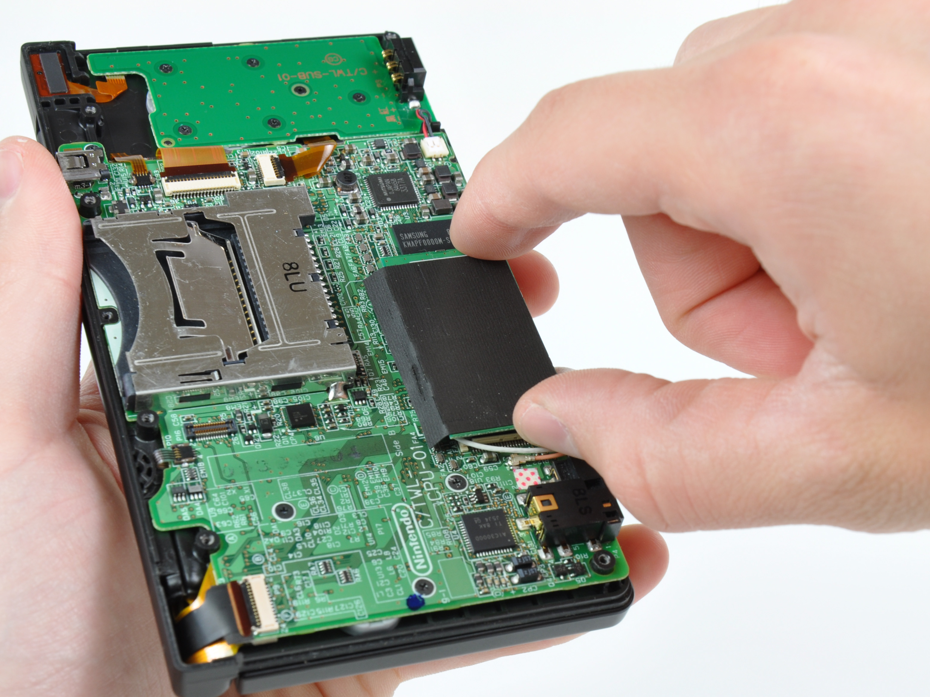

Add Note Edit Step 7 — Wi-Fi Board  ¶
  • Pull the Wi-Fi board away from the motherboard by its edge closest to the headphone jack.
Image #1
Add Note Edit Step 8  ¶
  • Pry the Wi-Fi antenna connector straight up from its socket on the Wi-Fi board.
