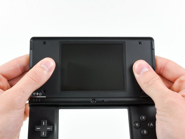

Add Note Edit Step 17 — Upper LCD/Speakers  ¶

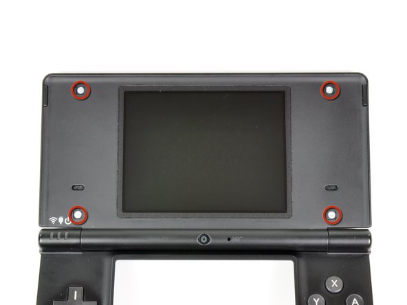

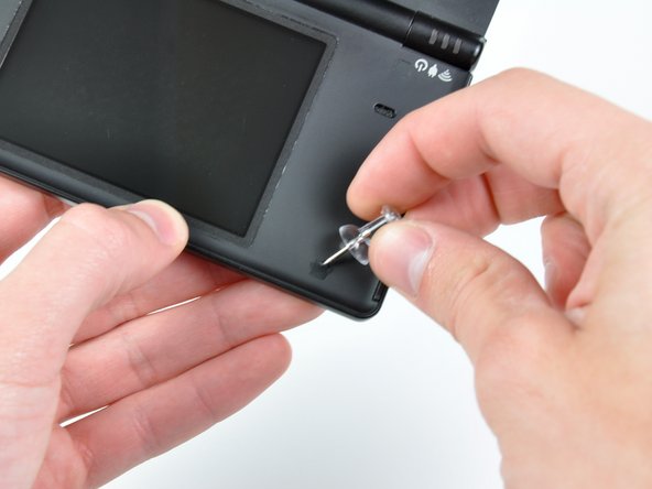

  • Use a pushpin to remove the four plastic screw covers (highlighted in red) on the front bezel.
Image #1

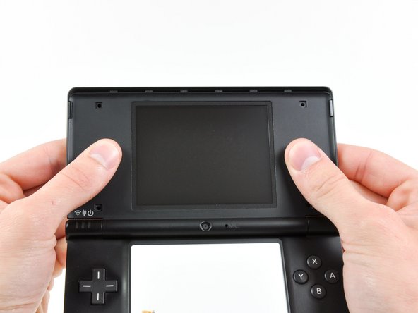

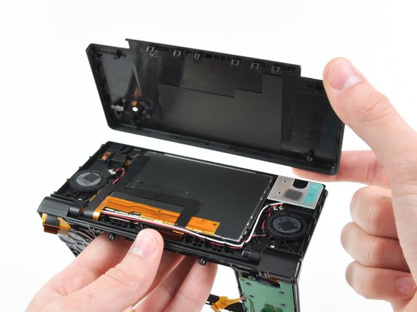

  • Using two hands, gently slide the rear bezel upwards.
  • The rear bezel will move only about 2 mm.
  • Slightly close the case of the DSi and lift the rear bezel straight up out of the DSi.
Image #1 Image #2
Add Note Edit Step 20  ¶

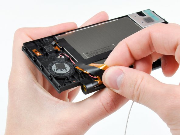

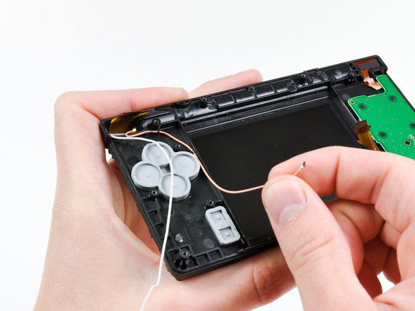

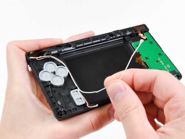

  • Continue de-routing the microphone and Wi-Fi antenna cables through the opening located on the bottom DSi's framework.
Image #1 Image #2

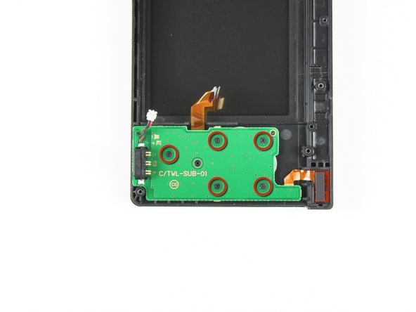

Add Note Edit Step 21  ¶

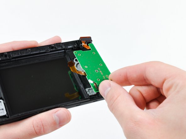

  • Remove the five Phillips screws securing the power board to the DSi's framework.
  • Lift and remove the power board from the DSi.
Image #1 Image #2

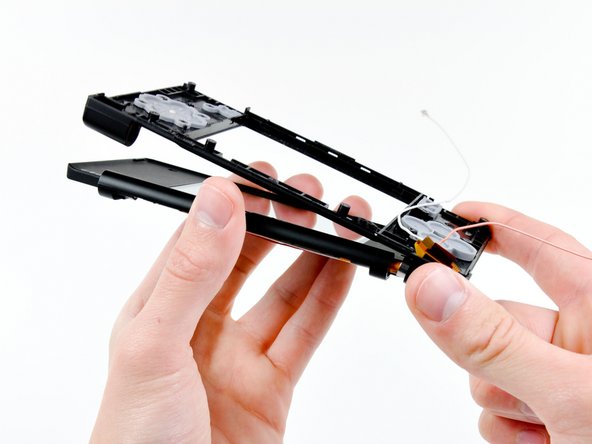

Add Note Edit Step 22  ¶

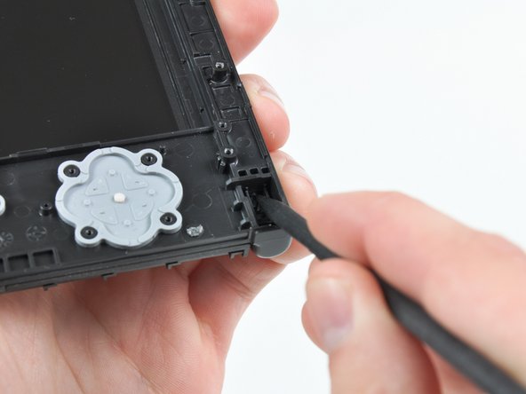

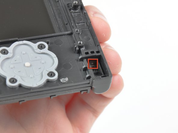

  • Push the metal hinge pin inward on the D-pad side of the front lower panel with the tip of a spudger.
  • The pin should move about 3 mm and stop. It is not necessary to try to completely remove the pin.
Image #1 Image #2 Image #3
Add Note Edit Step 23  ¶

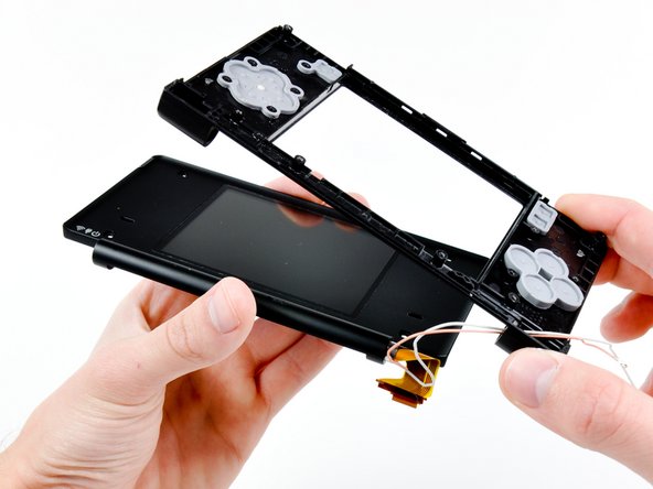

  • Slightly detach the lower and upper halves of the DSi.
  • Do not completely separate both halves yet. There are several ribbon cables that remain threaded through both panels.
  • De-route the upper LCD and dual camera ribbon cables through the slit near the ABXY side of the front lower panel.
  • Separate the lower and upper halves from each other.
Image #1

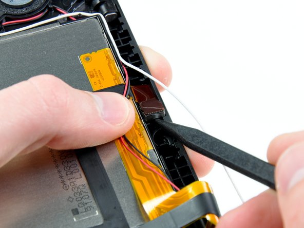

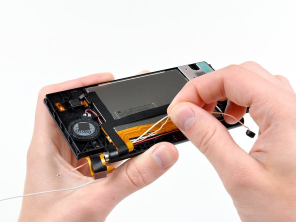

Add Note Edit Step 24  ¶
  • Using your fingers, grasp the microphone cable and de-route it through the hinge.
  • The microphone will likely pop out of its housing, so it is probably easier to completely remove it at this point.
  • De-route the Wi-Fi cable through the hinge.
Image #1 Image #2

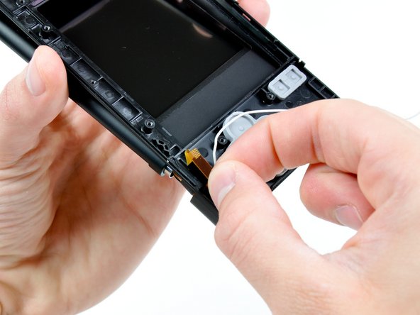

Add Note Edit Step 25  ¶

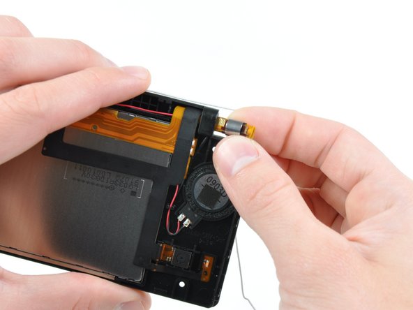

  • Tightly coil the display and dual camera ribbon cables enough to push them through the steel hinge tube.
  • Remove the steel hinge tube.
  • Carefully push both coiled ribbon cables through the tube molded into the front upper panel.
Image #1

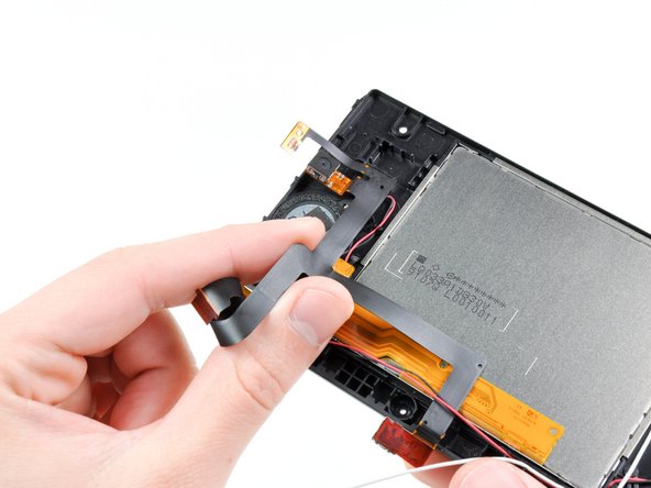

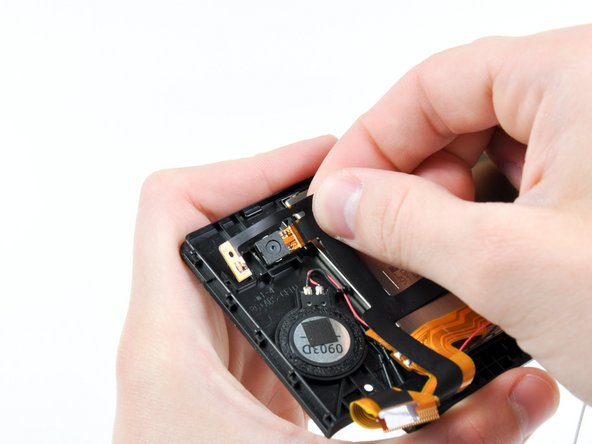

  • Pry the front-facing camera straight up out of its housing in the front bezel.
Image #1 Image #2
Add Note Edit Step 27  ¶
  • Lift the rear-facing out of its housing in the front bezel.
  • Remove the dual camera cable assembly from the DSi.
Image #1 Image #2
Add Note Edit Step 28  ¶
  • De-route the Wi-Fi antenna cable from its channel in the front bezel.
  • Lift the Wi-Fi antenna board straight up and remove it from the DSi.
Image #1 Image #2
Add Note Edit Step 29  ¶
  • Use the flat end of a spudger to pry the right speaker straight up and out of its housing in the front upper panel.
  • Lift the right speaker and set it on top of the upper LCD.
Image #1 Image #2
