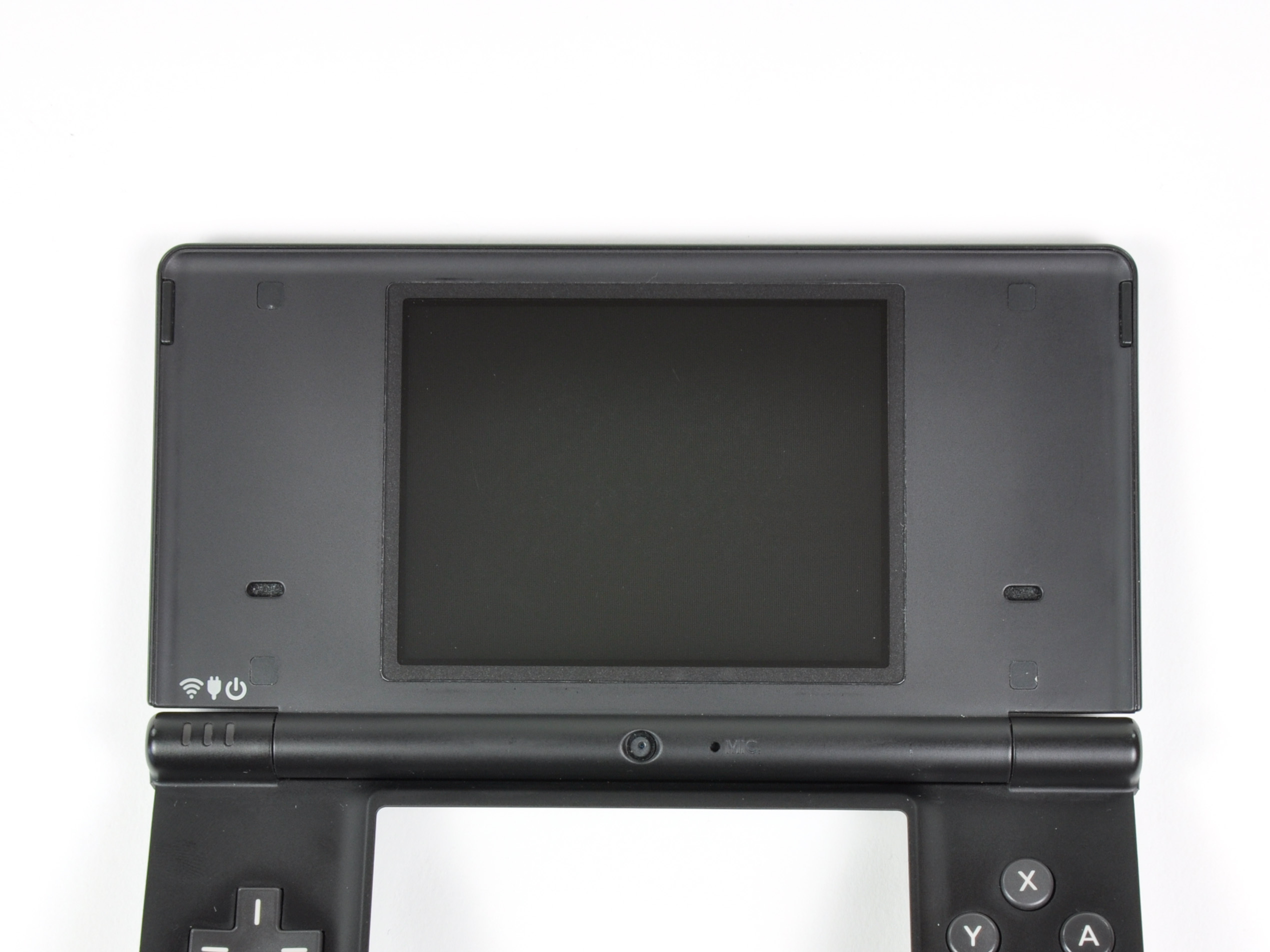

This guide will walk you through replacing the upper LCD on your DSi.
Image #1 Image #2
  • Unscrew the two Phillips screws securing the battery cover to the lower case.
  • The screws remain captive to the battery cover.
  • Grasp the battery cover and lift out of the lower case.
Image #1 Image #2
