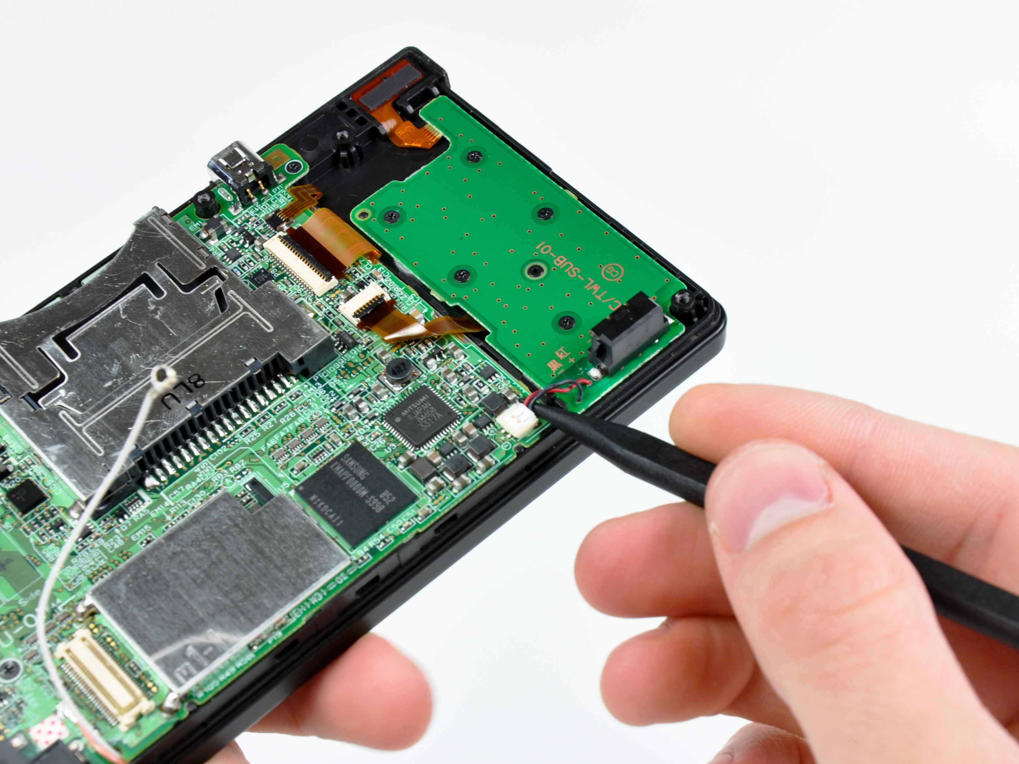

Add Note Edit Step 9 — Motherboard  ¶
  • Use the tip of a spudger to pry the power board connector out of its socket on the motherboard.
