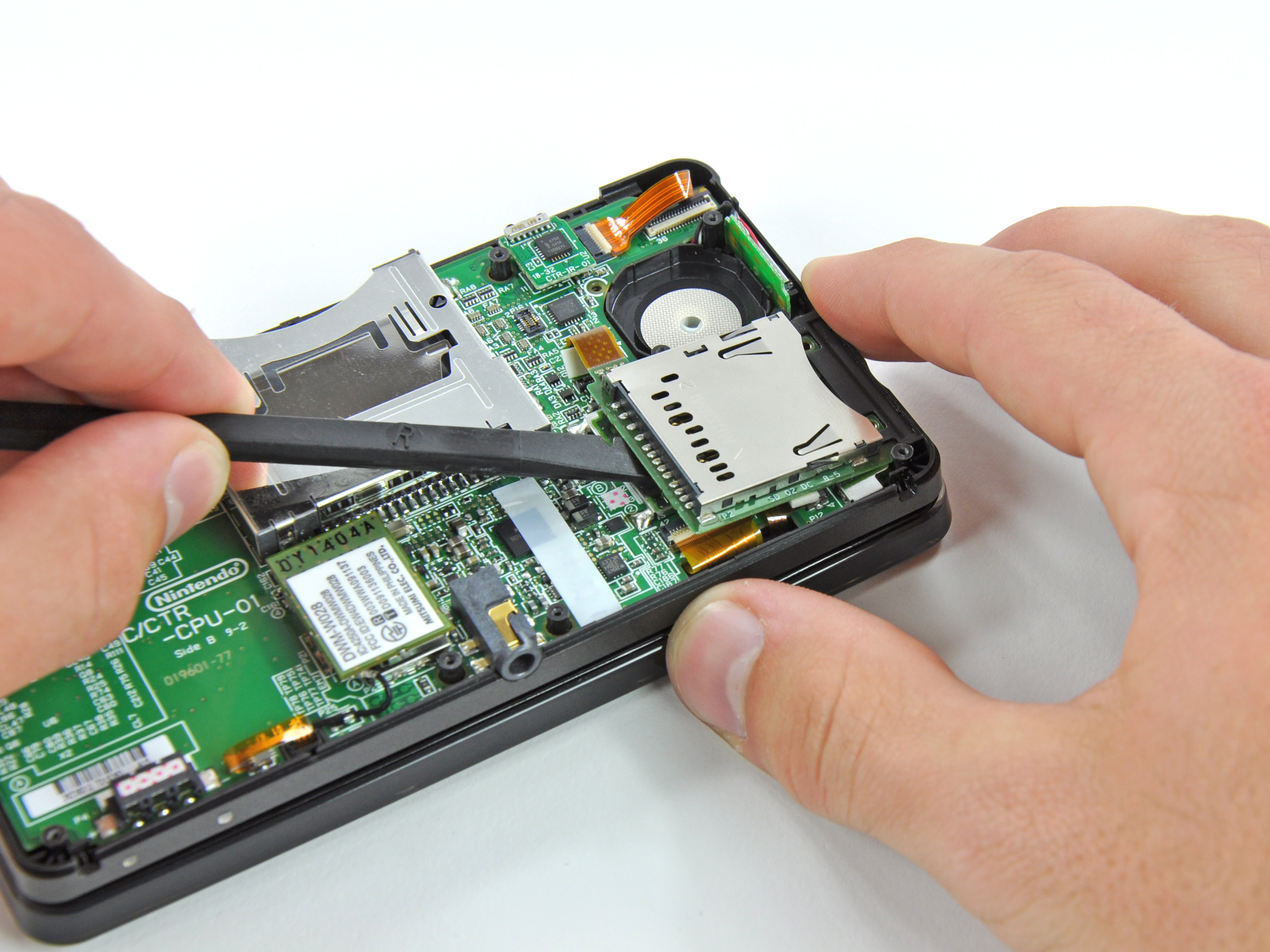

Add Note Edit Step 3  ¶
  • Insert the flat end of a spudger between the SD board and the motherboard.
  • Run the spudger along the sides of the SD board to free it from the adhesive pad holding it in place.
  • Once completely freed, lift the SD board straight off the motherboard.
