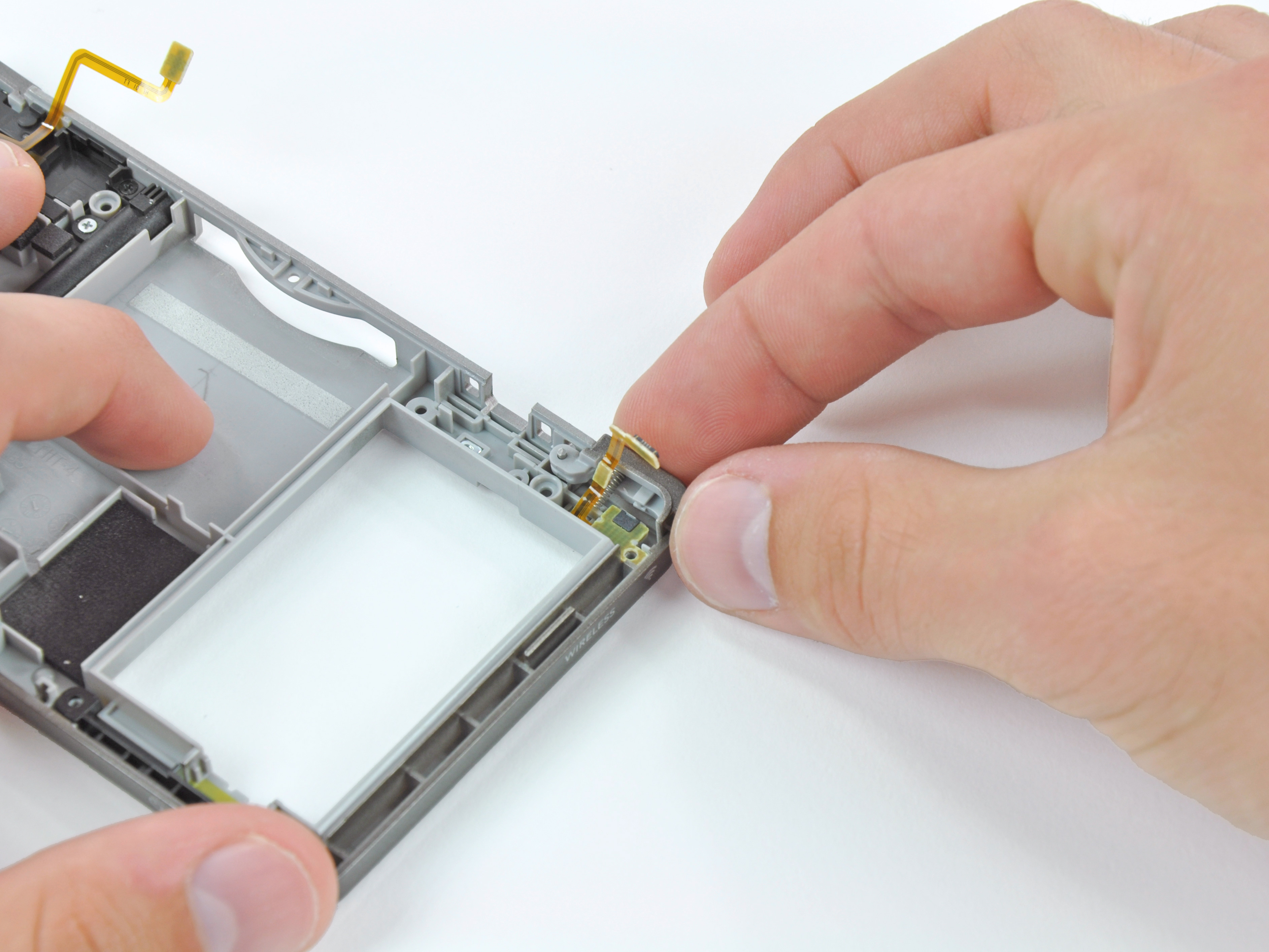

  7. Nintendo 3DS Right Shoulder Button Replacement: step 7, image 1 of 1
    • Remove the 3.6 mm Phillips screw from the right shoulder button cover.
  8. Nintendo 3DS Right Shoulder Button Replacement: step 8, image 1 of 3 Nintendo 3DS Right Shoulder Button Replacement: step 8, image 2 of 3 Nintendo 3DS Right Shoulder Button Replacement: step 8, image 3 of 3
    • Insert a plastic opening tool under the left side of the right shoulder button cover.
    • Pry the black plastic cover up from the lower case.
    • Grab the cover and lift it off of the lower case.
    • If the shoulder button contact and ribbon cable come off with the cover, be sure to reinstall them in the correct orientation.
  9. Nintendo 3DS Right Shoulder Button Replacement: step 9, image 1 of 3 Nintendo 3DS Right Shoulder Button Replacement: step 9, image 2 of 3 Nintendo 3DS Right Shoulder Button Replacement: step 9, image 3 of 3
    • Lift the right shoulder button out of the lower case.
    • The shoulder button is held in place by a metal pin, and houses a small spring. Take care not to lose track of either of these pieces when removing the shoulder button.
