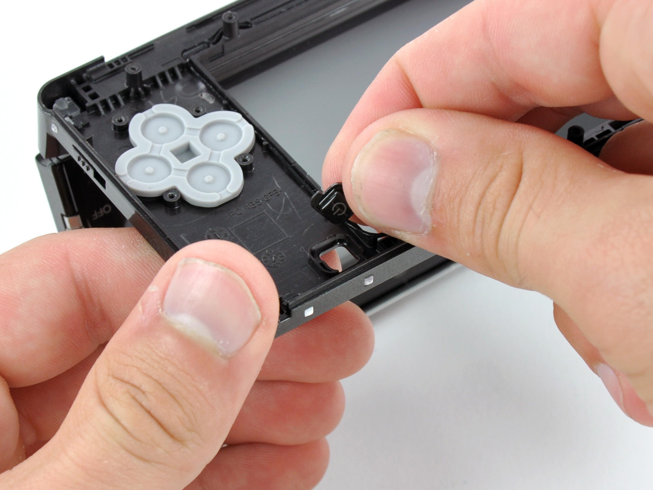

Add Note Edit Step 21 — Power Button  ¶
  • Peel the silicone cover from the back of the power button.
Image #1 Image #2
Add Note Edit Step 22  ¶
  • Open the 3DS, but keep the backside of the buttons facing upward.
  • Use your finger to push the power button up through the upper case and remove it.
  • The power button only fits in one orientation, so be sure to reinstall it correctly.
