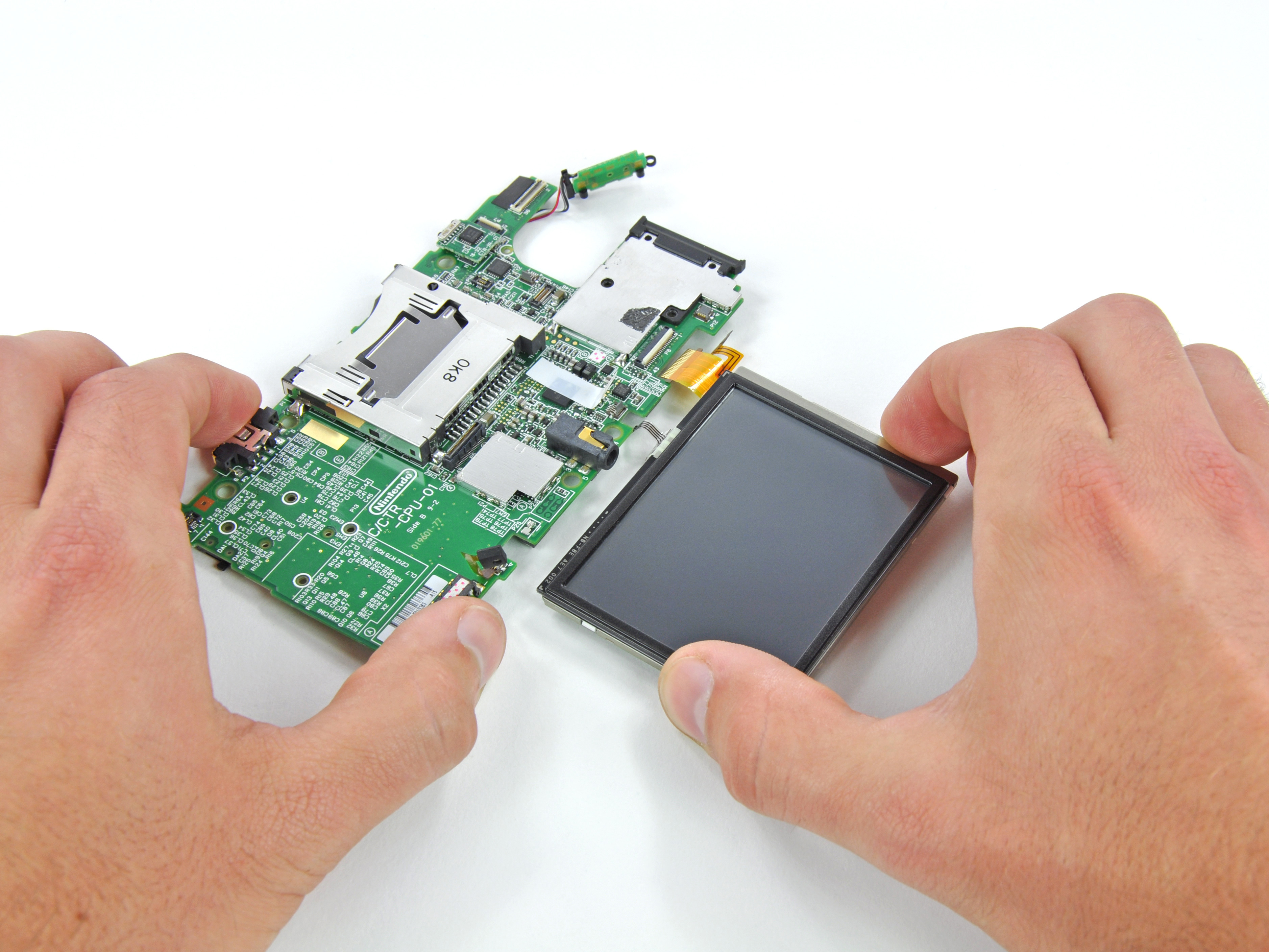

Installing Nintendo 3DS Lower Display Assembly
Lower display assembly removal
If both the LCD and touchscreen of your lower display are bad, then you'll have to replace the whole thing.

Add Note Edit Step 6 — Circle Pad Joystick  ¶
  • Remove the two 7.7 mm Phillips screws securing the back of the Circle Pad to the motherboard.
Image #1 Image #2 Image #3
Add Note Edit Step 7  ¶
  • Use the flat end of a spudger to pry the back of the Circle Pad off the motherboard.
  • Lift the Circle Pad joystick off the motherboard and lay it on its back so that the ribbon cable connector is accessible.
Add Note Edit Step 8  ¶
  • Use the flat end of a spudger or your fingernail to flip up the retaining flap on the Circle Pad ribbon cable ZIF socket.
  • Lift the Circle Pad joystick off the motherboard.
