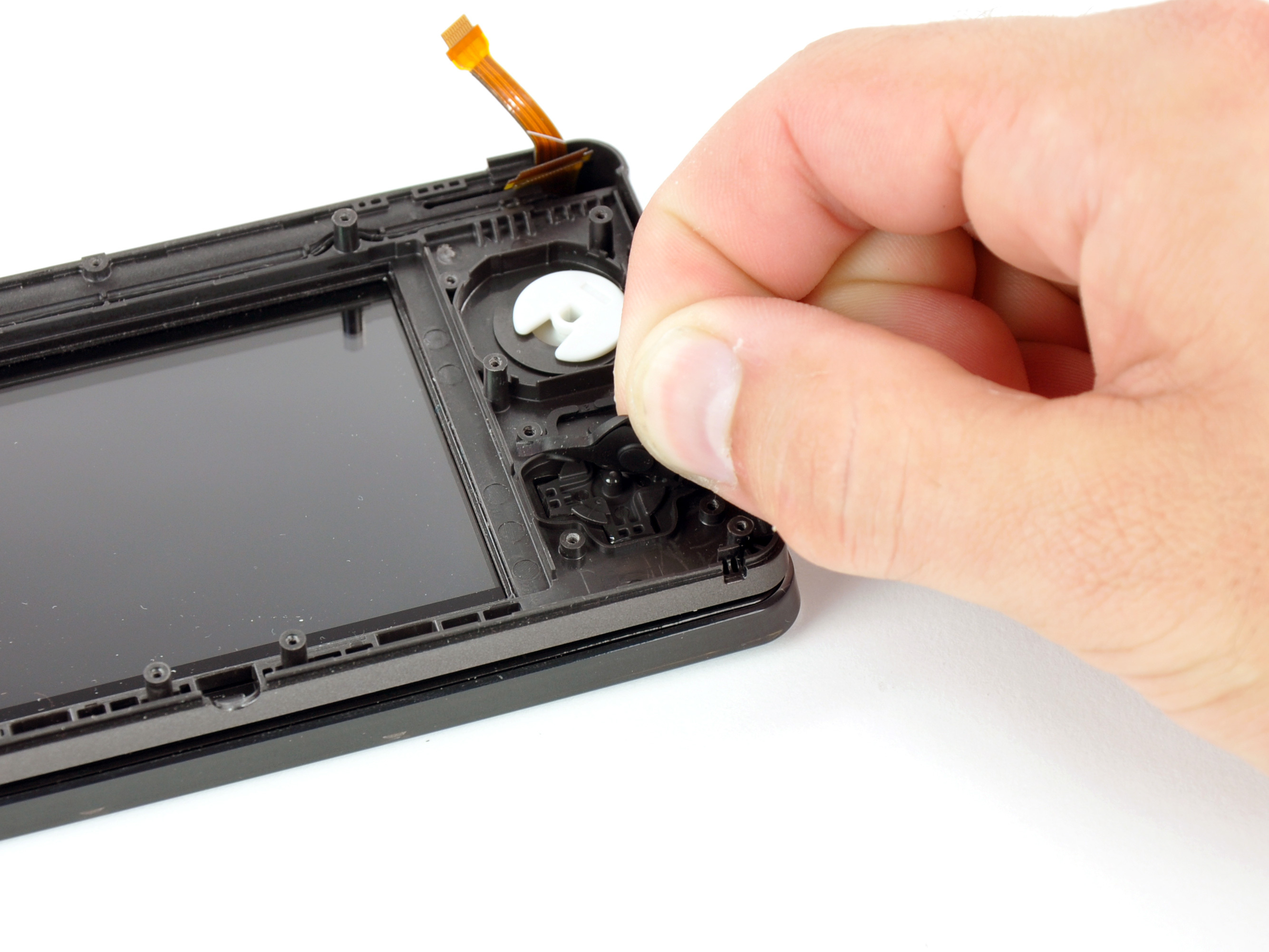

Add Note Edit Step 21 — D-pad  ¶
  • Peel the black silicone cover off the back of the D-pad.
Image #1 Image #2
Add Note Edit Step 22  ¶
  • Open the 3DS and orient it so that the bottoms of the buttons are facing upward.
  • Use your finger to push the D-pad through its hole in the upper case.
  • Remove the D-pad.
