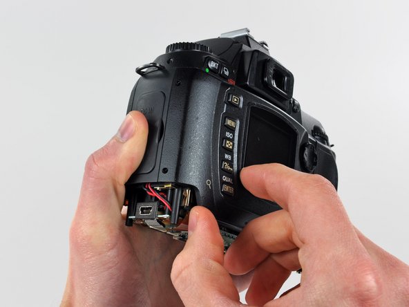

  • Use your finger tip to pull the battery release tab toward the center of the D70.
  • Open the battery door and rotate it away from the bottom cover.

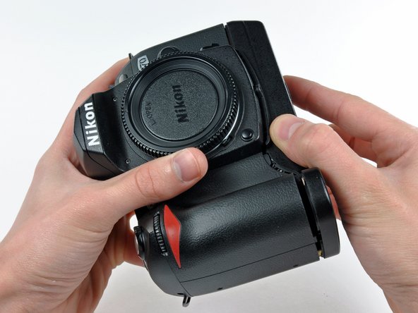

Add Note Edit Step 3 — Bottom Cover  ¶
  • Remove the following eight screws securing the bottom cover to the D70:
    • Six 5.8 mm Phillips screws
    • One 10.7 mm Phillips screws
    • One 8.2 mm Phillips screws
Image #1 Image #2

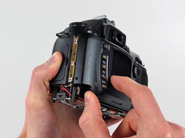

Add Note Edit Step 5 — Rear Cover Assembly  ¶
  • Remove the two 4.8 mm Phillips screws securing the battery side of the rear cover to the D70.
Image #1
Add Note Edit Step 6  ¶
  • Remove the two 4.8 mm Phillips screws securing the port side of the rear cover to the D70.
Image #1 Image #2

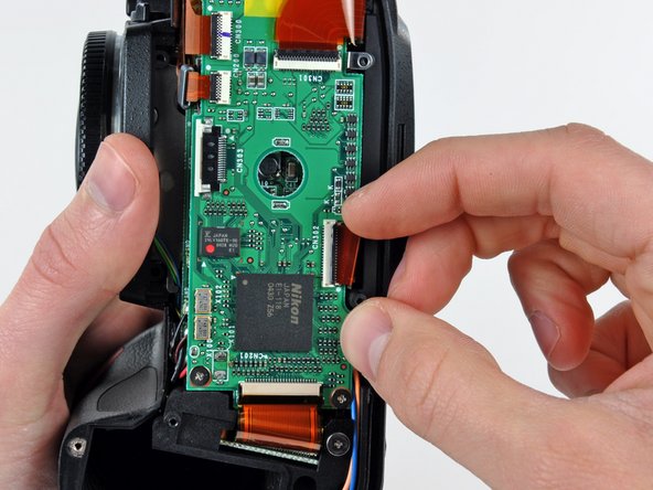

Add Note Edit Step 7  ¶
  • Use your fingernail to flip up the ZIF locking flap on the LCD ribbon cable socket.
  • Be sure you are opening the locking tab, not pulling against the socket mounted to the board.
  • Pull the LCD board ribbon cable out of its socket.

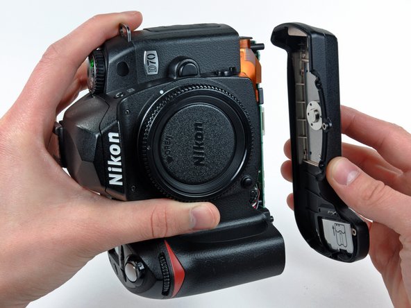

Image #1 Image #2
Add Note Edit Step 8  ¶
  • Carefully pull the sides of the rear cover away from the body of the D70.
