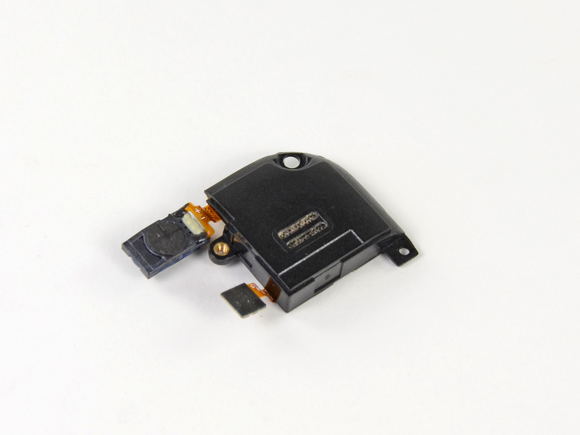

  • Wedge the plastic opening tool near the bottom right corner of the motherboard and pry upwards to dislodge it from its recess.
  • Lift and remove the motherboard.
Image #1
Add Note Edit Step 18 — Speaker  ¶
  • Speaker remains.
  • Be careful, the earpiece part is united with the speaker, you could cut the flex.
