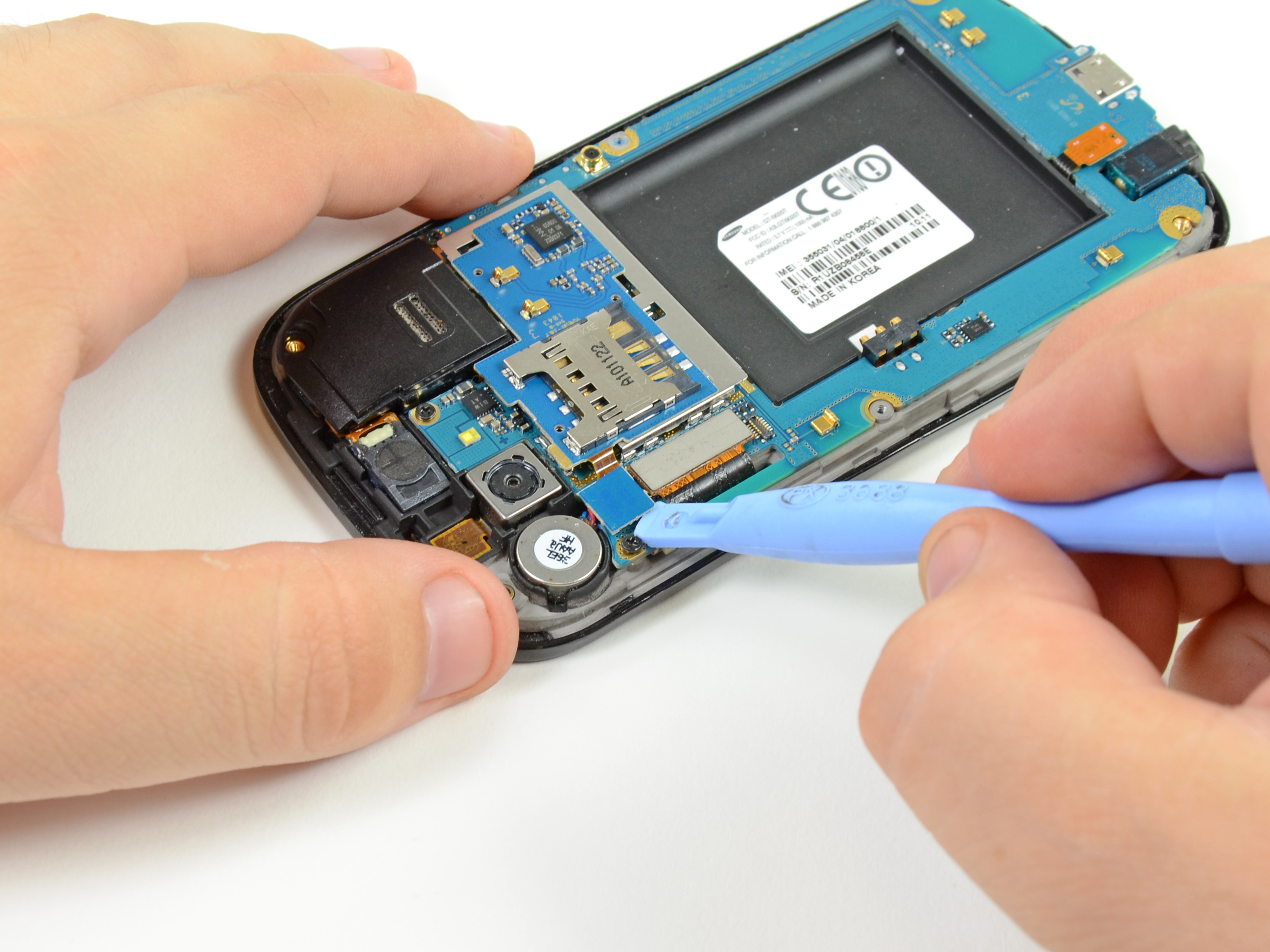

Add Note Edit Step 1 — SIM Card Board  ¶
  • Use the flat edge of a plastic opening tool to pry the SIM Board connector off its socket on the motherboard.

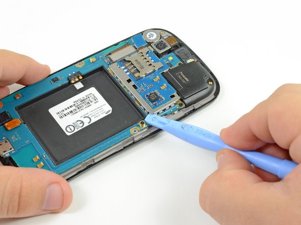

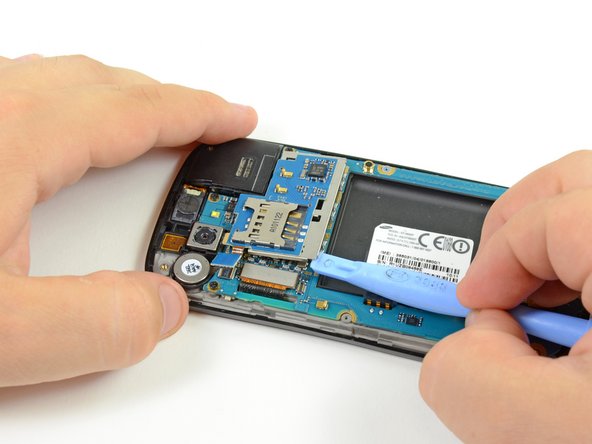

Add Note Edit Step 2  ¶
  • Wedge the edge of a plastic opening tool underneath the SIM Card board and motherboard.
  • Pry the clips located near the right bottom edge of the SIM Card board up off the motherboard.
  • Repeat the process all along the bottom perimeter of the SIM Card board until all clips have been disengaged.

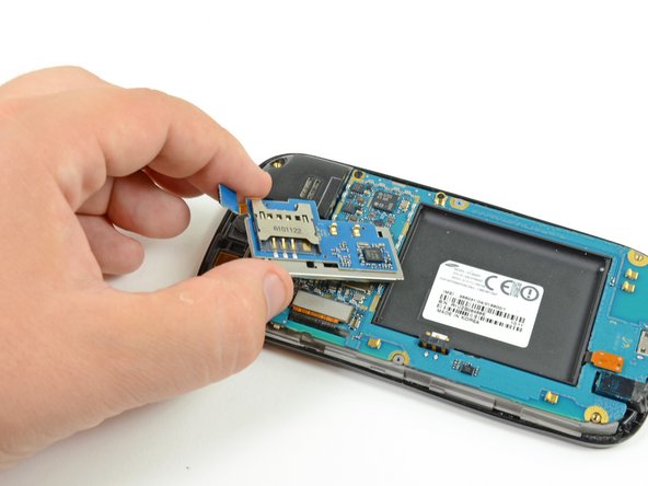

Add Note Edit Step 3  ¶
  • Lift and remove the SIM Card board out of the Nexus S.
