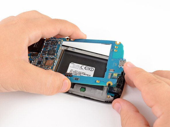

  • Lift and remove the motherboard from the Nexus S, minding any cables that may get caught.

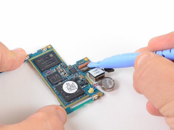

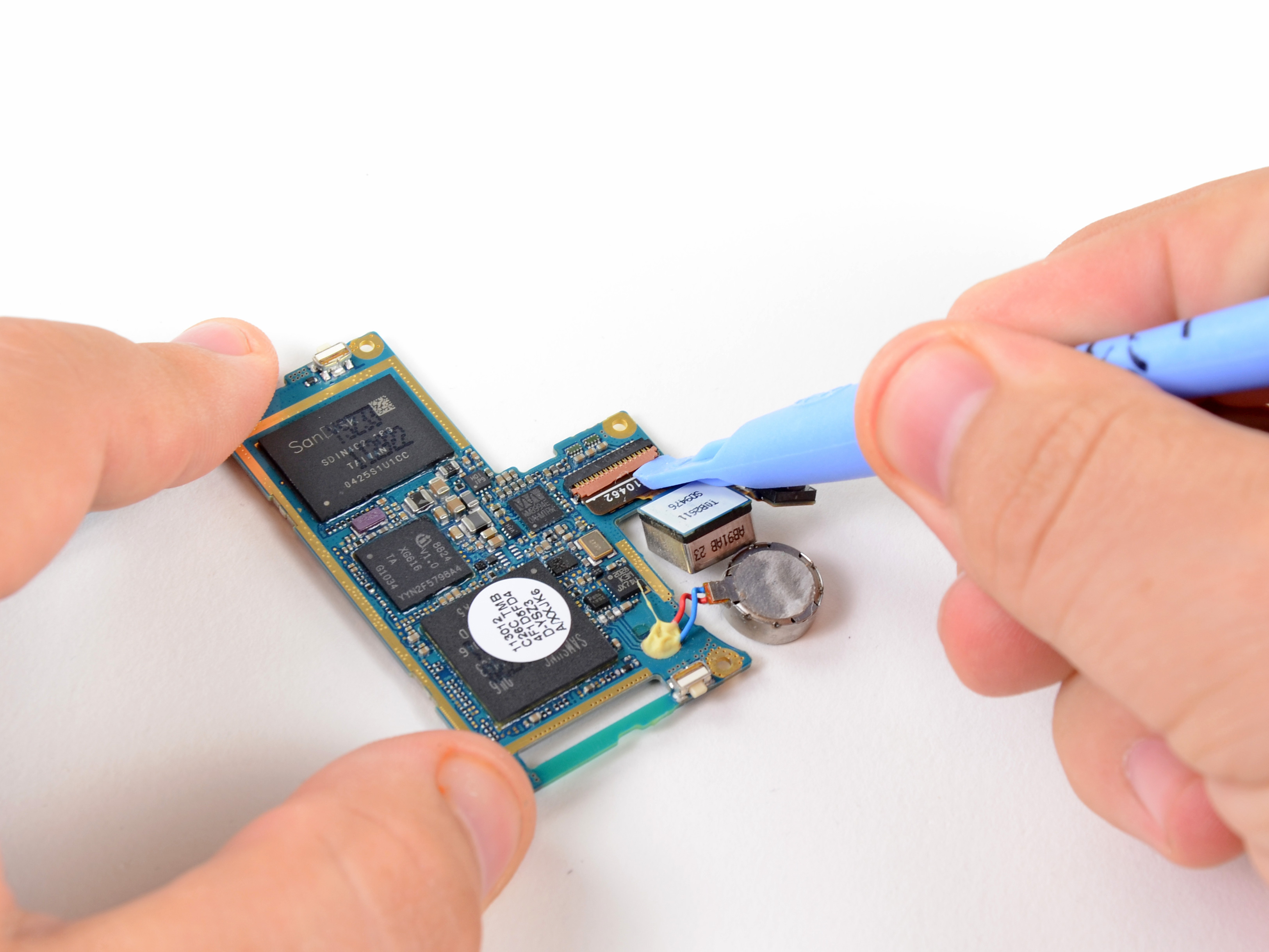

Add Note Edit Step 18 — Rear Camera  ¶
  • Use the edge of plastic opening tool to flip up the rear facing camera ZIF connector.

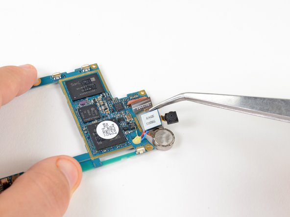

Add Note Edit Step 19  ¶
  • Use a pair of tweezers to lift and remove the rear camera from the motherboard.
