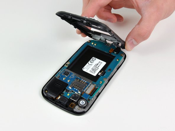

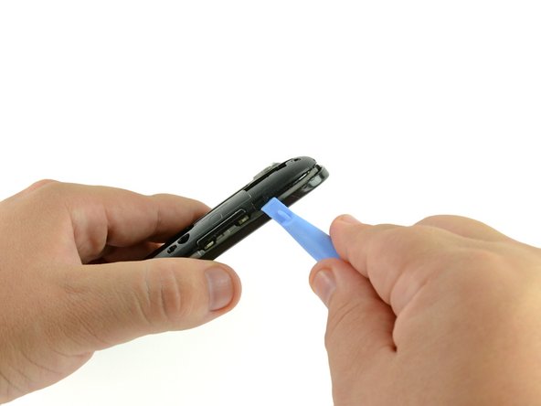

  • Insert and pry the plastic opening tool to release the final clip securing the rear inner frame to the inner assembly.
Image #1
Add Note Edit Step 10  ¶
  • Lift and remove the rear inner frame from the Nexus S.
Image #1

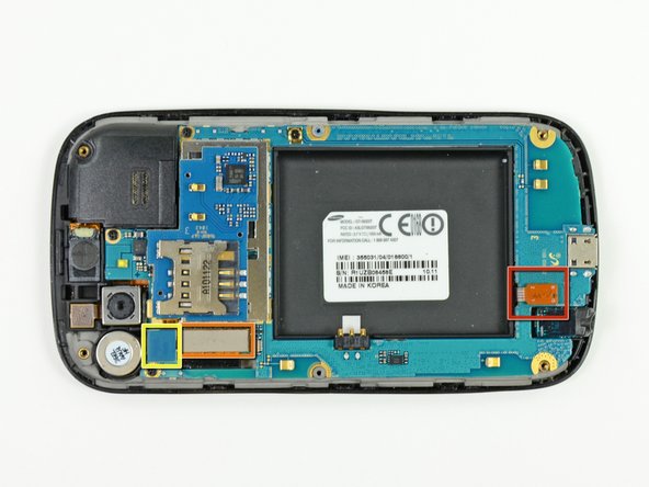

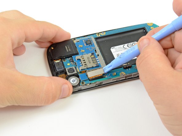

Add Note Edit Step 11 — Motherboard  ¶
  • Disconnect the following cables from their respective sockets on the motherboard:
    • Headphone jack cable
    • Digitizer cable connector
    • Camera/SIM board connector
Image #1 Image #2 Image #3

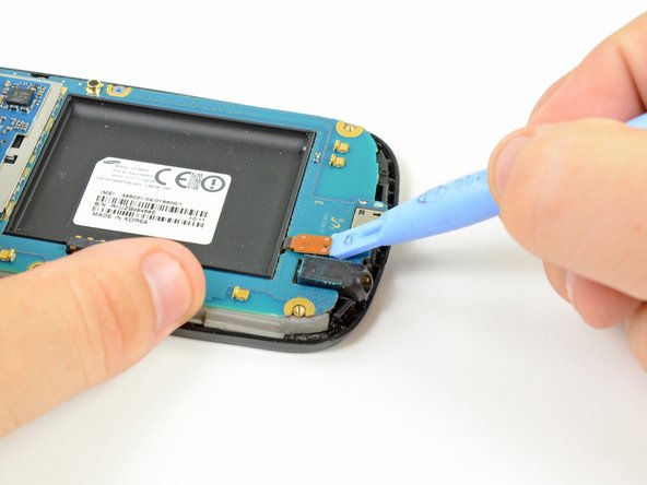

Add Note Edit Step 12  ¶
  • Insert the flat edge of a plastic opening tool underneath the headphone jack connector and pry upwards.
  • Make sure to pry on the connector and not the socket itself. Prying the socket may cause severe damage.
  • Repeat the procedure for the digitizer and rear camera/SIM board connectors.

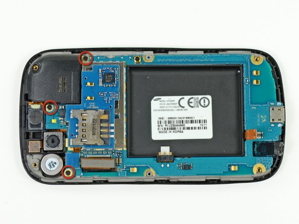

Add Note Edit Step 13  ¶
  • Remove the three Phillips screws securing the motherboard to the front display assembly.
Image #1 Image #2

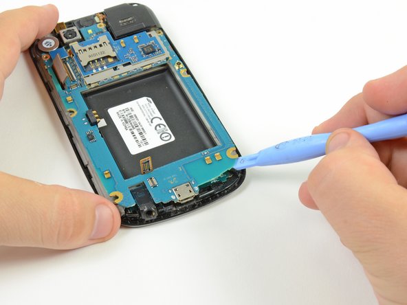

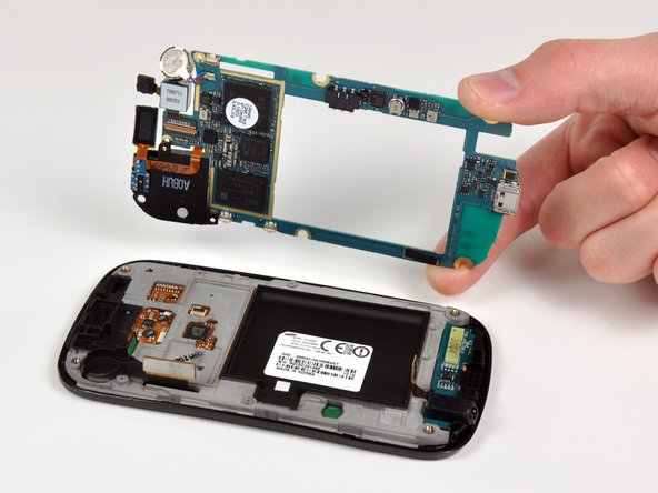

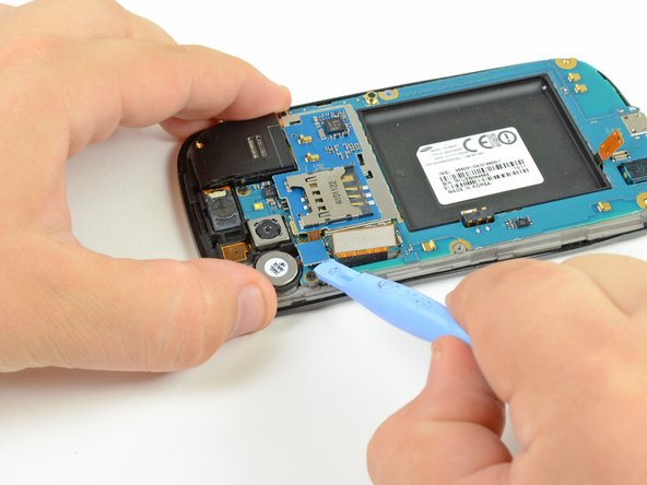

Add Note Edit Step 14  ¶
  • Wedge the plastic opening tool near the bottom right corner of the motherboard and pry upwards to dislodge it from its recess.
  • Lift and remove the motherboard.
Image #1

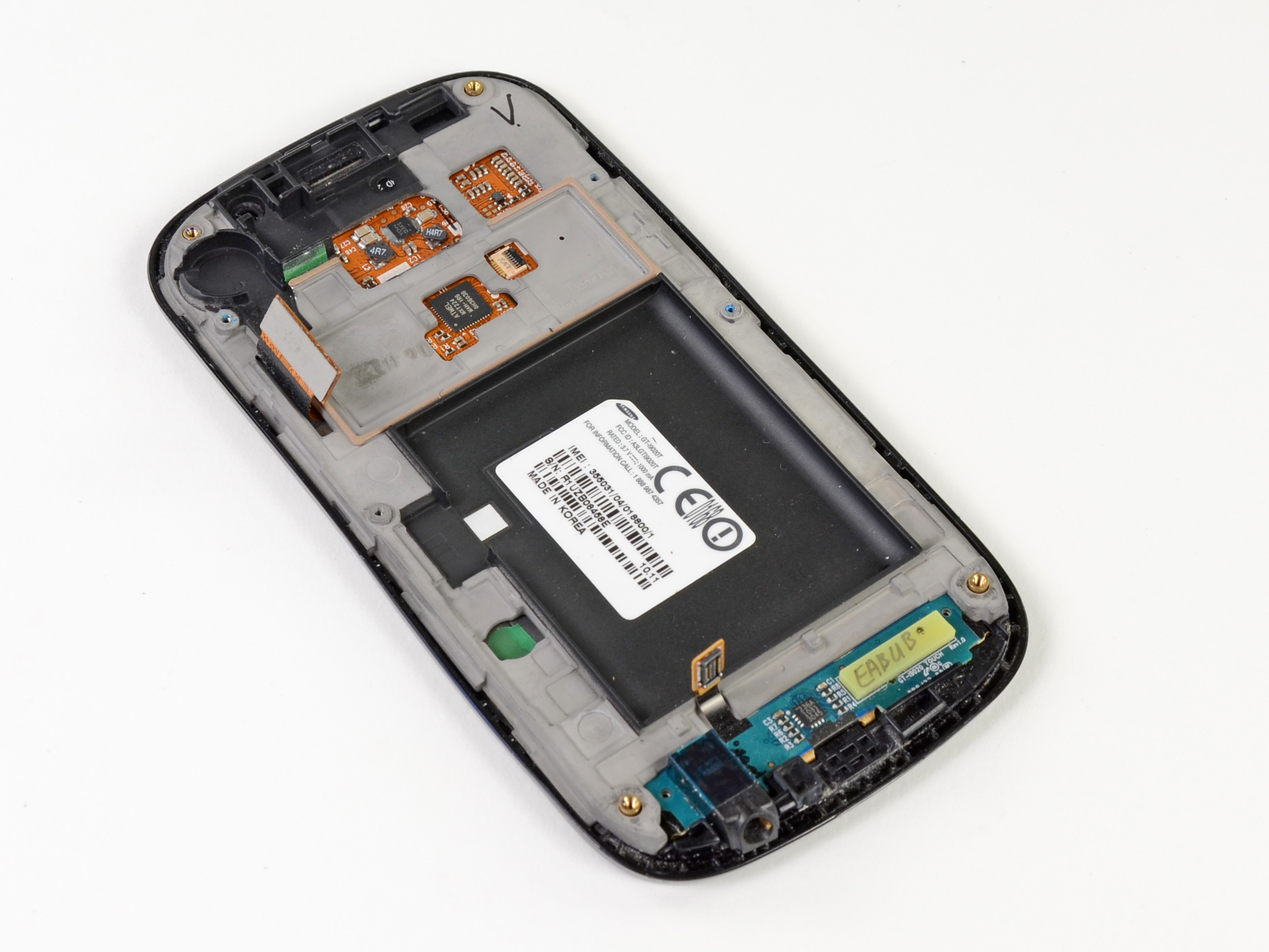

Add Note Edit Step 15 — Front Panel Assembly  ¶
  • Front panel assembly remains.
