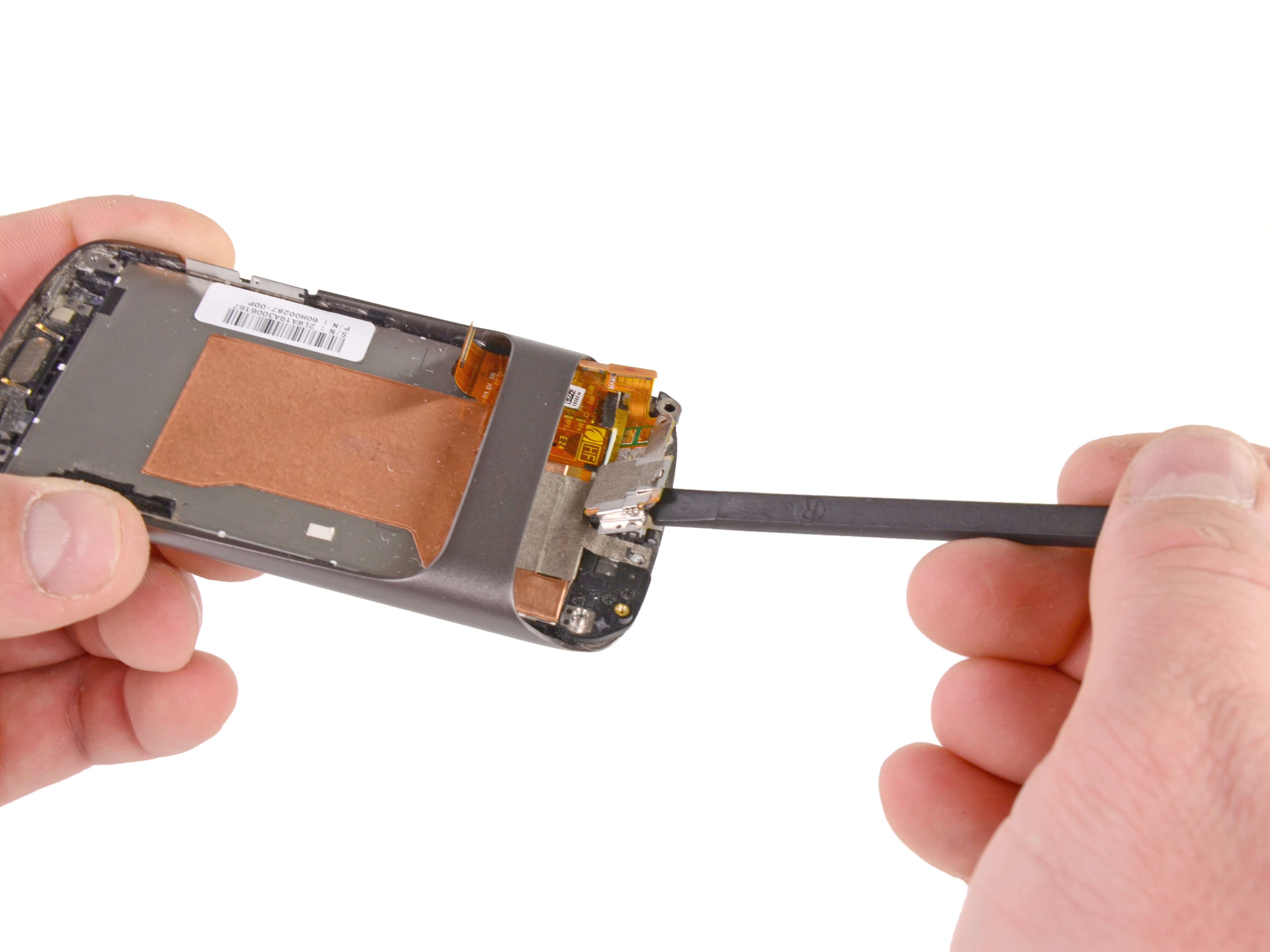

Add Note Edit Step 25  ¶
  • Using the spudger, pry up the trackball housing to expose the trackball assembly.
No image
Add Note Edit Step 26  ¶
  • The trackball pushes out from the outside of the phone.
  • The trackball assembly only mounts a single way. The metal tab under the ball should hinge closest to the bottom of the phone. (RE-EDIT)
