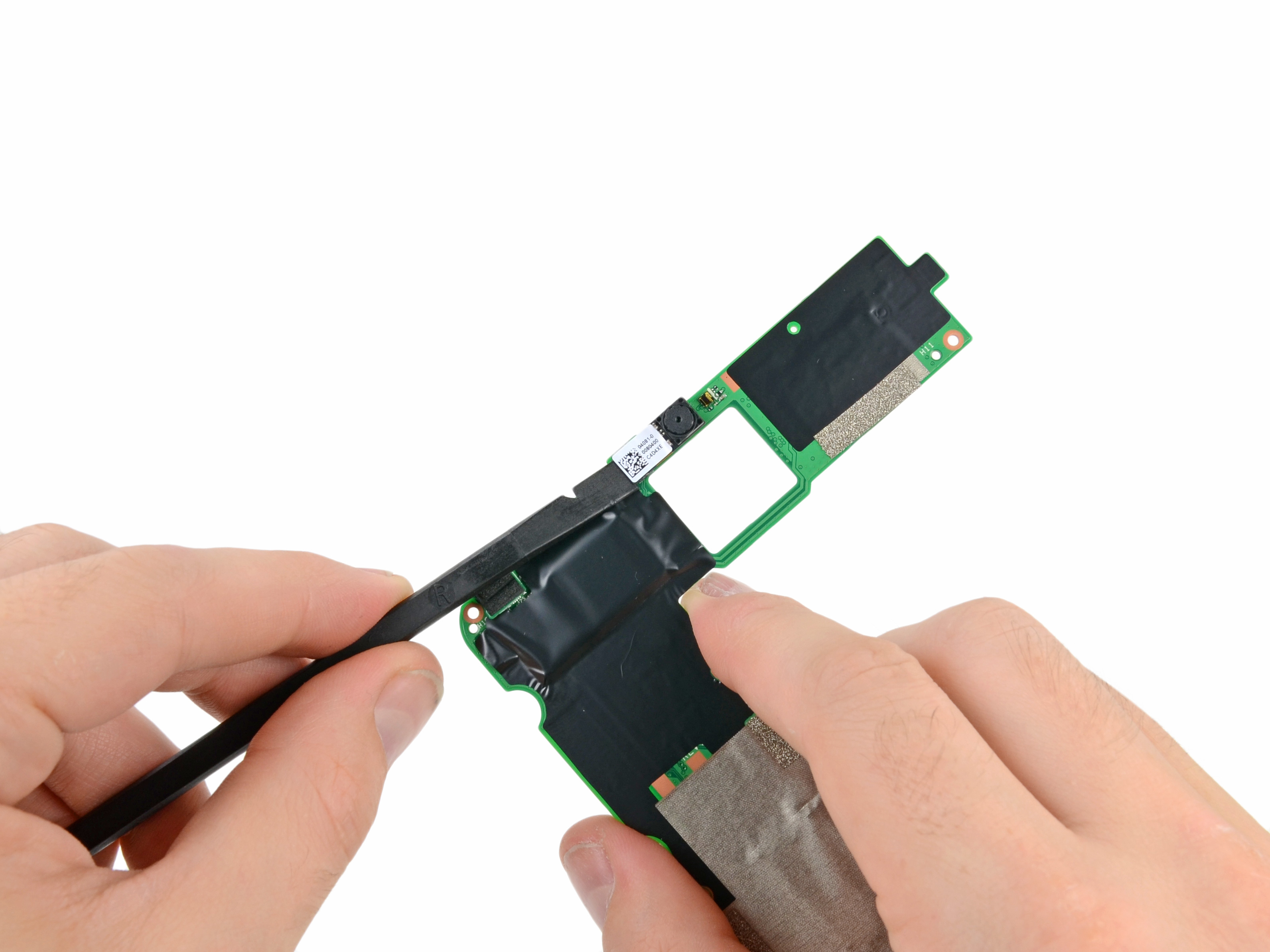

Add Note Edit Step 6 — Battery Cable  ¶
  • Using the tip of a spudger, push first on one side then the other to "walk" the battery cable straight out of its socket on the motherboard.
Image #1

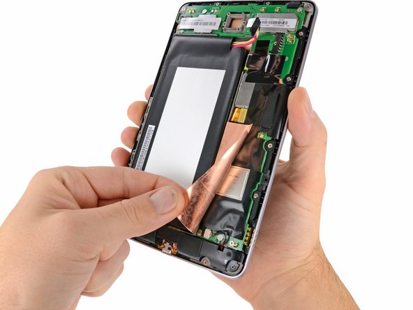

Add Note Edit Step 7 — Speaker Cable  ¶
  • Peel back the copper ESD shielding covering the bottom of the motherboard.
  • Do not try to remove the copper shielding, as it is still attached underneath the battery.
Image #1
Add Note Edit Step 8  ¶
  • Using the tip of a spudger, push the speaker cable straight out of its socket on the motherboard.
