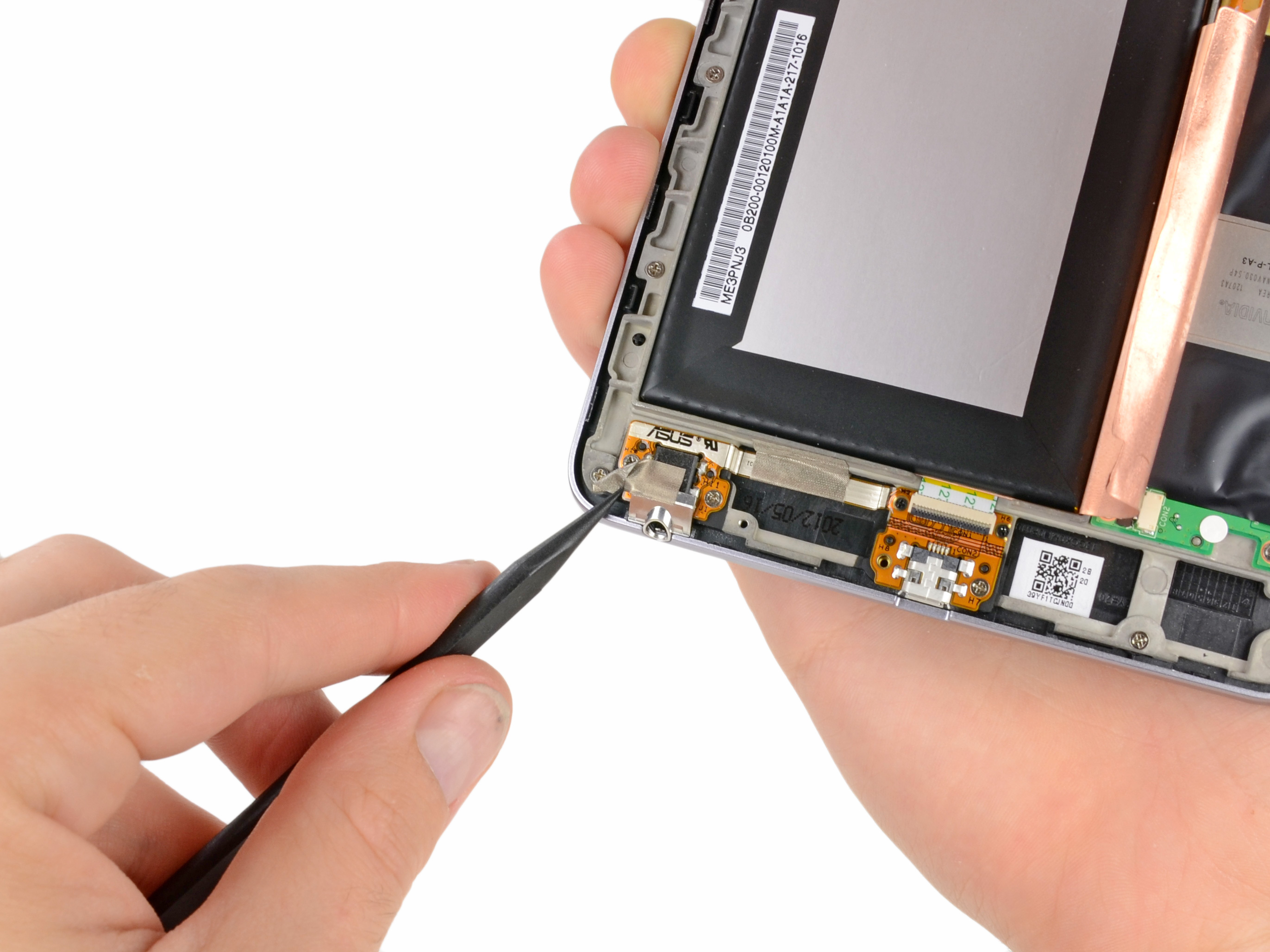

  14. Nexus 7 I/O Assembly Cable Replacement: step 14, image 1 of 1
    • Without stressing the cable, and minding any tape that may still be holding the cable in place, gently lift the headphone jack up off its placement pins.
  15. Nexus 7 I/O Assembly Cable Replacement: step 15, image 1 of 3 Nexus 7 I/O Assembly Cable Replacement: step 15, image 2 of 3 Nexus 7 I/O Assembly Cable Replacement: step 15, image 3 of 3
    • In a similar fashion, lift the micro-USB port up off its retaining pins.
    • Lift and remove the I/O assembly cable out of the Nexus 7.
