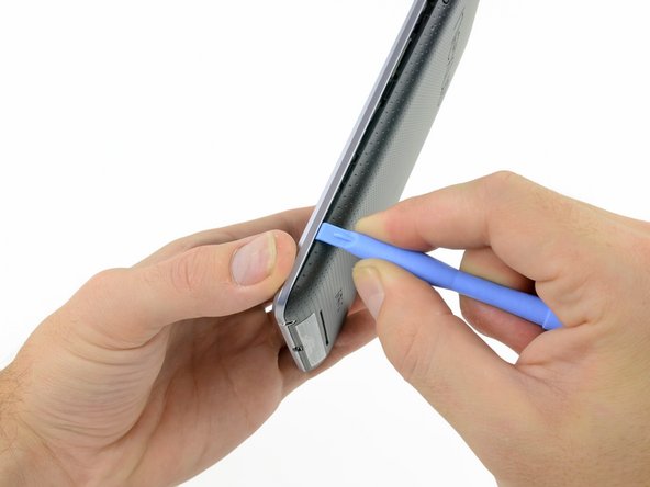

  2. Nexus 7 Battery Replacement: step 2, image 1 of 2 Nexus 7 Battery Replacement: step 2, image 2 of 2
    • Gently insert a plastic opening tool near the top of the Nexus 7 between the rear panel and the front panel assembly.
    • Carefully run the plastic opening tool along the top edge to pry the rear panel away from the front panel assembly of the Nexus 7.

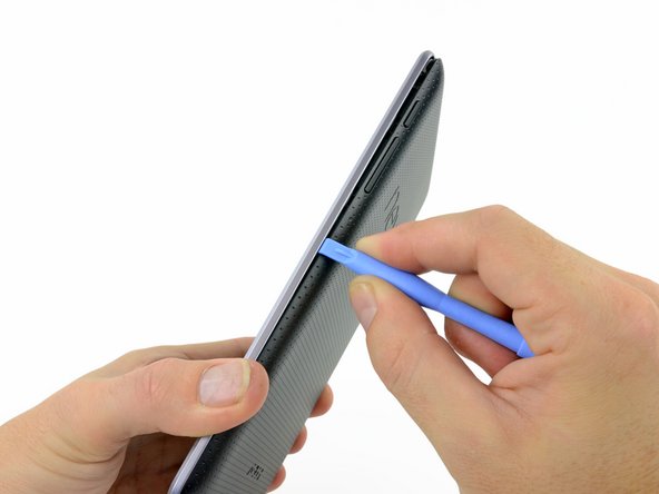

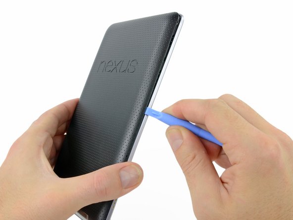

  3. Nexus 7 Battery Replacement: step 3, image 1 of 3 Nexus 7 Battery Replacement: step 3, image 2 of 3 Nexus 7 Battery Replacement: step 3, image 3 of 3
    • Insert the plastic opening tool between the rear panel and the front panel assembly near the power button and pry up at several points along the right edge of the Nexus 7.

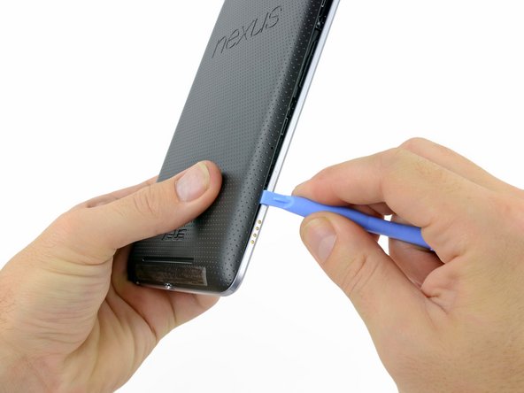

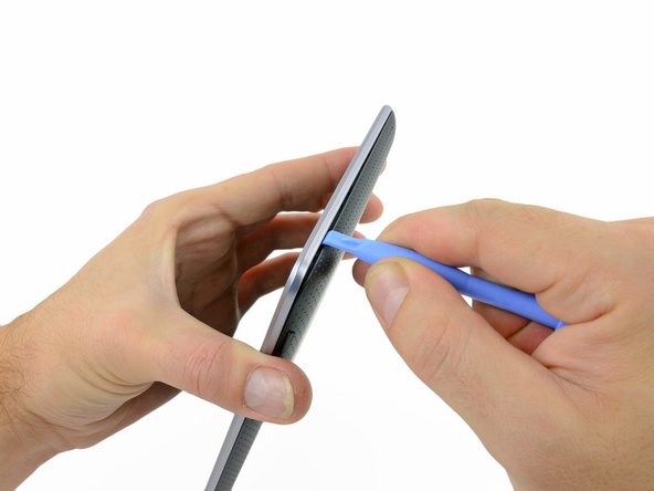

  4. Nexus 7 Battery Replacement: step 4, image 1 of 3 Nexus 7 Battery Replacement: step 4, image 2 of 3 Nexus 7 Battery Replacement: step 4, image 3 of 3
    • Pry up the rear panel along the left edge using the method described in previous steps.

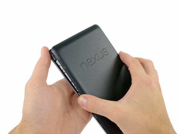

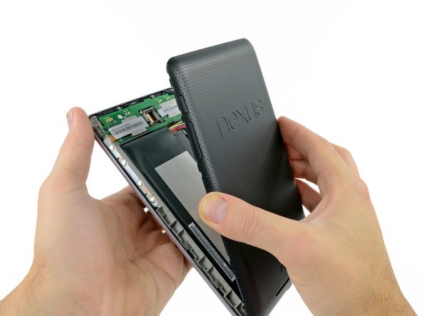

  5. Nexus 7 Battery Replacement: step 5, image 1 of 2 Nexus 7 Battery Replacement: step 5, image 2 of 2
    • Gently lift and remove the rear panel up off the front panel assembly.

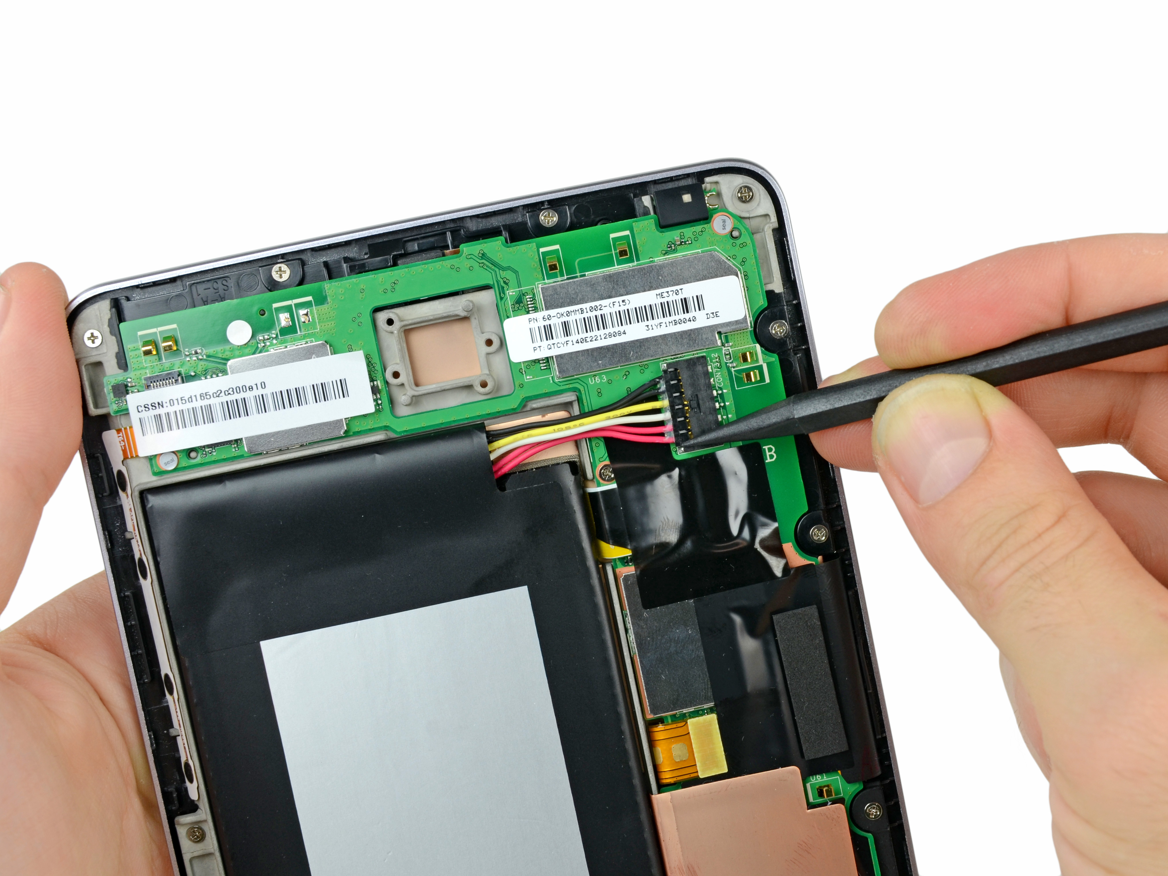

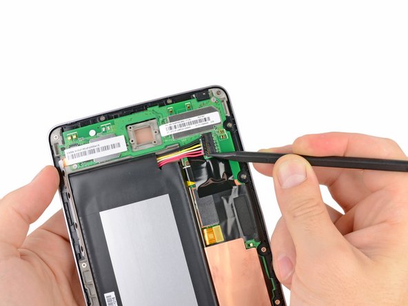

  6. Nexus 7 Battery Replacement, Battery Cable: step 6, image 1 of 2 Nexus 7 Battery Replacement, Battery Cable: step 6, image 2 of 2
    • Using the tip of a spudger, push first on one side then the other to "walk" the battery cable straight out of its socket on the motherboard.

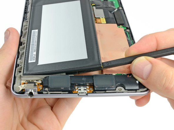

  7. Nexus 7 Battery Replacement, Battery: step 7, image 1 of 1
    • Wedge the flat end of a spudger inbetween the battery and the front panel assembly.
    • Run the flat end of a spudger along the top edge of the battery to separate it from the adhesive securing it to the front panel assembly.
    • Do not excessively bend the battery connector board. Be especially careful when prying up around the top left edge of the battery.

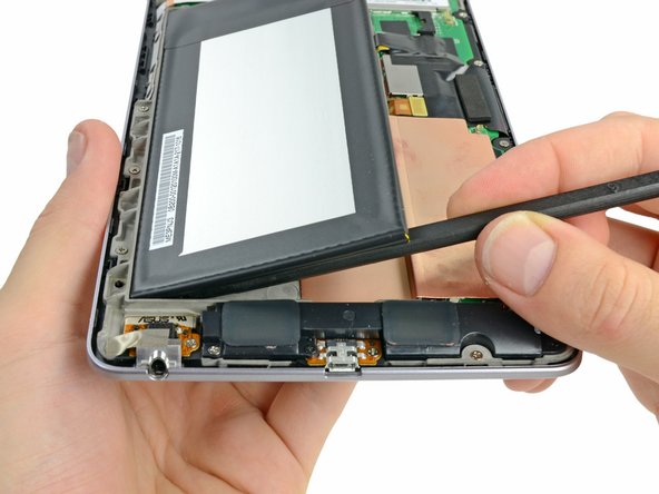

  8. Nexus 7 Battery Replacement: step 8, image 1 of 2 Nexus 7 Battery Replacement: step 8, image 2 of 2
    • Wedge the flat end of a spudger between the bottom right corner of the battery and the front panel assembly.
    • Carefully run the spudger along the bottom edge of the battery while slowly lifting the battery to completely separate it from the adhesive securing it to the front panel assembly.
