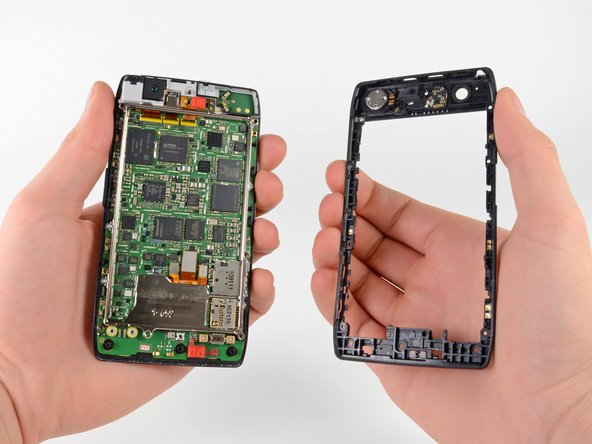

Add Note Edit Step 8 — Rear Case  ¶
  • Remove the six screws securing the rear case to the rest of the phone:
    • three 6.7 mm silver T3 Torx screws at the top,
    • four 4.0 mm gold T3 Torx screws in the middle,
    • and three 4.5 mm black T5 Torx screws at the bottom.
Image #1 Image #2 Image #3

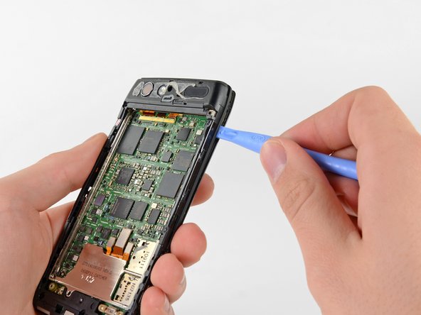

Add Note Edit Step 9  ¶
  • Insert a plastic opening tool between the rear case and the motherboard assembly.
  • Work your way down the side of the phone and gently pry the rear case up.
  • Separate the rear case from the motherboard assembly.
Image #1 Image #2

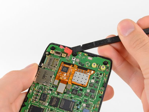

Add Note Edit Step 11  ¶
  • Use the flat end of a spudger to remove the two red silicone microphone covers at the top and bottom of the motherboard.

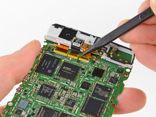

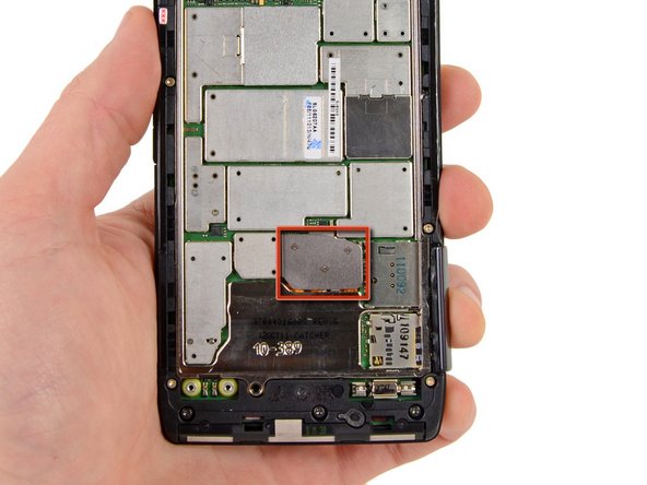

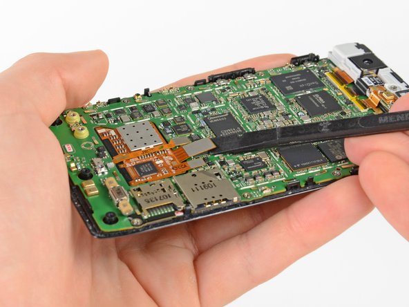

Add Note Edit Step 12  ¶
  • There is a small metal shield that covers the display assembly cable connectors on the motherboard. This shield is held in place by a few small clips that attach to the surrounding EMI shields.
  • Use the tip of a spudger to gently bend the clips out of shape and remove the shield.
Add Note Edit Step 13  ¶
  • Use the flat end of a spudger to pry the three display cable connectors off their sockets on the motherboard.
Image #1 Image #2

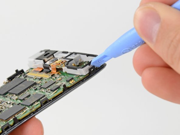

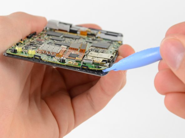

Add Note Edit Step 14  ¶

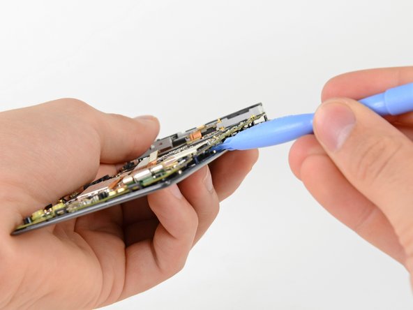

  • There are a number of small black plastic clips on the display assembly that hold the motherboard in place.
  • Release the securing clips with a plastic opening tool.

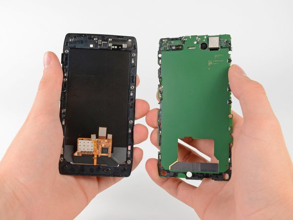

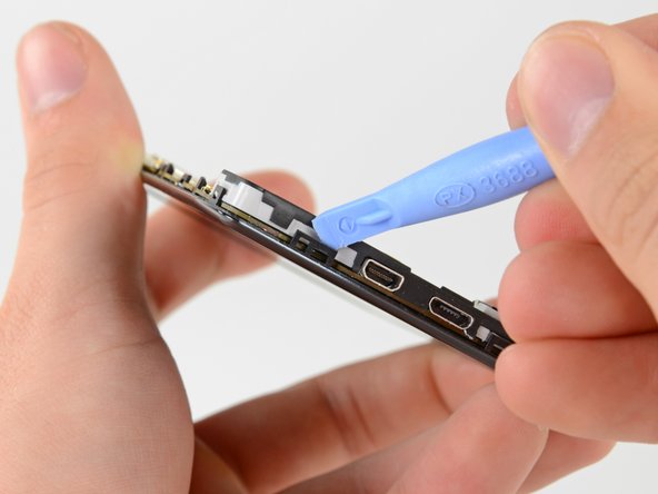

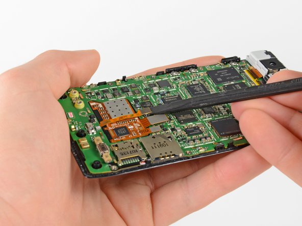

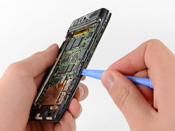

Add Note Edit Step 15  ¶
  • Pry the edges of the motherboard up from the display assembly with a plastic opening tool.
  • Remove the motherboard assembly.
Image #1 Image #2

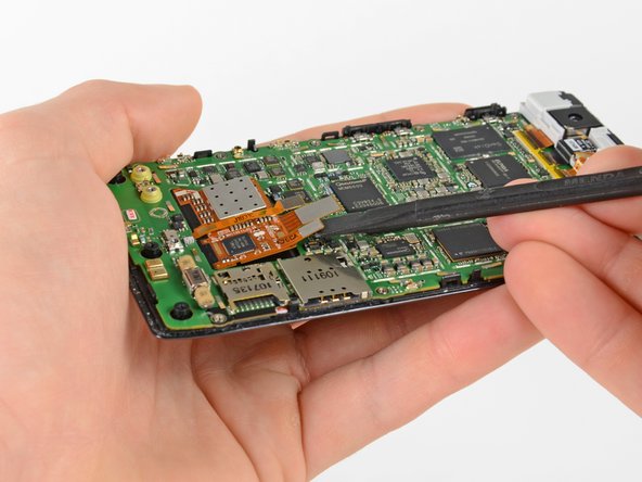

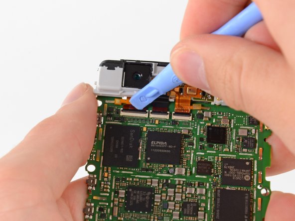

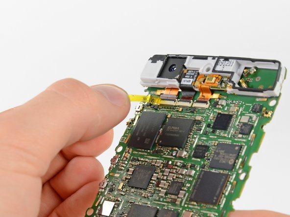

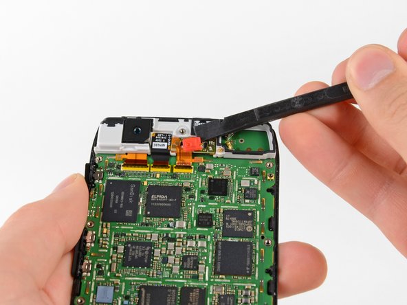

Add Note Edit Step 16 — Rear-Facing Camera  ¶
  • Lift up the anti-static tape covering the camera and earpiece ZIF connectors with the tip of a spudger.
  • Peel back the tape and remove it.
  • Unless you have spare ESD-safe tape lying around, you may consider keeping this piece somewhere safe to be reused at reassembly.
Add Note Edit Step 17  ¶
  • Use a plastic opening tool or your fingernail to lift up the tab on the rear-facing camera ribbon cable ZIF connector.
    • Make sure you're prying on the tab and not the connector itself.
  • Push the rear-facing camera through its hole in the grey antenna and remove it.

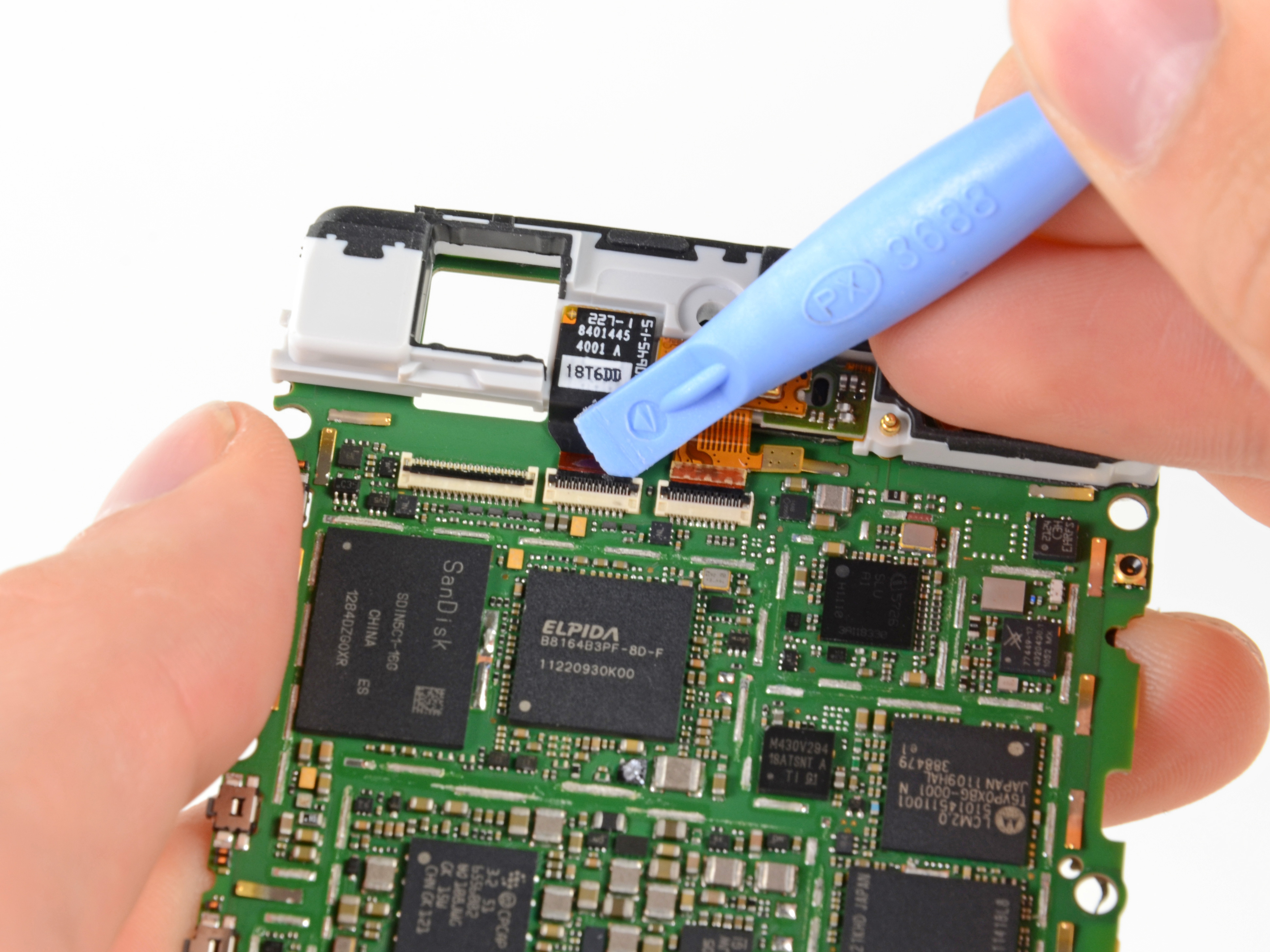

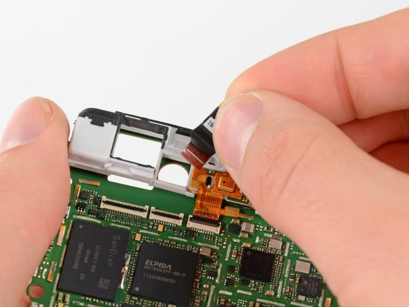

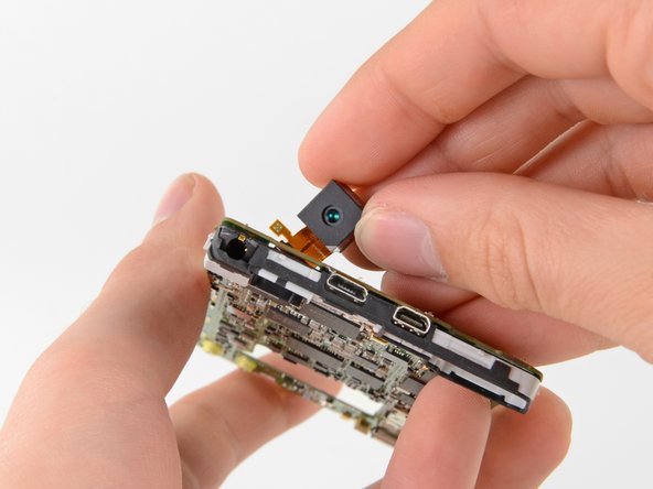

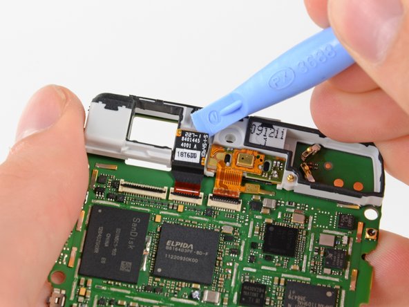

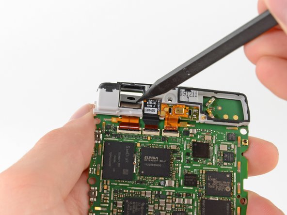

Add Note Edit Step 18 — Front-Facing Camera  ¶
  • Use a plastic opening tool or your fingernail to lift up the tab on the front-facing camera ribbon cable ZIF connector.
  • Lift the front-facing camera out of the antenna with the plastic opening tool and remove it.
