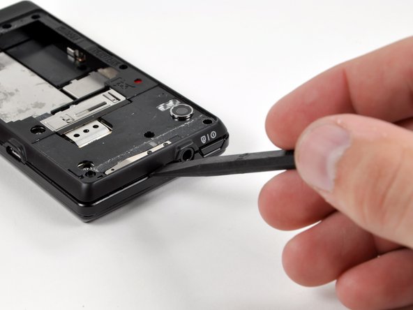

  • Gently insert a spudger between the rear case and front case at the top of the phone, near the audio jack.
  • Carefully pry the top edge of the rear case up from the rest of the phone.

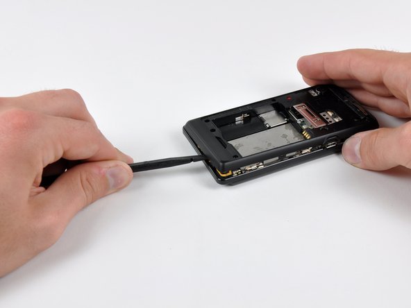

Add Note Edit Step 10  ¶
  • With the spudger still inserted between the rear case and front case, slide the spudger along the right edge of the device, moving toward the bottom, prying as you go.
  • Continue prying along the bottom edge of the device from right to left, freeing it from the front panel.
Image #1 Image #2

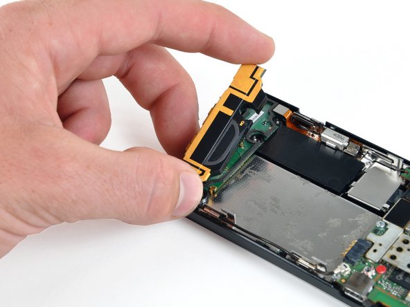

  • Carefully lift and remove the speaker assembly up out of the phone.

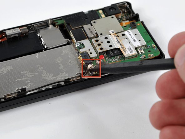

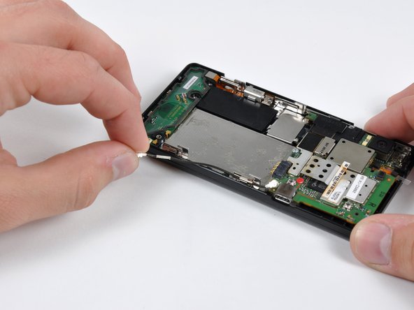

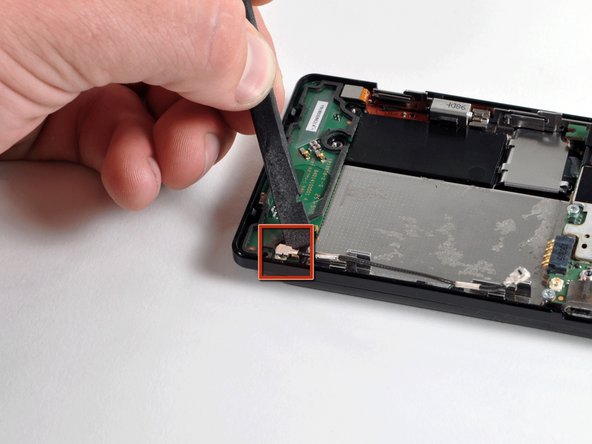

Add Note Edit Step 13 — Motherboard  ¶

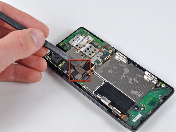

  • Use a spudger to pry the antenna cable connectors from their respective sockets on the motherboard and the speaker/antenna board.
  • De-route the antenna cable by pulling it out of the metal clips along the side of the front case.

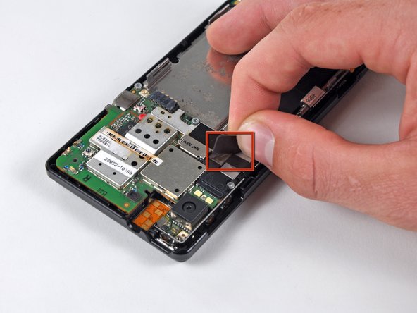

Add Note Edit Step 14  ¶
  • Peel the black tape covering the side button and display ribbon connectors on the motherboard.

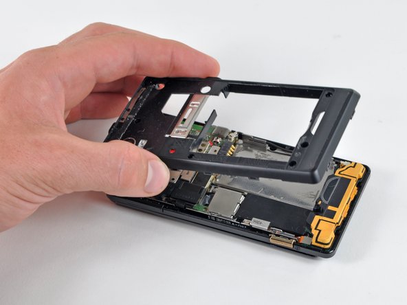

Add Note Edit Step 19 — Front Panel  ¶

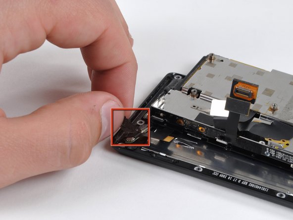

  • Disconnect the camera button/vibrator connector by prying it straight up off its socket on the speaker board with a spudger.
Image #1 Image #2
Add Note Edit Step 20  ¶

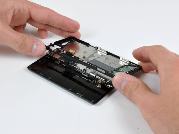

  • Slide the phone open.
  • Lift up the edge of the black plastic rim that includes the speaker board from the side closest to the keypad.
  • Continue lifting the side of the rim until it is almost vertical, and wiggle it free from the back of the LCD assembly.

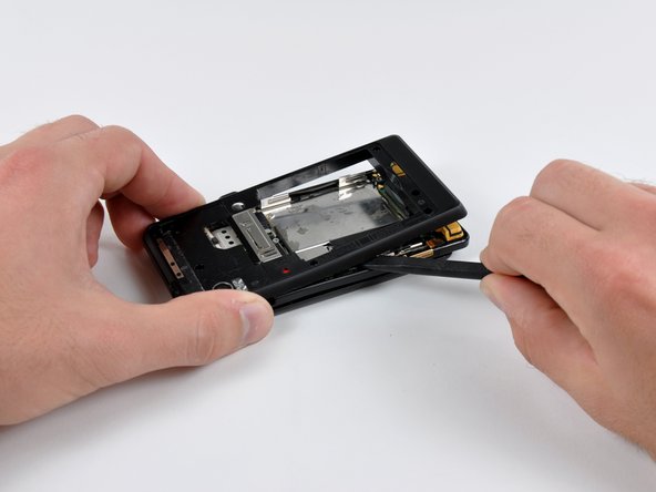

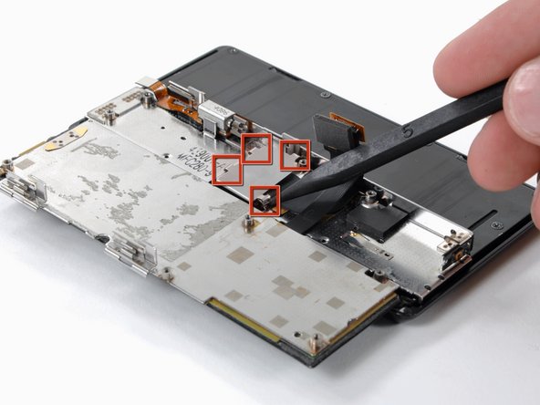

Add Note Edit Step 21  ¶
  • Remove the EMI shield by releasing the clips shown with the tip of a spudger.
Image #1

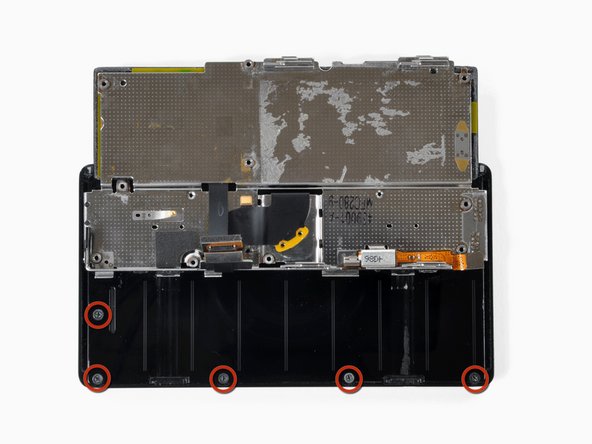

  • Remove the five 2.5 mm Phillips screws.
  • It's either a 2.5 MM Phillips or a T4 Torx. Motorola changed it on later models of the A956.

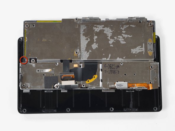

Add Note Edit Step 23  ¶
  • Slide the phone until a sixth screw is visible, as shown.
  • Remove the single 2.5 mm Phillips screw.

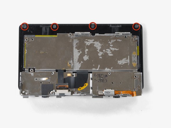

Add Note Edit Step 24  ¶
  • Continue sliding the phone in the same direction, past its "closed" position, until four more screws are revealed. You will need to lift the slider slightly to get it passed the "closed" position.
  • Remove the four 2.5 mm Phillips screws.
Image #1

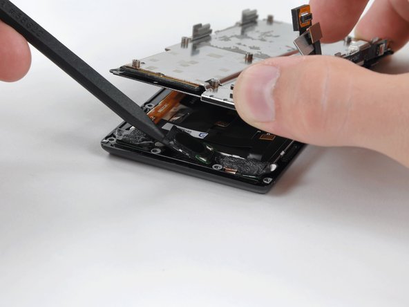

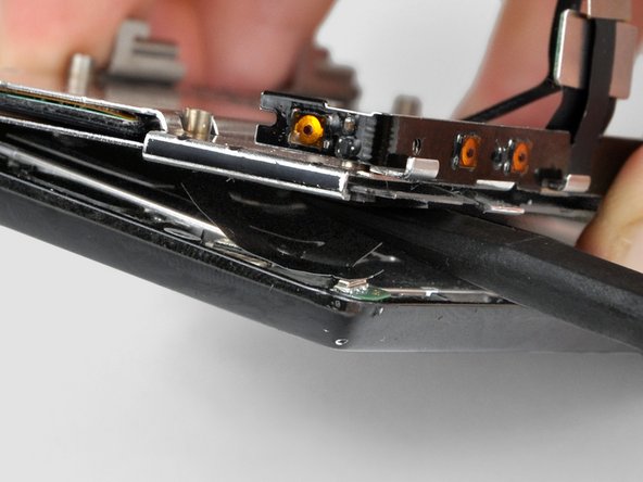

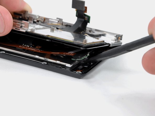

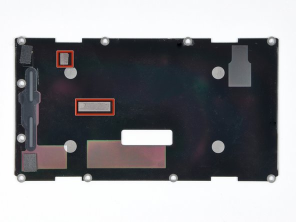

Add Note Edit Step 26  ¶
  • Insert a spudger between the back and front case of the display assembly, and peel the two ribbon cables off the two adhesive pads along the back case of the display assembly.
  • The location of the pads on the back case is shown. The top left corner of the case is the corner of the phone shown in the first picture.
Image #1

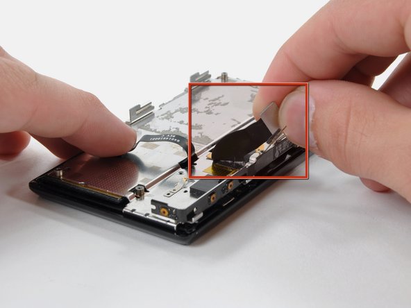

Add Note Edit Step 27  ¶
  • Use the flat end of a spudger to lift the board that contains the ambient light sensor and display data cable connector out of the screen housing.

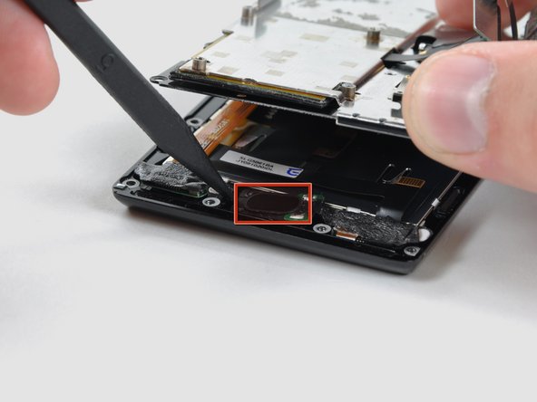

  • Use the tip of a spudger to lift the speaker out of the screen housing.

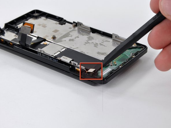

Add Note Edit Step 29  ¶
  • Peel off the black tape to reveal the front panel connector.
Image #1

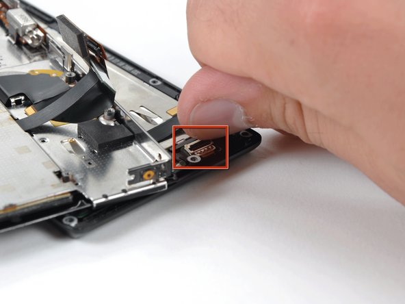

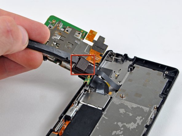

Add Note Edit Step 30  ¶
  • Use the flat end of a spudger or your fingernail to flip up the retaining flap on the front panel ribbon cable ZIF socket.
  • Disconnect the front panel ribbon cable.
Image #1

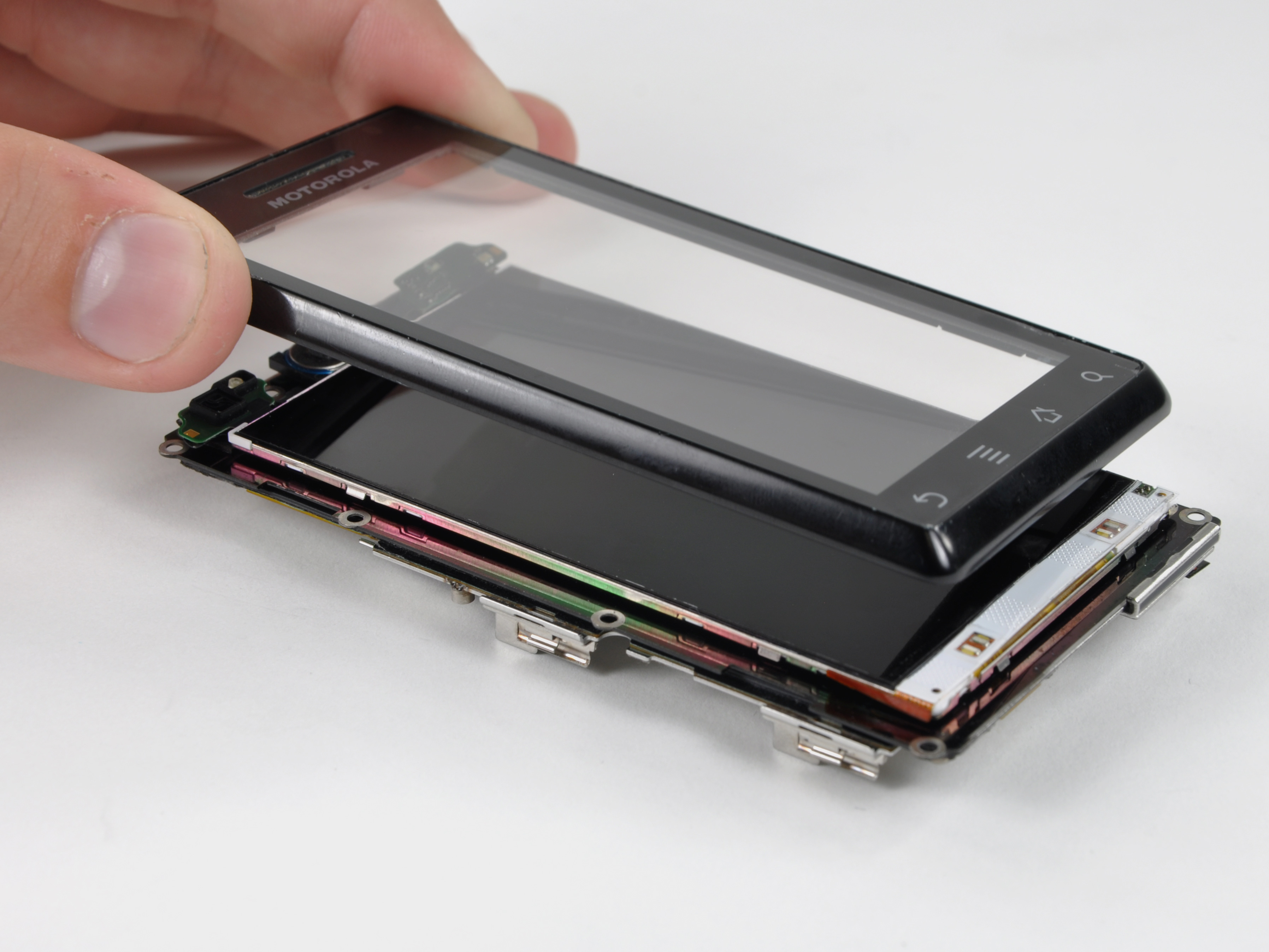

Add Note Edit Step 31  ¶
  • Flip the phone over and remove the front panel.
