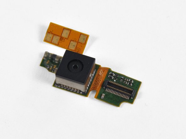

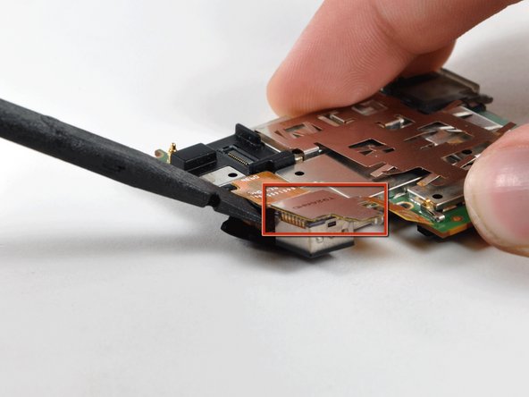

Add Note Edit Step 19 — Camera Assembly  ¶
  • Orient the motherboard so that the camera lens is face down.
  • Disconnect the camera connector from its socket by prying it straight up with a spudger.
  • Remove the camera assembly.
