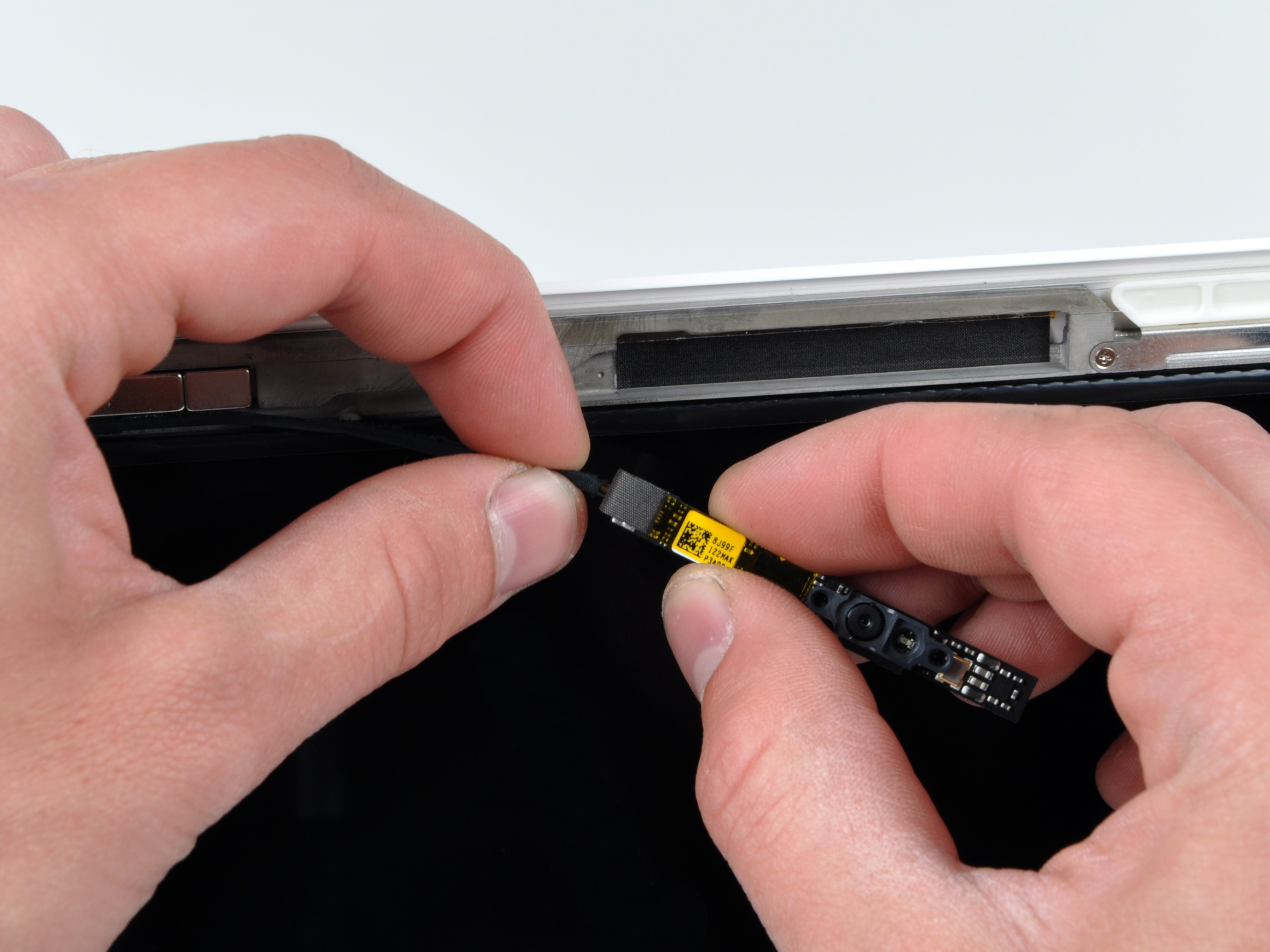

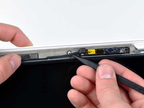

Add Note Edit Step 6 — iSight Camera Board  ¶
  • Use the pointed tip of a spudger to pry the camera board off the display assembly.
  • Disconnect the camera cable by pulling its connector away from the socket on the camera board.
