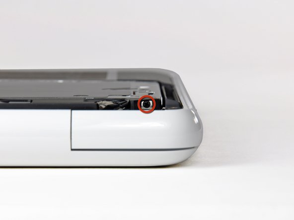

  • Remove the single 2.2 mm Phillips screw inserted horizontally into the side of the optical drive.
Image #1 Image #2

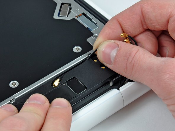

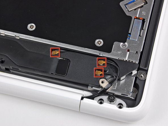

Add Note Edit Step 10  ¶
  • Pry the AirPort and Bluetooth antenna connectors (3 total) up off the AirPort/Bluetooth card.
  • De-route the long antenna from its channel in the rear speaker housing.
Image #1

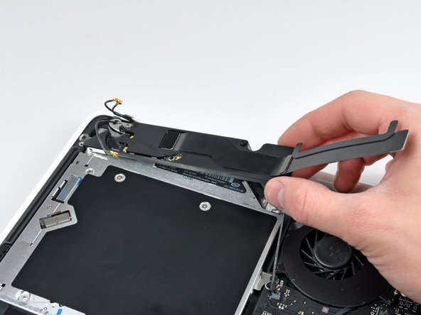

Add Note Edit Step 11  ¶

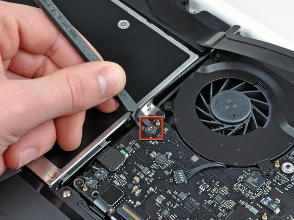

  • Use the flat end of a spudger to pry the rear speaker cable connector up off the logic board.
Image #1

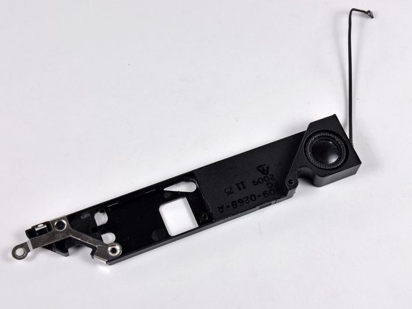

Add Note Edit Step 12  ¶
  • Remove the rear speaker assembly from the upper case.

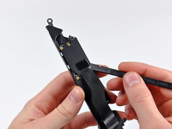

Image #1 Image #2

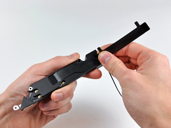

Add Note Edit Step 13  ¶
  • Carefully peel the AirPort/Bluetooth cable from its channel within the rear speaker assembly.
  • Use the flat end of a spudger to pry the AirPort/Bluetooth cable up off the rear speaker.

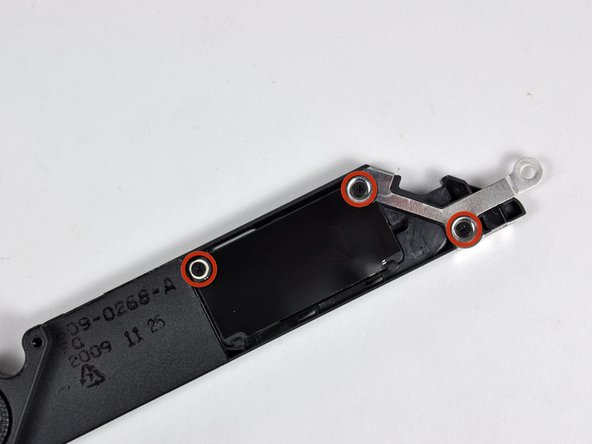

  • Remove three 3 mm Phillips screws securing the AirPort/Bluetooth board to the rear speaker assembly.

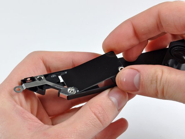

Add Note Edit Step 15  ¶
  • Lift the AirPort/Bluetooth board up off the rear speaker assembly.
