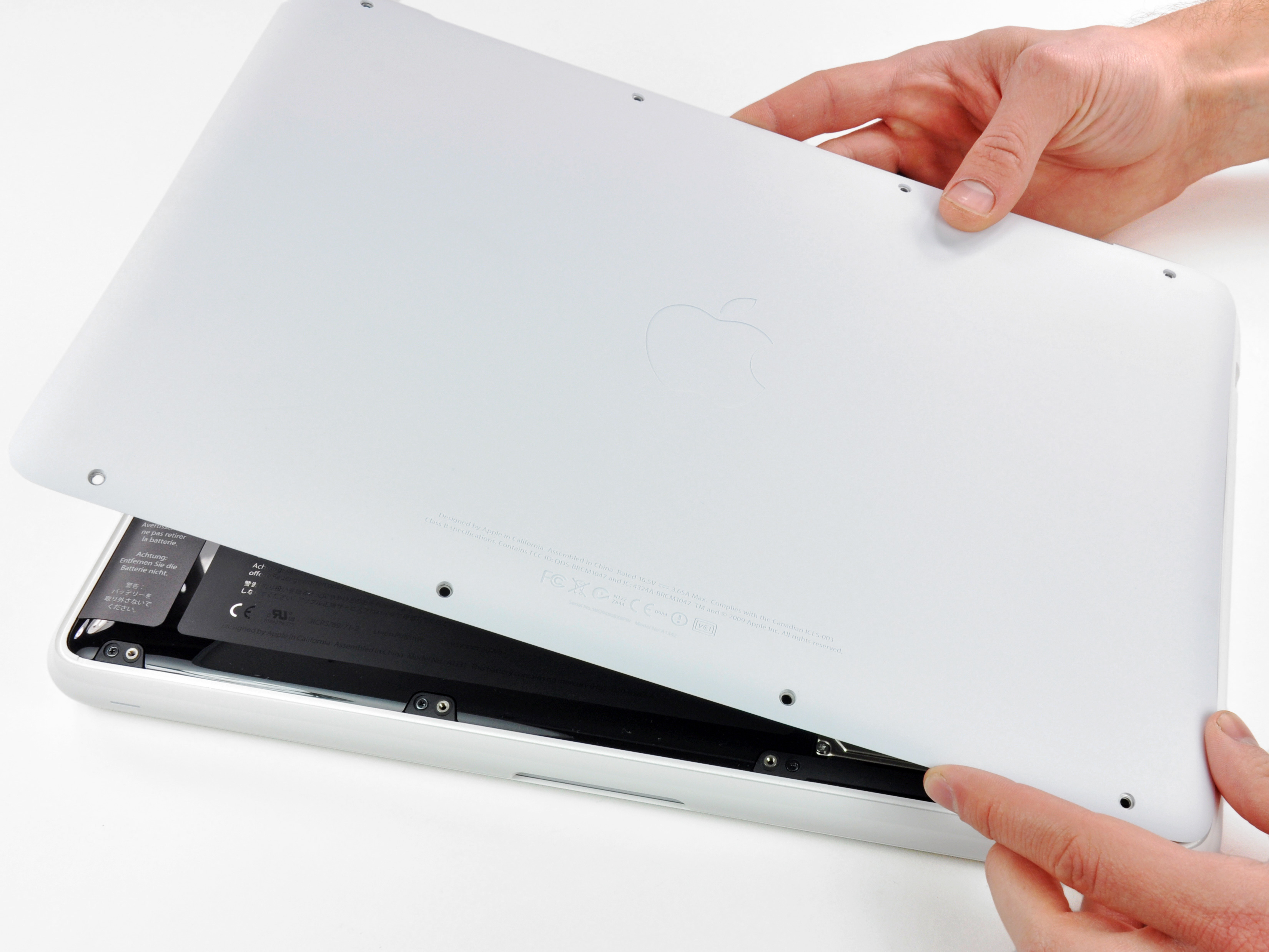

Replacing your lower case is easy! It only takes 8 screws.
Image #1
  • Remove the eight 4 mm Phillips screws securing the lower case to the MacBook.
Image #1 Image #2 Image #3
Add Note Edit Step 2  ¶
  • The lower case is constructed of rubber-coated aluminum. Do not excessively bend the aluminum during removal, as any permanent deformation will cause tolerance issues after reassembly.
  • Slightly lift the lower case near the vent opening.
  • Continue running your fingers between the lower and upper cases until the upper case pops off its retaining clips.
  • The location of these three clips is shown in the third picture.
