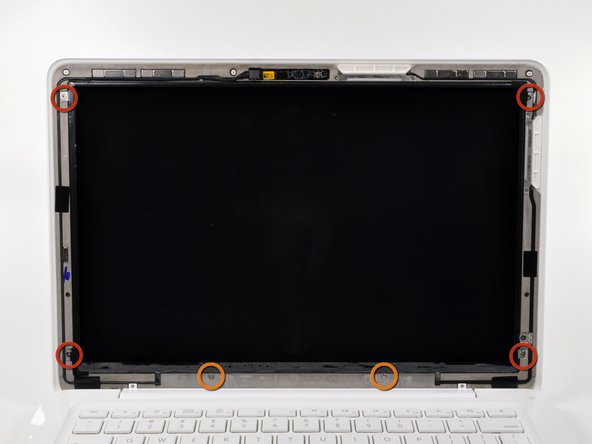

    • Remove following six screws securing the LCD to the rear display bezel:
    • Four 3.4 mm Phillips.
    • Two 3 mm Phillips.

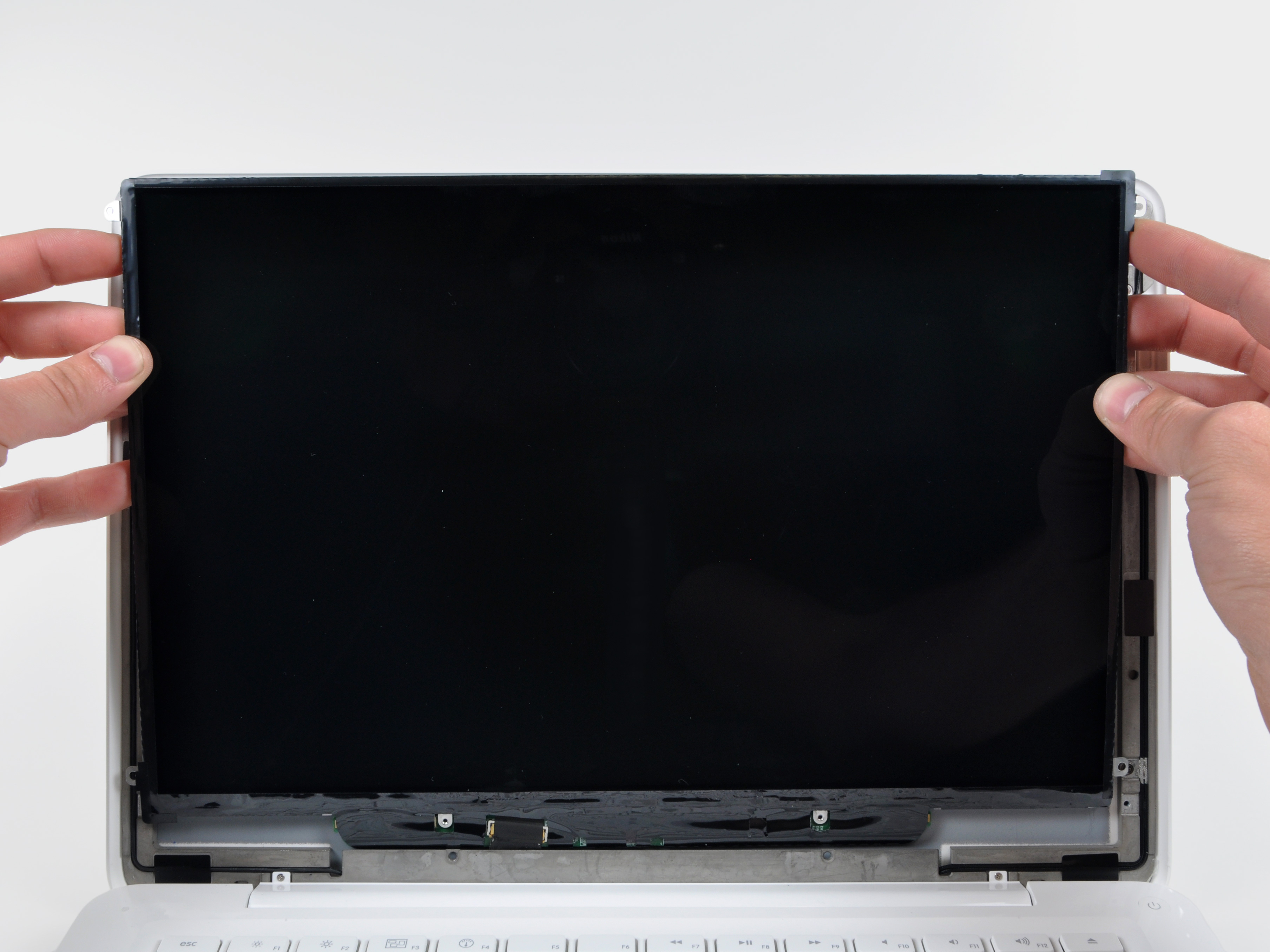

    • Do not try to remove the LCD yet. The circuitry along its lower edge is wedged in a gap along the lower edge of the display recess in the plastic display assembly.
    • Hold the display vertically and tip it enough to grab the top edge of the LCD and rotate it slightly out of the display assembly, being careful not to break the circuitry off its lower edge.

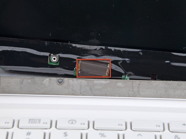

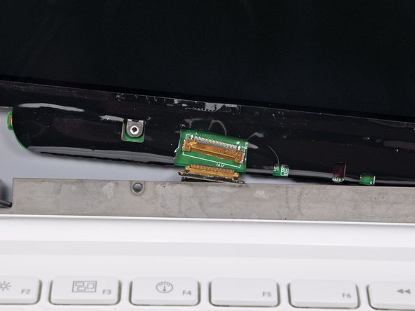

    • Peel the piece of tape covering the display data cable connector away from the edge closest to the LCD.

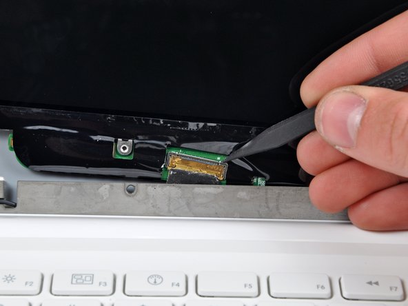

    • Use the tip of a spudger to flip up the thin steel retaining clip securing the display data cable to its socket on the LCD.
    • While holding the display data cable by the retaining clip, pull the LCD straight up and away from its socket.
    • Lift the LCD out of the display assembly and set it aside.

Thanks for this helpful guide. However, is it just me, or did you leave out the most difficult step in the whole process? How does one get the display data cable into the socket on the new lcd?
davehuff - Reply
I thought exactly the same thing: towards the end, it gets really tricky and there should be a lot more details in the repair guide. I somehow figured out myself how to do it, but i think i wouldn't have dared to do the whole thing, if i had known how difficult it would be at the end. you need a lot of patience and sensitivity to fit the cable into the little socket.
stephanieschmit - Reply

I'm done with the repair. My MacBook looks beautiful with the new Anti-Glare iFixit LCD screen I love it. Getting the display data cable into the socket wasn't that bad. I could solve it in 5 minutes. But needed 4 hands :)
Everybody should try if the screen break and iFixit guys are really really helpful!! Thank you once again!!
