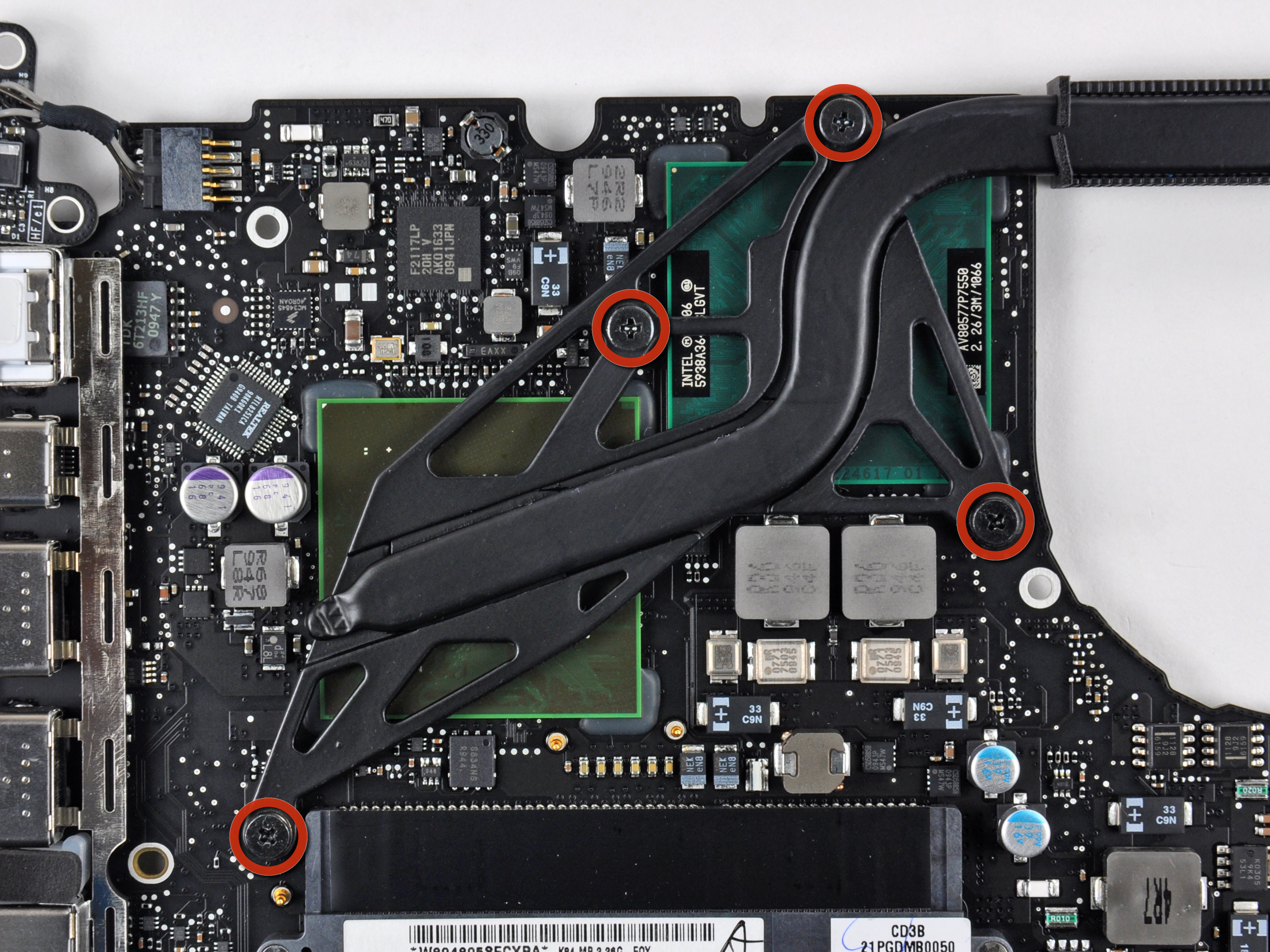

The heat sink helps keep the processor cool and happy.
Image #1
  • Remove the eight 4 mm Phillips screws securing the lower case to the MacBook.
