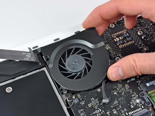

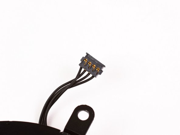

Replacing a defective fan will keep your laptop running cool.

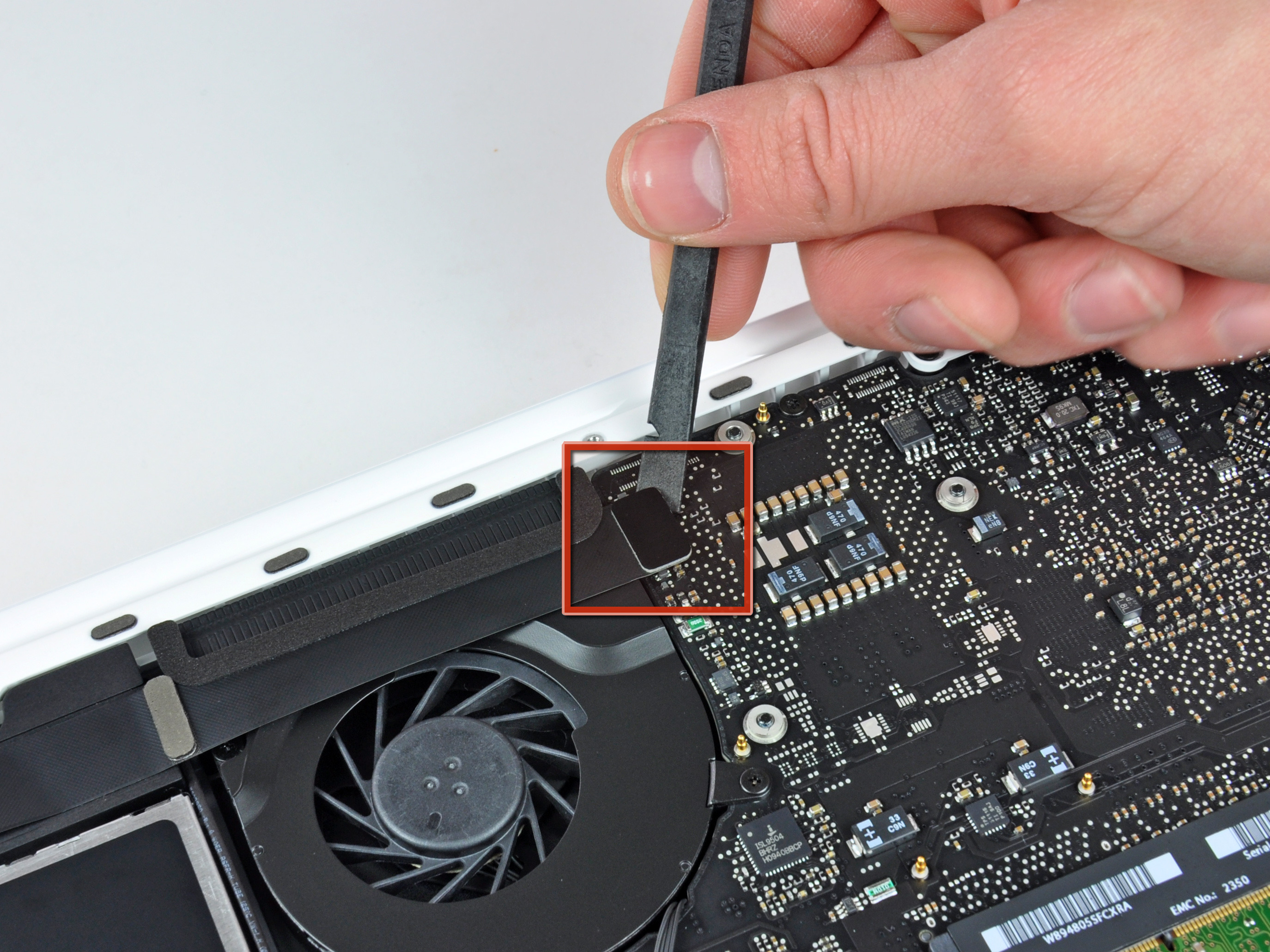

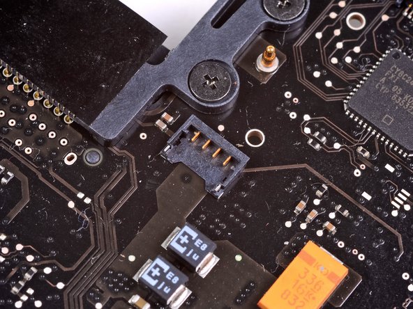

Use the flat end of a spudger to lift the battery connector up out of its socket on the logic board.
Use a spudger to pry the AirPort/Bluetooth ribbon cable connector straight up off the logic board.
Gently bend the AirPort/Bluetooth ribbon cable away from the fan.
