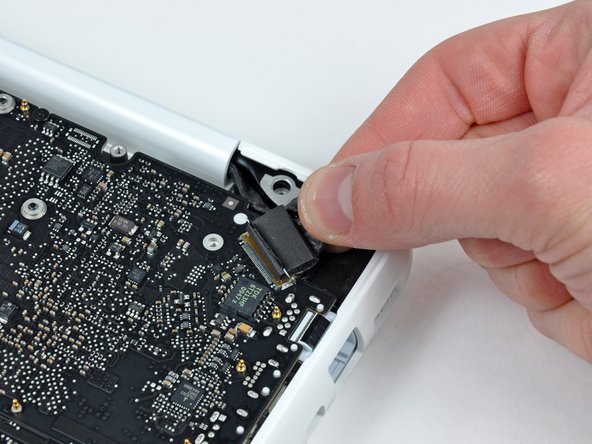

Image #1 Image #2

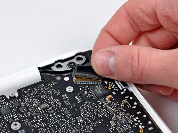

Add Note Edit Step 9  ¶
  • Grab the plastic pull tab secured to the display data cable lock and rotate it toward the DC-In side of the computer.
  • There is also a thin metal lock clip under the plastic tab that has to be released ( Use the tip of a spudger ) before you can disconnect the display data cable.
Image #1 Image #2

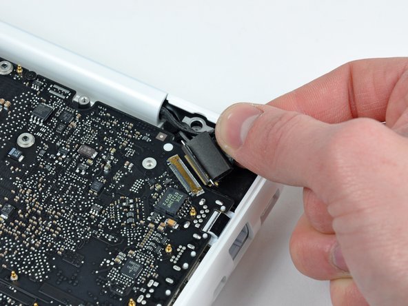

Add Note Edit Step 10  ¶
  • Gently pull the display data cable connector away from its socket on the logic board.
  • Pull the socket parallel to the face of the logic board.
  • The display data cable socket is made of very thin metal and is easily bent. Be sure to pull the connector straight away from its socket.

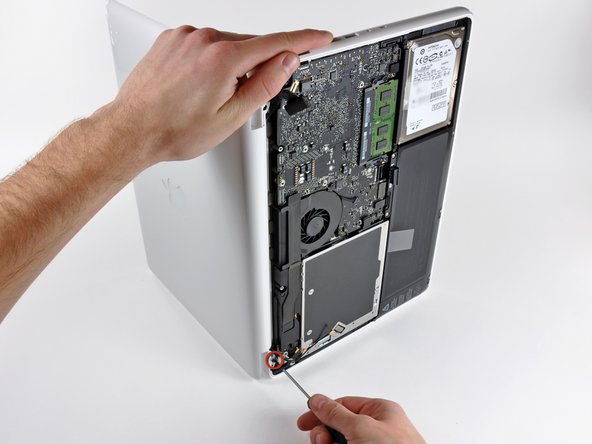

Image #1
Add Note Edit Step 11  ¶
  • Open your MacBook so the display is perpendicular to the upper case.
  • Place your opened MacBook on a table as pictured.
  • While holding the display and upper case together with your left hand, remove the remaining 7.8 mm with lock washer T8 Torx screw from the lower display bracket.
Image #1
Add Note Edit Step 12  ¶
  • Be sure to hold the display and upper case together with your left hand. Failure to do so may cause the freed display/upper case to fall, potentially damaging each component.
  • Remove the last remaining T8 Torx screw securing the display to the upper case.

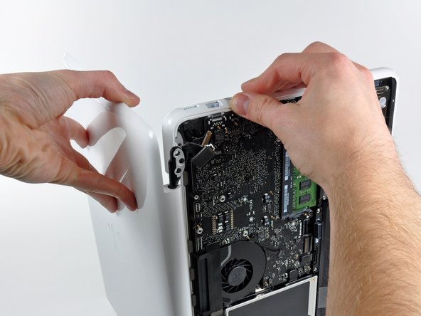

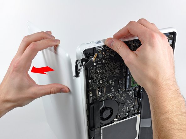

Image #1 Image #2
Add Note Edit Step 13  ¶
  • Grab the upper case with your right hand and rotate it slightly toward the top of the display so the upper display bracket clears the edge of the upper case.
  • The display data cable may cause the upper display bracket to get caught on the upper case. It may be helpful to slightly rotate the upper case away from the display for more clearance.
  • Rotate the display slightly away from the upper case.

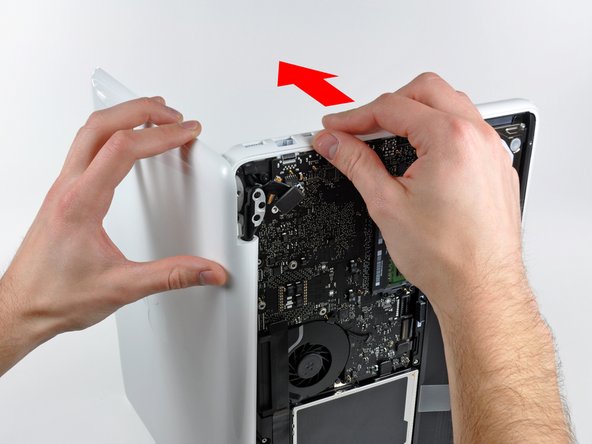

Image #1
Add Note Edit Step 14  ¶
  • Lift the display up and away from the upper case, minding any brackets or cables that may get caught.
