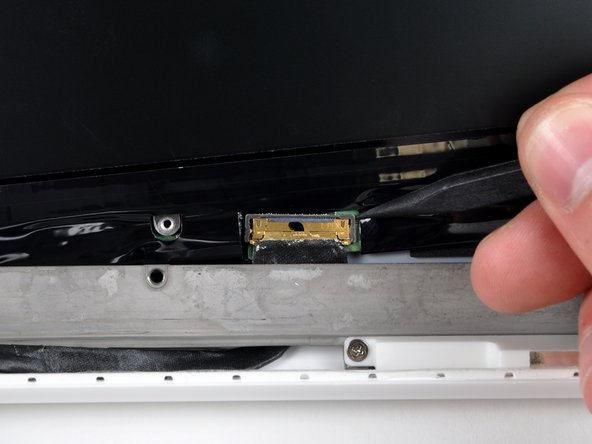

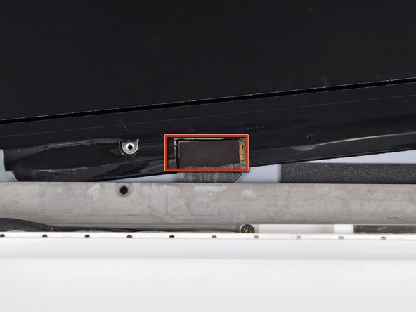

  • Peel the piece of tape covering the display data cable connector away from the edge closest to the LCD.
Image #1 Image #2
Add Note Edit Step 26  ¶

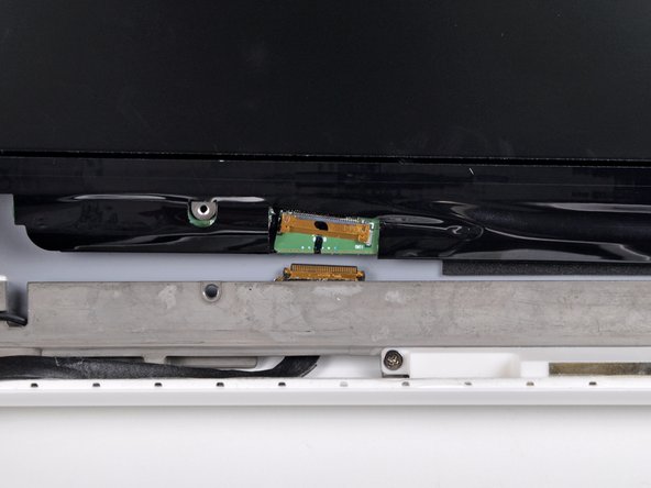

  • Use the tip of a spudger to flip up the thin steel retaining clip securing the display data cable to its socket on the LCD.
  • Pull the display data cable straight away from its socket on the LCD.
  • Lift the LCD out of the display assembly and set it aside.

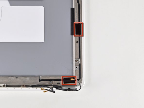

Add Note Edit Step 27 — Antenna Cables  ¶
  • Remove the two small pieces of black tape securing the antenna cables to the rear display bezel.

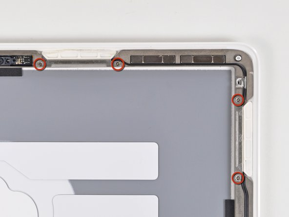

  • Remove the four 2.3 mm Phillips screws securing the two antennas to the rear display bezel.

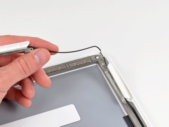

Add Note Edit Step 29  ¶

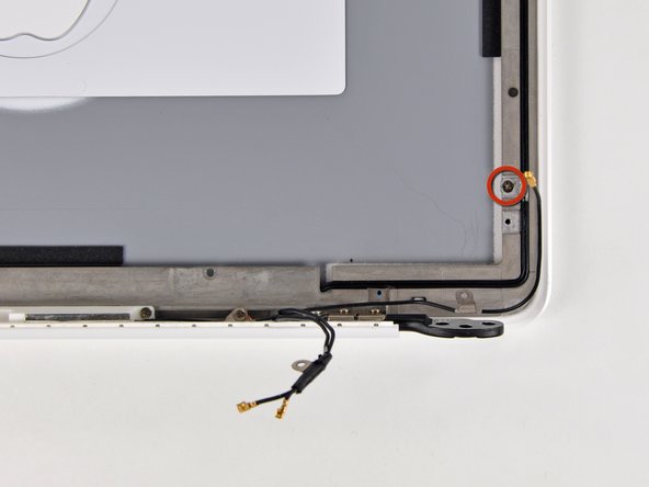

  • Remove the single 3.3 mm Phillips screw securing the lower antenna ground strap to the rear display bezel.
Image #1
Add Note Edit Step 30  ¶

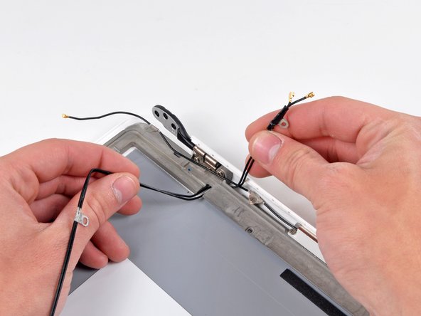

  • De-route the antenna cables from the slot cut into the rear display bezel.
Image #1
Add Note Edit Step 31  ¶
  • Carefully pull the antenna cables out from under the frame attached to the rear display bezel and remove them from the display assembly.
