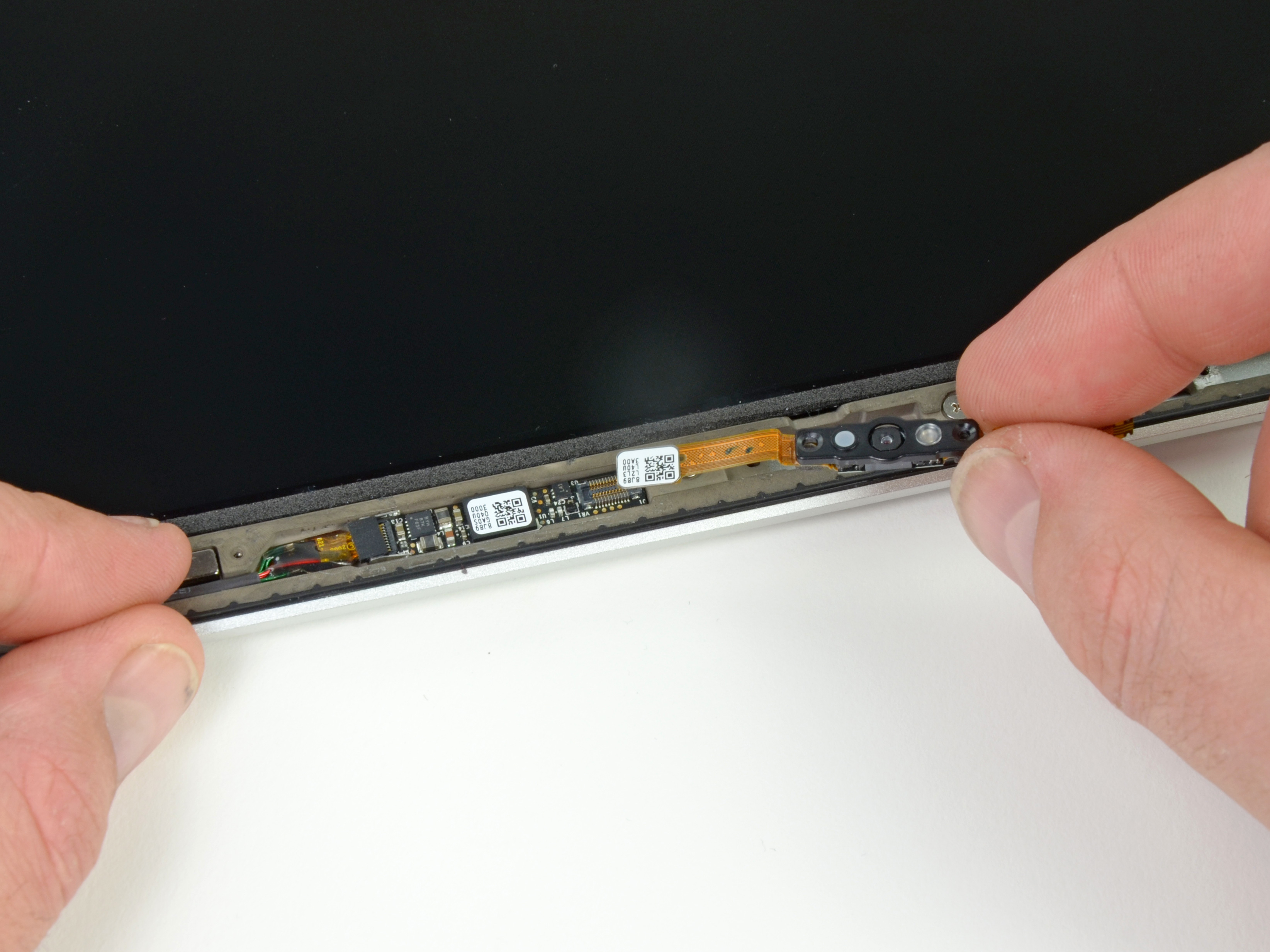

  23. MacBook Unibody Model A1278 iSight Camera Replacement: step 23, image 1 of 2 MacBook Unibody Model A1278 iSight Camera Replacement: step 23, image 2 of 2
    • Insert the edge of a plastic opening tool between the display glass and the camera bracket, and run it around the camera bracket to separate it from the display glass.
    • Do not forget to stick the camera bracket down to the new front display glass before reassembly.

  29. MacBook Unibody Model A1278 iSight Camera Replacement, iSight Camera: step 29, image 1 of 2 MacBook Unibody Model A1278 iSight Camera Replacement, iSight Camera: step 29, image 2 of 2
    • Use the flat end of a spudger to pry the iSight cable connector off its socket on the camera board.
    • Lift and remove the iSight camera out from the display assembly.
