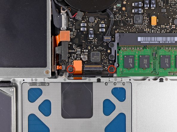

Add Note Edit Step 6 — Mid Wall  ¶
  • Remove the four 10.3 mm Phillips screws securing the mid wall to the upper case.
Image #1

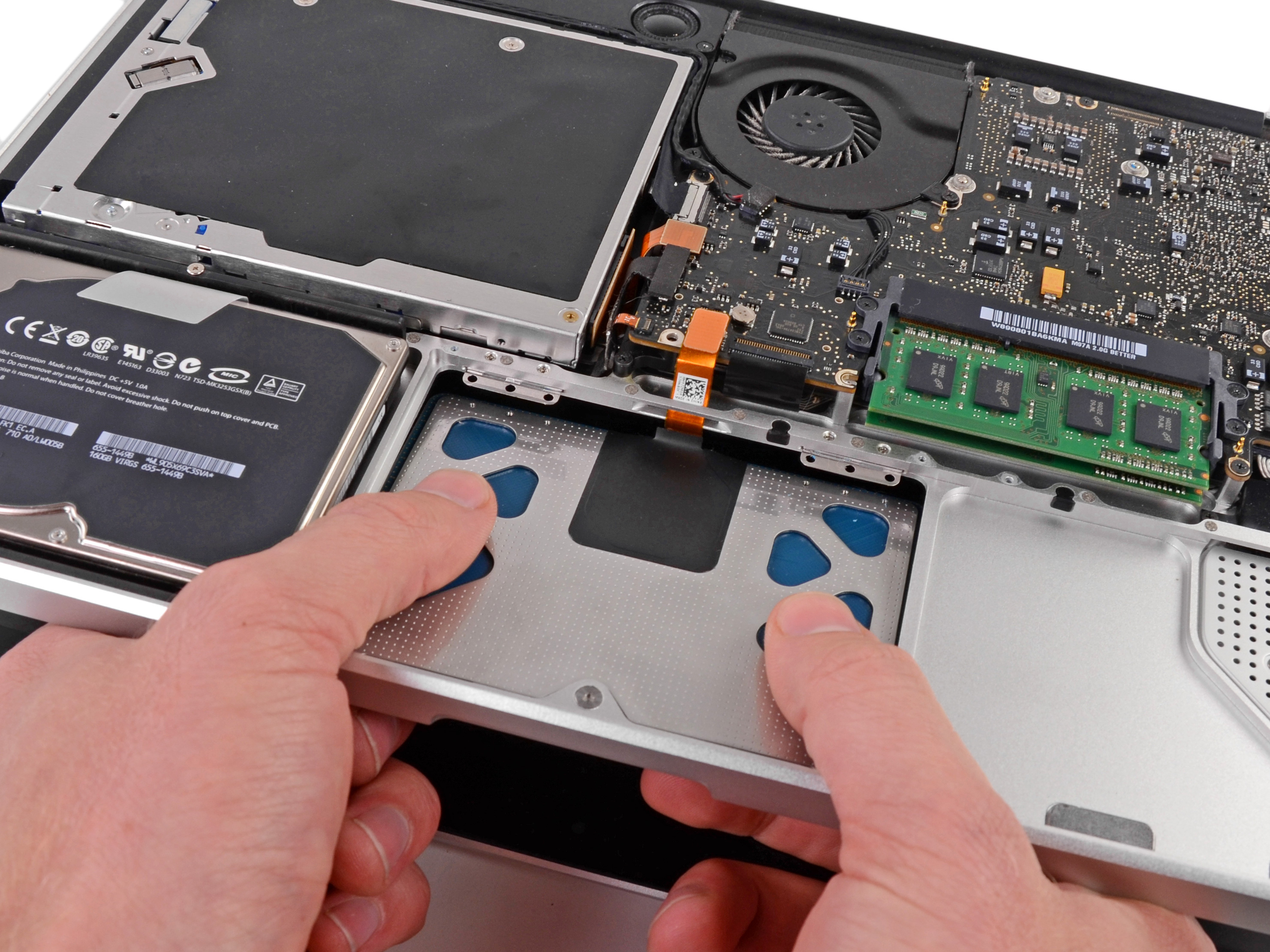

Add Note Edit Step 7  ¶
  • Lift the mid wall out of the upper case.
Image #1 Image #2
Add Note Edit Step 8 — Trackpad  ¶
  • Remove the two 5 mm Phillips screws securing the keyboard flex bracket to the upper case.
  • Lift the keyboard flex bracket out of the upper case.
