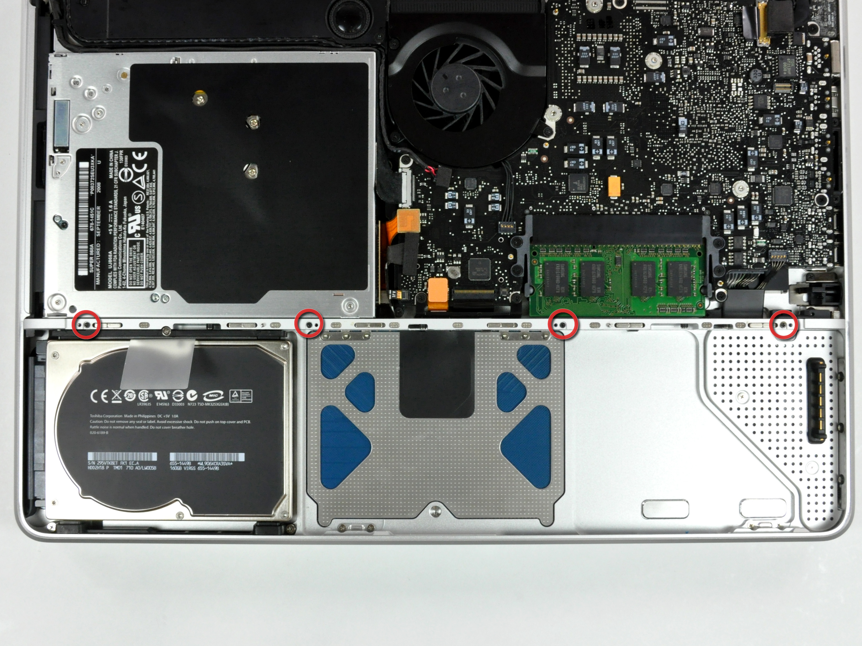

This guide will show you how to replace the Mid Wall on from your laptop.
Sections
Image #1
Add Note Edit Step 1 — Access Door  ¶
  • With the case closed, place the Unibody top-side down on a flat surface.
  • Depress the grooved side of the access door release latch enough to grab the free end. Lift the release latch until it is vertical.
Image #1
Add Note Edit Step 2  ¶
  • The access door should now be raised enough to lift it up and out of the Unibody.
Image #1
  • Be sure the access door release latch is vertical before proceeding.
  • Grab the white plastic tab and pull the battery up and out of the Unibody.
Image #1
Add Note Edit Step 4 — Lower Case  ¶
  • Remove the following eight screws securing the lower case to the chassis:
    • One 3 mm Phillips screw.
    • Four 3.5 mm Phillips screws.
Image #1
Add Note Edit Step 5  ¶
  • Using both hands, lift and remove the lower case off the upper case.
Image #1
Add Note Edit Step 6 — Mid Wall  ¶
  • Remove the four 10.3 mm Phillips screws securing the mid wall to the upper case.
Image #1
Add Note Edit Step 7  ¶
  • Lift the mid wall out of the upper case.
