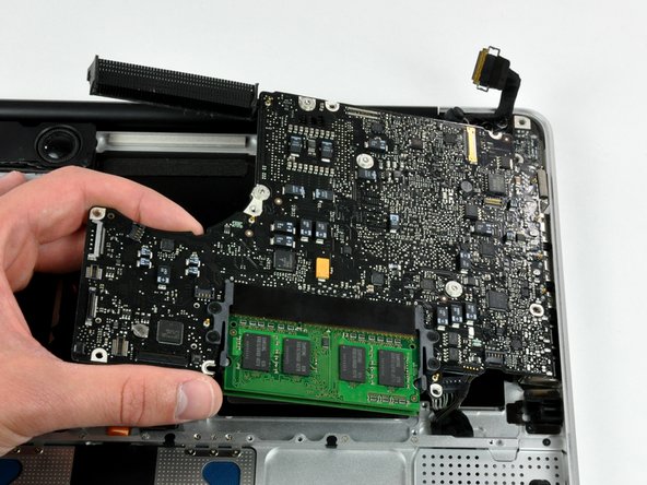

Add Note Edit Step 27  ¶
  • Remove the following five screws securing the logic board to the upper case:
    • Four 3mm Phillips screws.
    • One 3.5mm Phillips screw.
  • Lift the logic board from its left edge and pull it out of the upper case.

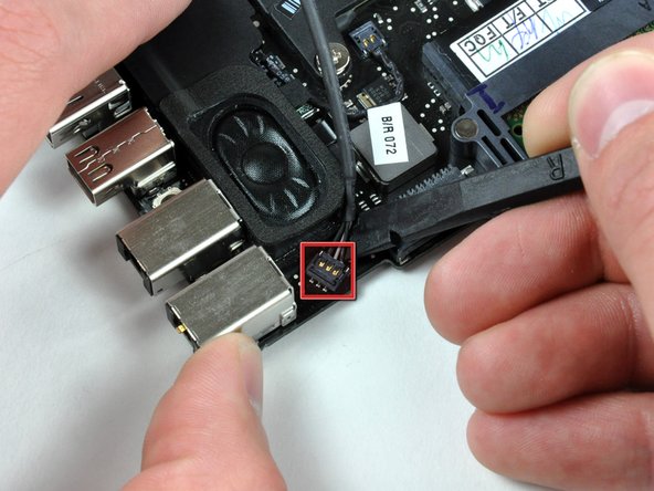

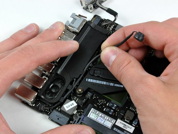

Add Note Edit Step 28 — Microphone  ¶
  • Deroute the microphone cable from the channel in the left speaker.
Image #1
Add Note Edit Step 29  ¶
  • Use the flat end of a spudger to pry the microphone cable connector up off the logic board.
