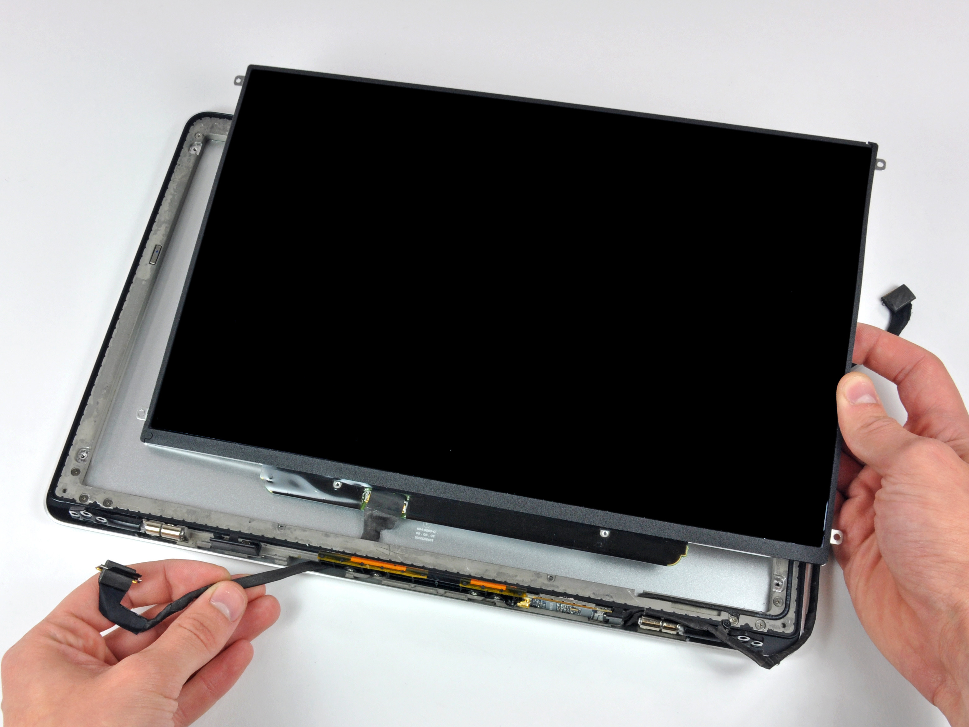

  27. MacBook Unibody Model A1278 LCD Panel Replacement, LCD Panel: step 27, image 1 of 1
    • De-route the display data cable from its retaining bracket near the lower left edge of the display.
  28. MacBook Unibody Model A1278 LCD Panel Replacement: step 28, image 1 of 1
    • Remove the following six screws securing the LCD panel to the front bezel:
    • Four 3.25 mm Phillips with large heads.
    • Two 3.2 mm Phillips with small heads.
  29. MacBook Unibody Model A1278 LCD Panel Replacement: step 29, image 1 of 1
    • Do not try to remove the LCD yet. The circuitry along its lower edge is wedged in a gap along the lower edge of the display recess in the aluminum display assembly.
    • Hold the display vertically and tip it enough to grab the top edge of the LCD and rotate it slightly out of the display assembly, being careful not to break the circuitry off its lower edge.
    • Pull the LCD toward the top edge of the display to slide the circuitry along its lower edge out of the recess in the aluminum display assembly.
    • It may be helpful to use one hand to feed the display data cable through its channel in the aluminum display assembly as you pull the LCD toward the top edge of the display with the other hand.
  30. MacBook Unibody Model A1278 LCD Panel Replacement: step 30, image 1 of 1
  31. MacBook Unibody Model A1278 LCD Panel Replacement: step 31, image 1 of 1
    • Peel the piece of tape covering the display data cable connector away from the edge closest to the LCD.
  32. MacBook Unibody Model A1278 LCD Panel Replacement: step 32, image 1 of 2 MacBook Unibody Model A1278 LCD Panel Replacement: step 32, image 2 of 2
    • Use the tip of a spudger to flip up the thin steel retaining clip securing the display data cable to its socket on the LCD.
    • Pull the display data cable straight away from its socket on the LCD.
    • Lift the LCD out of the display assembly and set it aside.

There are other guides for replacing the LCD on the 13" Macbook unibody without removing the whole display assembly. I tried this and had some problems when it came to reconnecting the new LCD to the LVDS. The main problem with this is that the LVDS connector cable is very short and therefore there is not a lot of room for plugging it into the LCD. After a while I decided to follow the ifixit guide and remove the display assembly. This made things very easy since I could push the LVDS cable back a little which gave me enough room for reconnecting the LVDS easily.
borise - Reply
Removing the glass front was difficult at first. I used a cheap suction cup (not from ifixit) but the glass didn't come off at all. At some point the suction cup broke, the rubber just came off. So I used a hair dryer and a credit card to get into the lower right corner. I started by placing the credit card in the small opening between the edge of the glass and the rubber lip (at right angle). Then I carefully and patiently dug into the corner, and as soon I was in I could carefully detach the glass from its adhesive (frequently using the hairdryer). Maybe I was just lucky, but for me this worked fine.
The rest was pretty easy (except reconnecting the LVDS which was a pain at first; see my other comment). I used permanent double sided tape to put the glass back on, which seems to work just fine.
borise - Reply
Ok I tried to remove the front glass with a hair dryer with no success. The back case became so hot I can't even hold it to pull this the suction cup...
So I borrowed a heat gun and it was very easy to remove. I was surprised. I heated until I saw steam inside the panel through the glass. I then pulled hard on one corner ands it came. After that the all glass came easily without reheating.
After the LCD panel exchange I manage to have no dust or finger tips inside and put the glass back on its old tape glu. And shazam !
The MacBook now work great again.
Thank you ifixit.
Ben Souverbie - Reply
