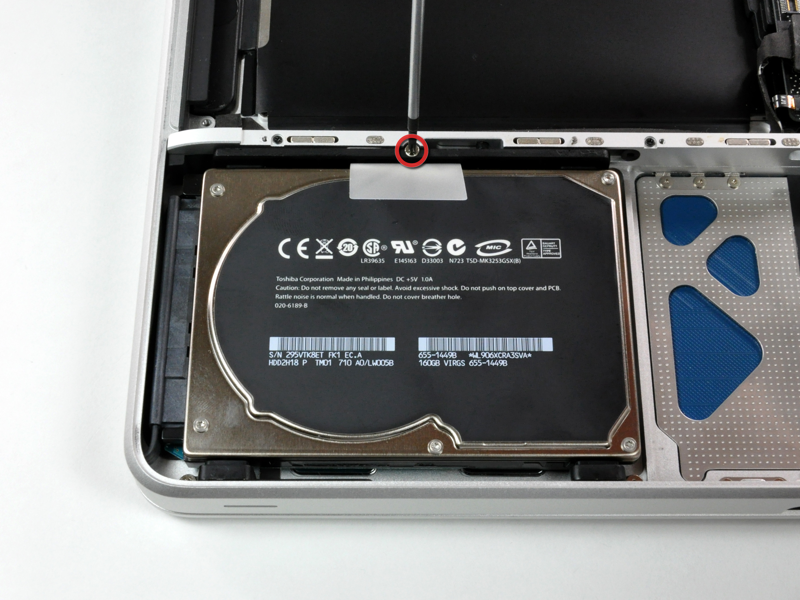

  14. MacBook Unibody Model A1278 Hard Drive Cable Replacement, Hard Drive Cable: step 14, image 1 of 1
    • Remove the single Phillips screw securing the hard drive bracket to the upper case.
    • This screw is captive in the hard drive bracket.
  15. MacBook Unibody Model A1278 Hard Drive Cable Replacement: step 15, image 1 of 1
    • Lift the hard drive by its plastic pull tab and remove the freed hard drive bracket.
