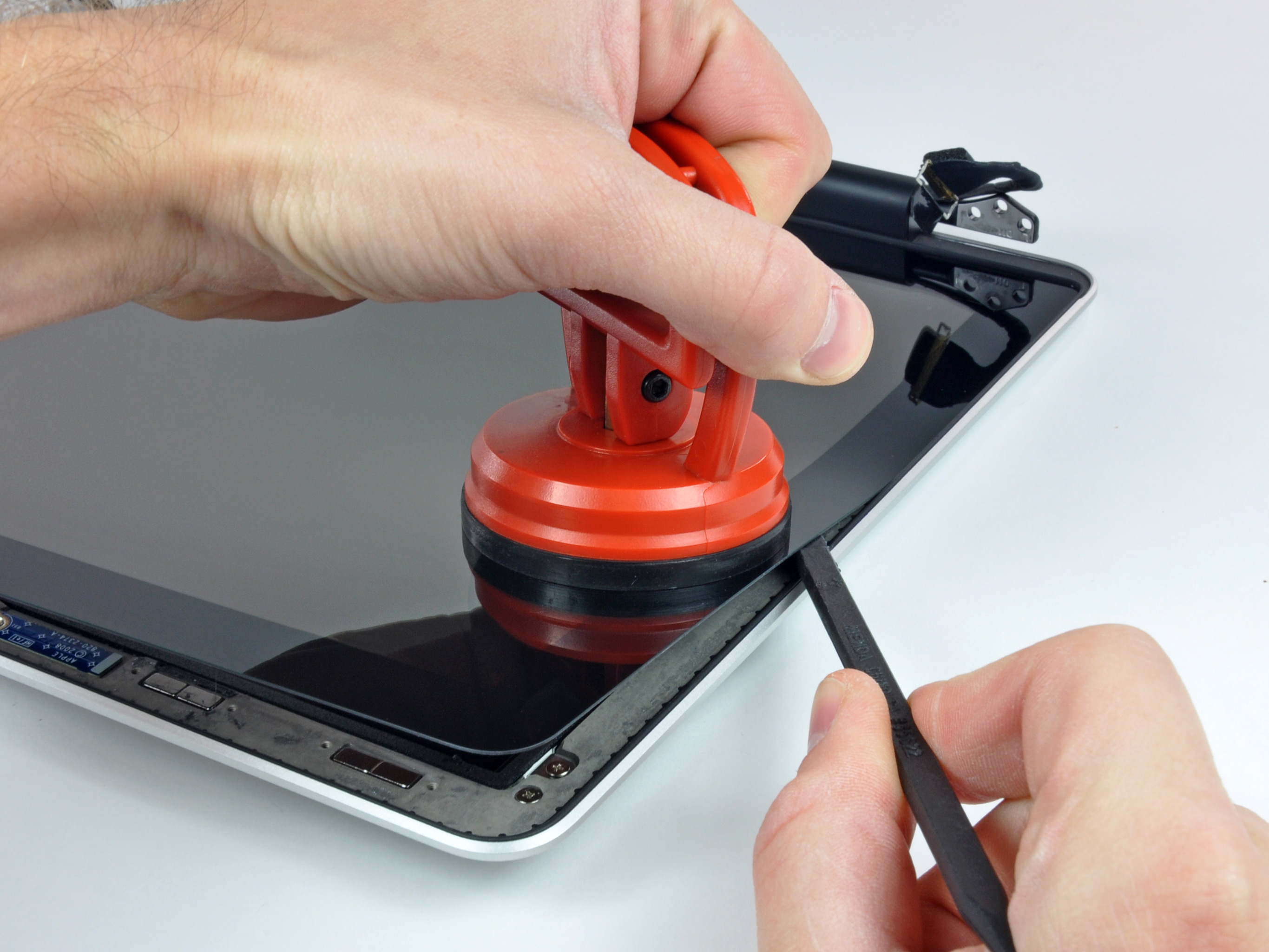

Use this guide to replace a broken front display glass panel. The display glass must be removed to access the LCD.
Image #1
Add Note Edit Step 1 — Access Door  ¶
  • With the case closed, place the Unibody top-side down on a flat surface.
  • Depress the grooved side of the access door release latch enough to grab the free end. Lift the release latch until it is vertical.
Image #1
Add Note Edit Step 2  ¶
  • The access door should now be raised enough to lift it up and out of the Unibody.
Image #1
  • Be sure the access door release latch is vertical before proceeding.
  • Grab the white plastic tab and pull the battery up and out of the Unibody.
Image #1
Add Note Edit Step 4 — Lower Case  ¶
  • Remove the following eight screws securing the lower case to the chassis:
    • One 3 mm Phillips screw.
    • Four 3.5 mm Phillips screws.
Image #1
Add Note Edit Step 5  ¶
  • Using both hands, lift and remove the lower case off the upper case.
Image #1
Add Note Edit Step 6 — Display Assembly  ¶
  • Disconnect the camera cable by pulling the male end straight away from its socket.
  • Make sure to pull the connector straight away and not straight up from its socket.
Image #1 Image #2
Add Note Edit Step 7  ¶
  • De-route the camera data cable from the channel in the optical drive.
Image #1 Image #2
Add Note Edit Step 8  ¶
  • Remove the following screws securing the camera data cable and right speaker to the upper case:
    • One 9.9 mm partially threaded Phillips screw
    • One 9.6 mm threaded Phillips screw
    • One 4 mm Phillips screw
  • Slide the camera cable bracket out from under the subwoofer and remove it from the computer.
  • The iSight cable has an eyelet through which passes the left-most screw in these pictures.
