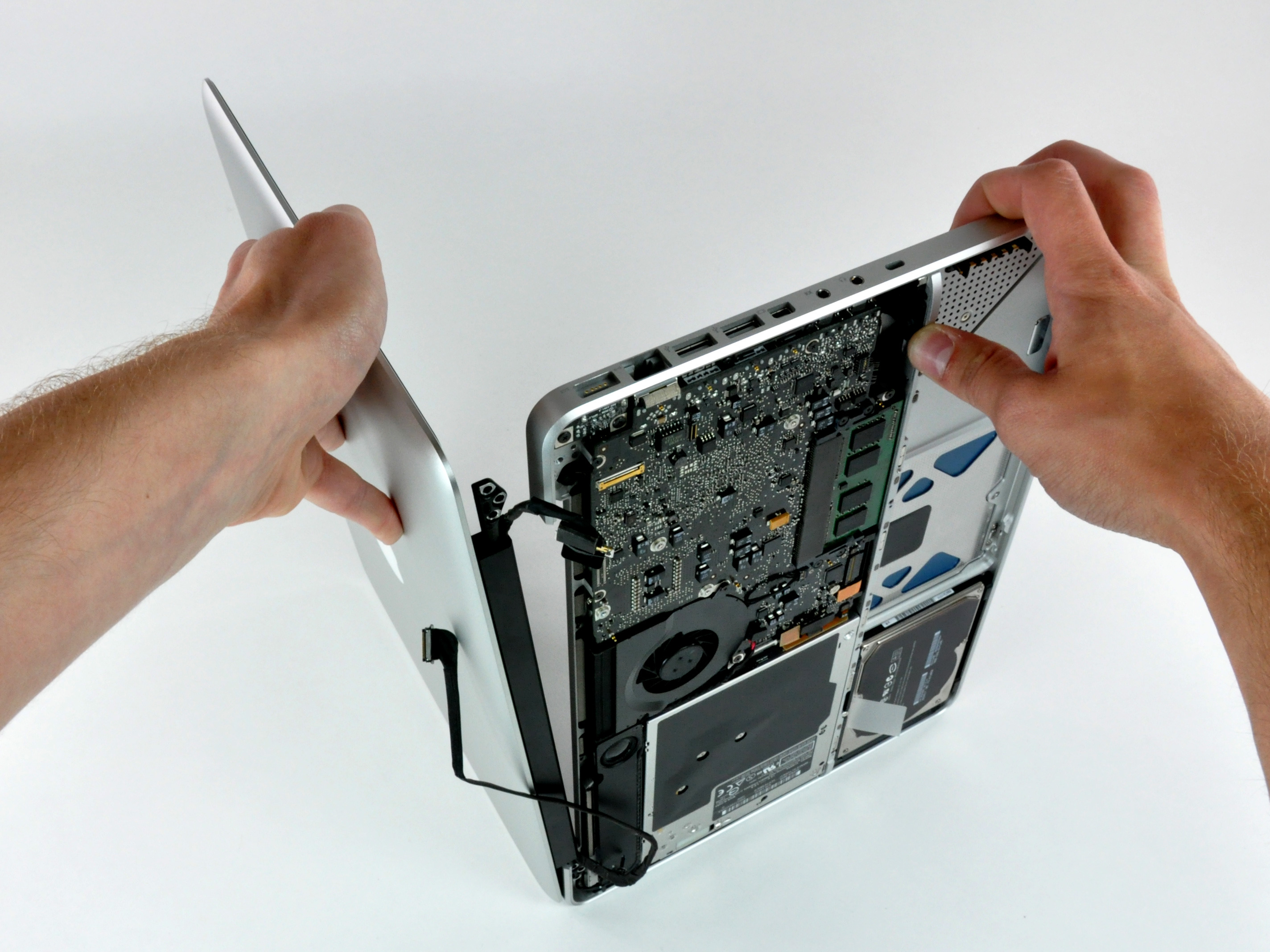

Add Note Edit Step 6 — Display Assembly  ¶
  • Disconnect the camera cable by pulling the male end straight away from its socket.
  • Make sure to pull the connector straight away and not straight up from its socket.
Image #1 Image #2
Add Note Edit Step 7  ¶
  • De-route the camera data cable from the channel in the optical drive.
Image #1 Image #2
Add Note Edit Step 8  ¶
  • Remove the following screws securing the camera data cable and right speaker to the upper case:
    • One 9.9 mm partially threaded Phillips screw
    • One 9.6 mm threaded Phillips screw
    • One 4 mm Phillips screw
  • Slide the camera cable bracket out from under the subwoofer and remove it from the computer.
  • The iSight cable has an eyelet through which passes the left-most screw in these pictures.
