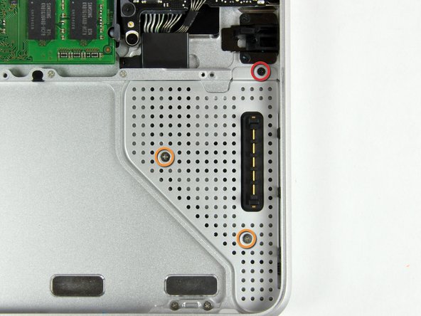

  8. MacBook Unibody Model A1278 Battery Connector Replacement, Battery Connector: step 8, image 1 of 1
    • Remove the following screws securing the battery connector cover to the upper case:
    • One 2.5 mm Phillips screw.
    • Two 1.5 mm Phillips screws.
  9. MacBook Unibody Model A1278 Battery Connector Replacement: step 9, image 1 of 1
    • Lift the battery connector cover out of the upper case.

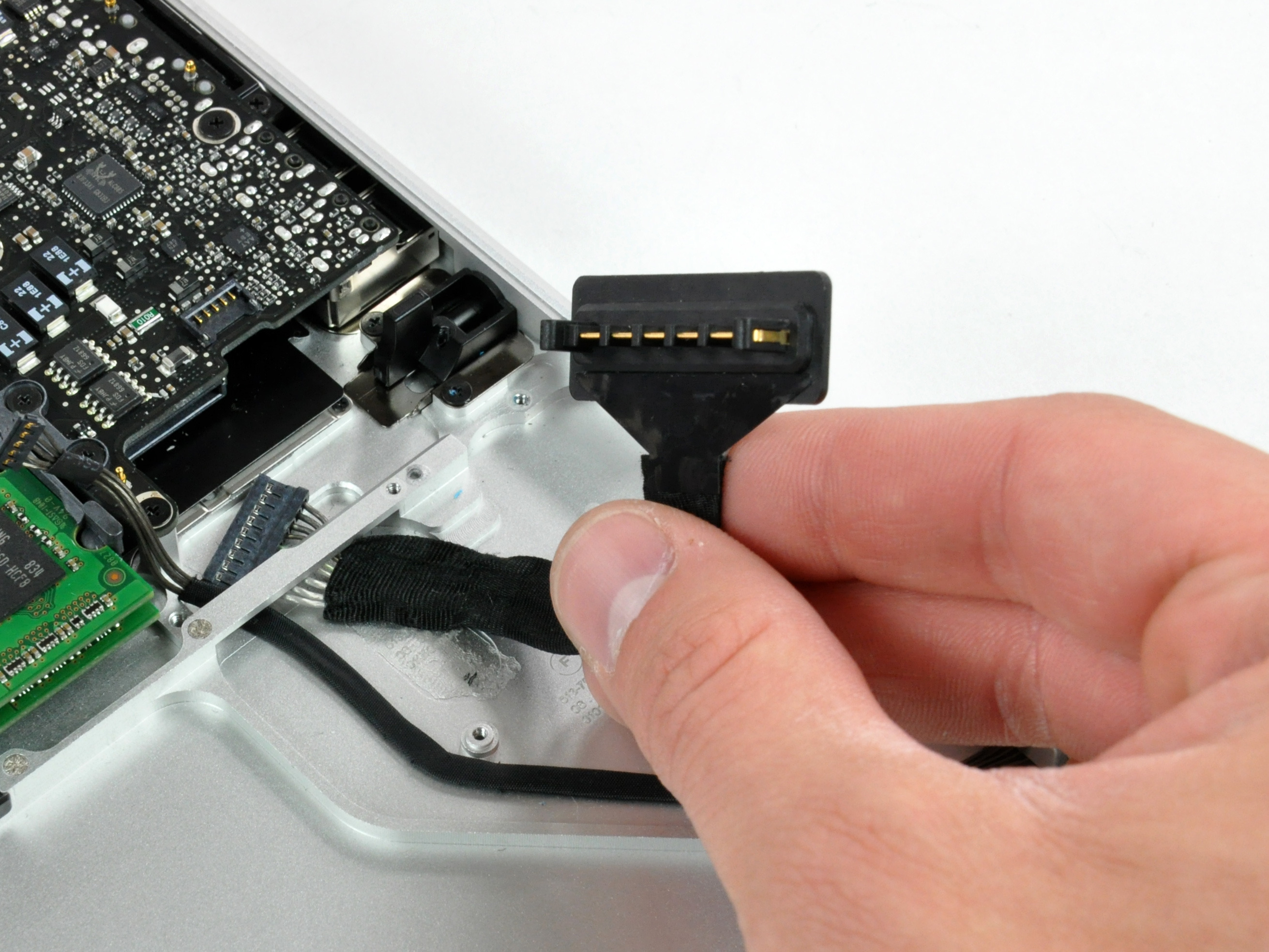

  14. MacBook Unibody Model A1278 Battery Connector Replacement: step 14, image 1 of 1
    • De-route the battery connector cable through the gap in the upper case and remove it from the computer.

When reinstalling the battery connector/cable, placement of the connector is critical. If the connector isn't positioned accurately, contact with the battery terminals won't be completed. The battery connector cover will help you align the connector, but there will still be a little leeway as you screw the cover down. Position the battery first, to adjust the connector's position; then remove the battery and tighten the cover screws down. You may even want to try plugging the computer into the AC charger before completing the cover attachment, to ensure that battery is charging and the connector is correctly positioned.
