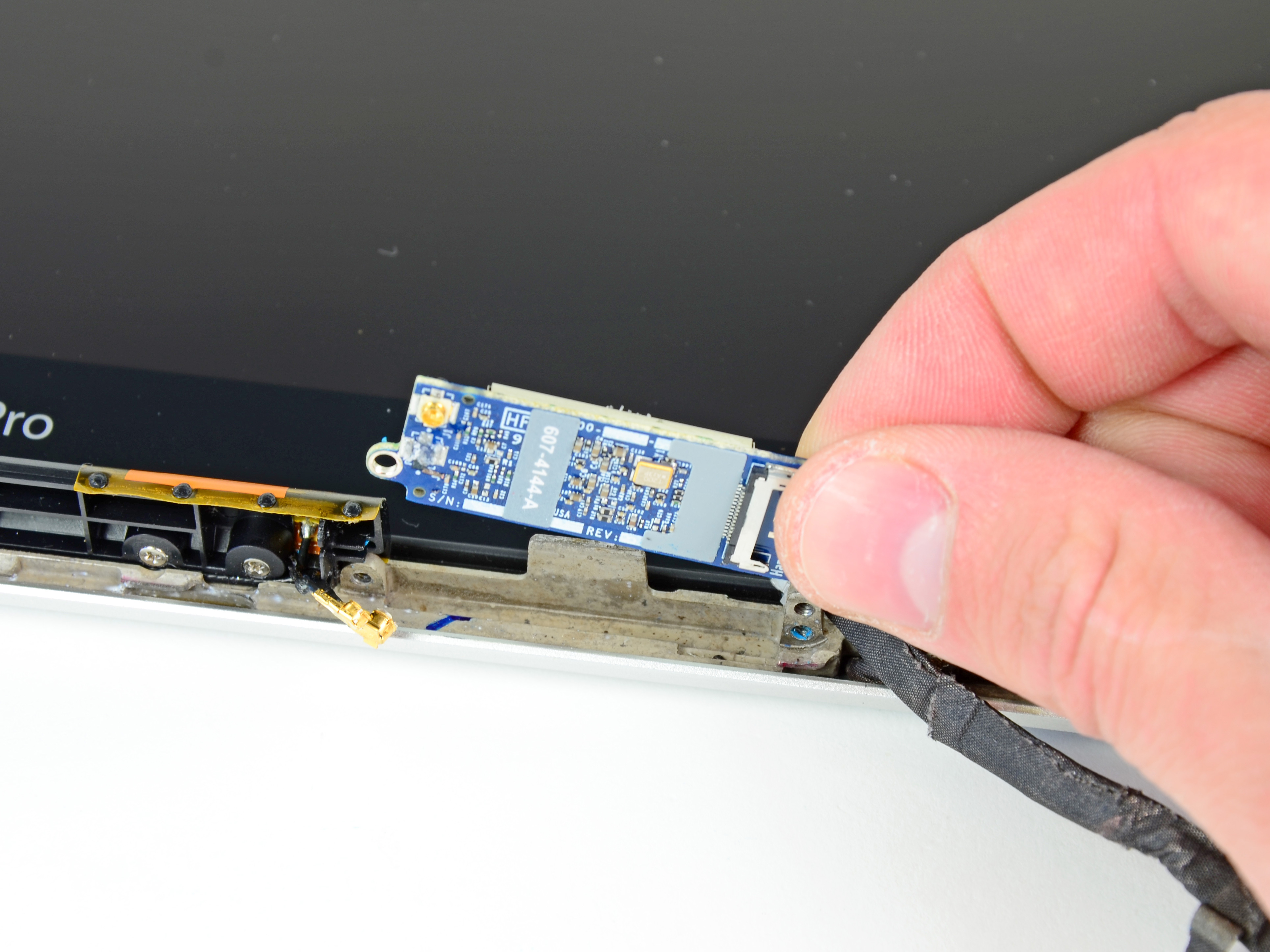

  19. MacBook Unibody Model A1278 AirPort Card Replacement, AirPort Card: step 19, image 1 of 1
    • Remove the single 3 mm Phillips screw securing the AirPort card to the display nearest the AirPort antenna.
  20. MacBook Unibody Model A1278 AirPort Card Replacement: step 20, image 1 of 1
    • Remove the single 3.3 mm Phillips screw securing the camera cable retainer to the display.
  21. MacBook Unibody Model A1278 AirPort Card Replacement: step 21, image 1 of 2 MacBook Unibody Model A1278 AirPort Card Replacement: step 21, image 2 of 2
    • Orient your display as shown and pull the black plastic camera cable retainer toward the right side of the display.
    • Remove the camera cable retainer.
  22. MacBook Unibody Model A1278 AirPort Card Replacement: step 22, image 1 of 1
    • Carefully pull the camera cable connector toward the right side of the display and out of its socket on the AirPort card.
    • When reattaching the AirPort Cable, make sure that the U-shaped notches on one side of the cable end are not visible (facing the card). If the cable is installed incorrectly, it will cause logic board damage.
  23. MacBook Unibody Model A1278 AirPort Card Replacement: step 23, image 1 of 1
    • Remove the remaining 3 mm Phillips screw securing the side of the AirPort card closest to the right clutch hinge.
  24. MacBook Unibody Model A1278 AirPort Card Replacement: step 24, image 1 of 2 MacBook Unibody Model A1278 AirPort Card Replacement: step 24, image 2 of 2
    • Pull the AirPort card away from its heat sink and remove it from the display.
    • Before installing a new AirPort card, be sure the thermal material on its surface is intact and aligned with the small heat sink on the display frame.
