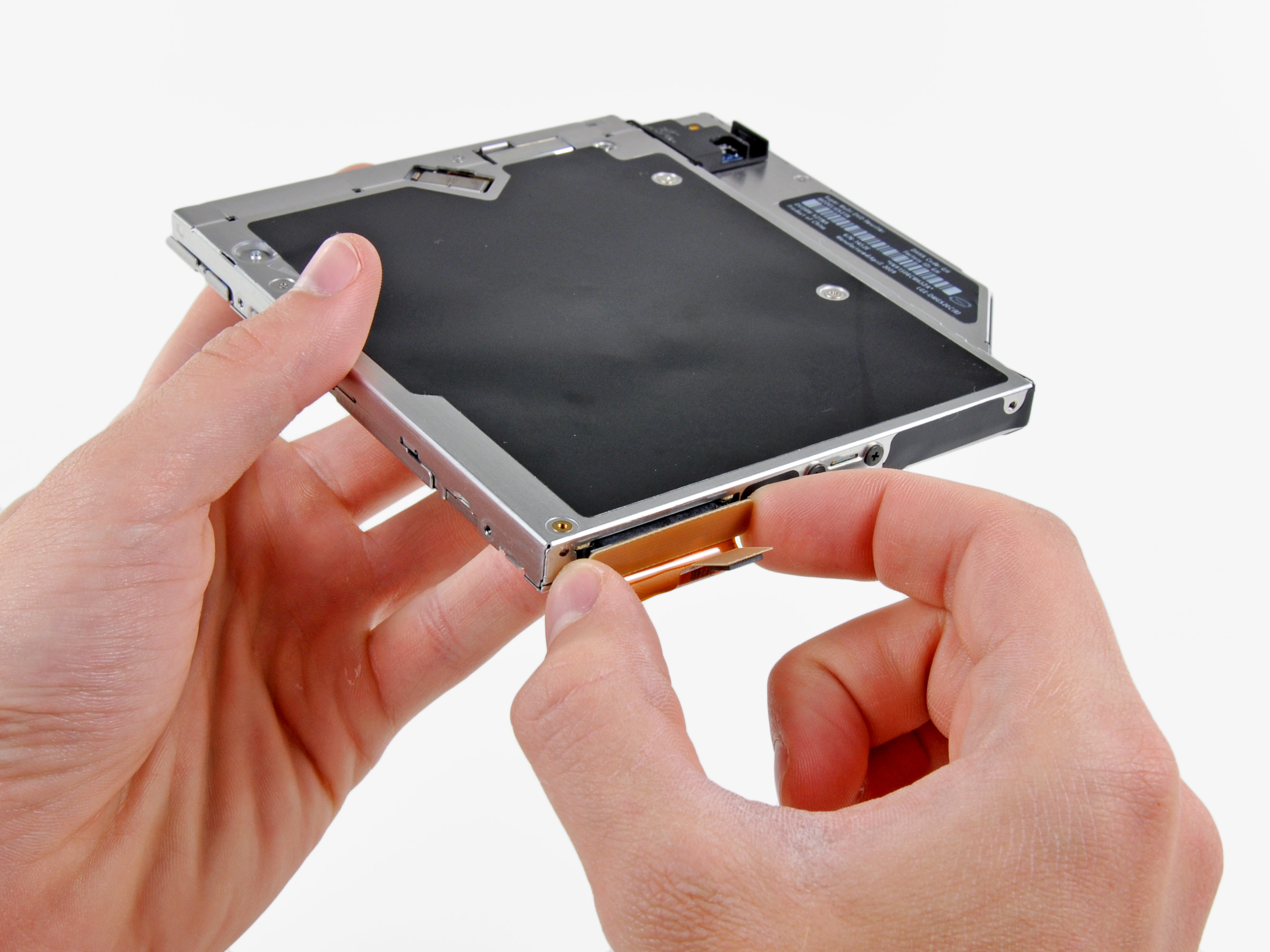

  13. MacBook Pro 17" Unibody Optical Drive Replacement, Optical Drive: step 13, image 1 of 3 MacBook Pro 17" Unibody Optical Drive Replacement, Optical Drive: step 13, image 2 of 3 MacBook Pro 17" Unibody Optical Drive Replacement, Optical Drive: step 13, image 3 of 3
    • Grab the optical drive cable by its connector and pull it away from the body of the hard drive.
    • Pulling on anything but the connector may damage the optical drive cable.
    • Remove the two black Phillips #0 screws securing the small metal mounting bracket. Transfer this bracket to your new optical drive or hard drive enclosure.
