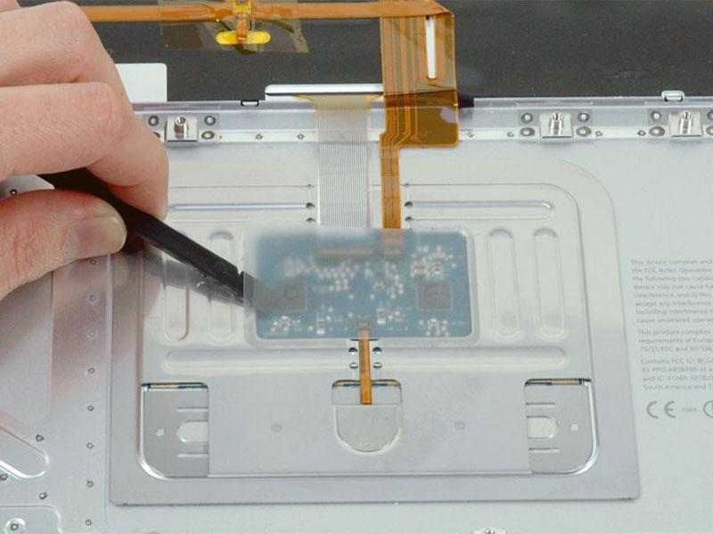

This guide shows the hidden screws you must remove when replacing the keyboard.
Image #1
  • Use your fingers to push both battery release tabs away from the battery and lift the battery out of the computer.
Image #1
Add Note Edit Step 2 — RAM Shield  ¶
  • Remove the four identical Phillips screws from the memory door.
Image #1
Add Note Edit Step 3  ¶
  • Lift the memory door up enough to get a grip on it, and slide it toward you, pulling it away from the casing.
Image #1
Add Note Edit Step 4 — Upper Case  ¶
  • Remove the three Phillips screws in the battery compartment near the latch. Apple was nice enough to tilt these screws at a slight angle to make them easier to remove.
Image #1
Add Note Edit Step 5  ¶
  • Remove the following six screws:
    • Two T6 Torx screws on either side of the RAM slot.
    • Four Phillips screws along the hinge.
Image #1
Add Note Edit Step 6  ¶
  • Remove the four Phillips screws on the port side of the computer.
Image #1
Add Note Edit Step 7  ¶
  • Rotate the computer 90 degrees and remove the two Phillips screws from the rear of the computer.
Image #1
Add Note Edit Step 8  ¶
  • Rotate the computer 90 degrees again and remove the four Phillips screws from the side of the computer.
