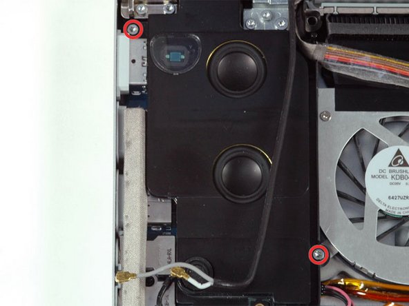

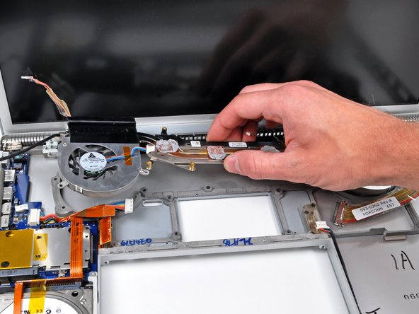

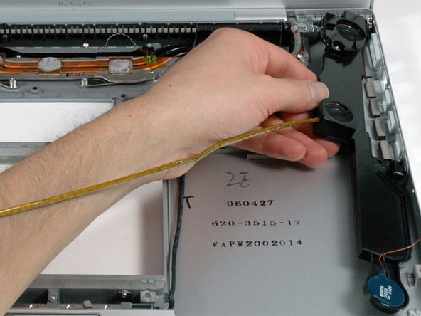

Add Note Edit Step 25  ¶
  • Remove the two 7.8 mm silver T6 Torx screws from the top left and bottom right corners of the left speaker assembly.
  • The magnet in the MagSafe connector may pull the upper screw towards it after the screw has been freed.
Image #1

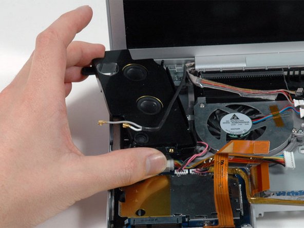

Add Note Edit Step 26  ¶
  • Lift up on the left speaker assembly and rotate it slightly. It is not possible to entirely remove the speaker yet, as it is still connected to the left I/O board beneath.
Image #1

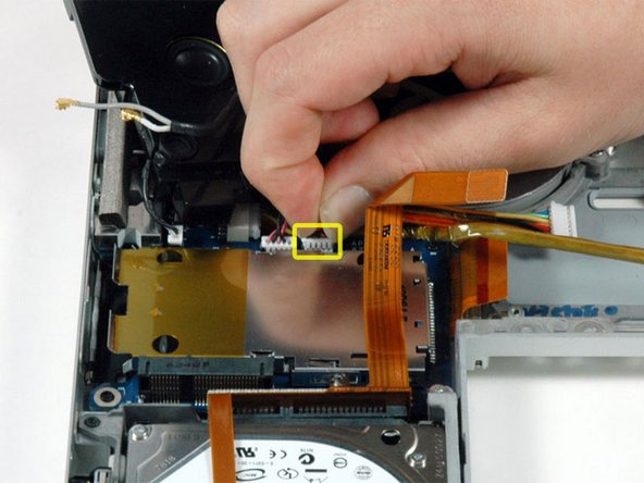

Add Note Edit Step 27  ¶
  • Disconnect the right speaker from the left I/O board. Make sure to pull on the top section of the white connector, not the cable itself.
Image #1
Add Note Edit Step 28  ¶
  • Lift the right speaker assembly out of the computer.
Image #1

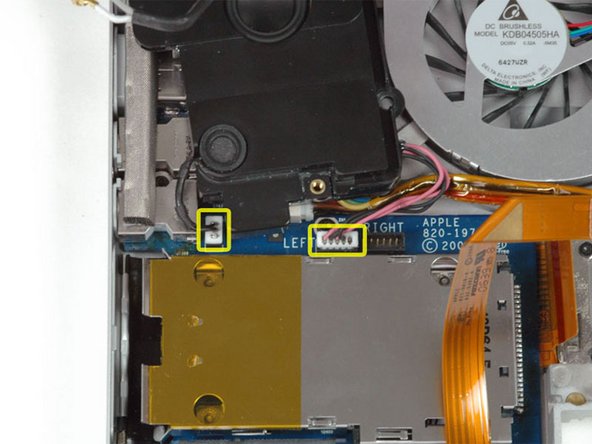

Add Note Edit Step 29  ¶
  • If tape is attaching the attenda cable bundle to the left speaker assembly remove it.
  • Disconnect the two cables attaching the left speaker assembly to the left I/O board.
Image #1

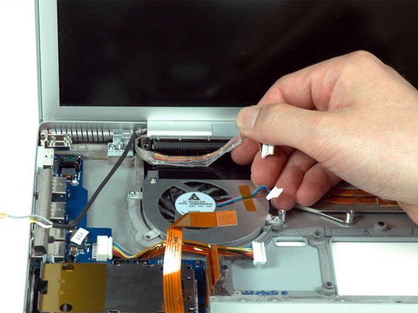

Add Note Edit Step 30  ¶
  • Peel up the iSight and inverter cables which are attached with a mild adhesive above the left fan.
Image #1

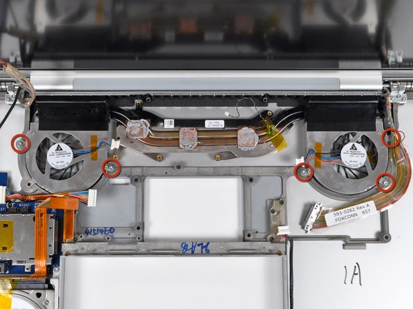

Add Note Edit Step 31  ¶
  • Remove the five 7.8 mm T6 Torx screws securing the fans to the lower case.
Image #1
Add Note Edit Step 32  ¶
  • Lift the heat sink and attached fans out of the computer.
  • If you are replacing the heat sink, be sure to transfer the attached thermal sensor to your new heat sink.
  • If you need to mount the heat sink back into the laptop, we have a thermal paste guide that makes replacing the thermal compound easy.
  • Now is a good time to lean the fans back and clean out any dust bunnies from the grill. Also clean any dried thermal paste from the heat sink contact pads.
