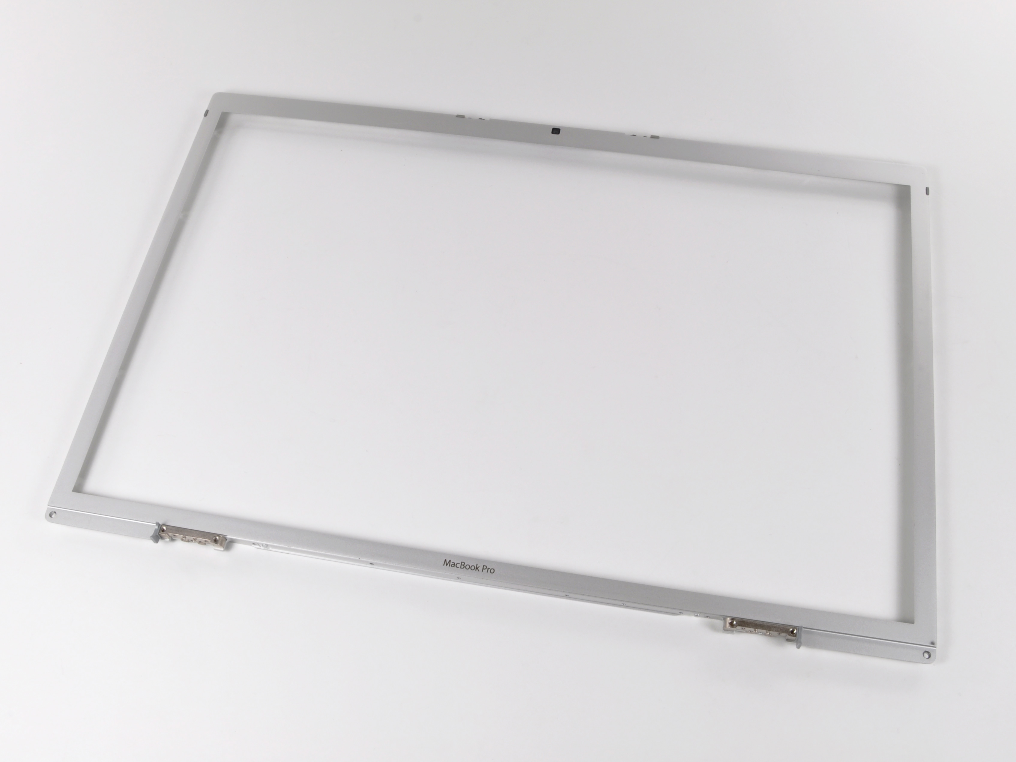

    • The next few steps will require you to separate the LCD from the adhesive applied to the upper and lower edges of the front bezel.
    • The adhesive is applied such that it sticks to a thin steel strip around the perimeter of the LCD. When prying your LCD away from the front panel, be sure you are separating the front panel from the steel strip on the LCD.
    • Use the flat end of a spudger to gently lift one of the top corners of the LCD out of the front bezel.
  44. MacBook Pro 17" Models A1151 A1212 A1229 and A1261 Front Display Bezel Replacement: step 44, image 1 of 1
    • Work your way along the top edge of the LCD, slowly prying the attached steel strip away from the front bezel.
    • Continue prying the LCD off the front bezel along the left side of the display.
  45. MacBook Pro 17" Models A1151 A1212 A1229 and A1261 Front Display Bezel Replacement: step 45, image 1 of 1
    • Now that the top and left edges are free, slightly lift the LCD out of the front bezel for enough room to pry the steel strip along the lower edge of the LCD away from the front bezel.
    • Pry along the lower edge of the LCD until it is freed from the adhesive on the front bezel.
  46. MacBook Pro 17" Models A1151 A1212 A1229 and A1261 Front Display Bezel Replacement: step 46, image 1 of 2 MacBook Pro 17" Models A1151 A1212 A1229 and A1261 Front Display Bezel Replacement: step 46, image 2 of 2
    • Lift the LCD out of the front bezel, minding any cables that may get caught.
    • Replacement Note: there are clear plastic spacers attached via adhesive to the sides and bottom of the lcd panel. Be sure to transfer these spacers to the replacement panel for optimum fit.
    • Front bezel remains.
