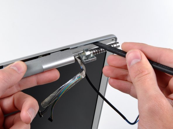

Add Note Edit Step 14 — Rear Display Bezel  ¶
  • The hinge end caps on this model can be easily removed at this point, as they are not fastened to the hinge and may fall off during service.
  • Remove the Phillips screws from the lower left and right corners of the display (two screws total).
Image #1 Image #2 Image #3

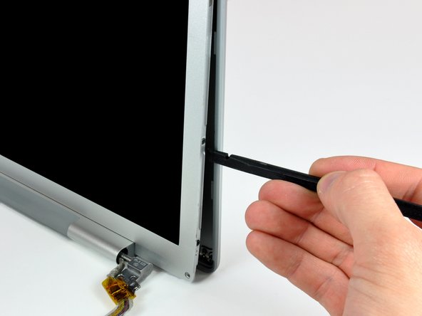

Add Note Edit Step 15  ¶
  • Insert the flat end of a spudger perpendicular to the face of the display between the plastic strip attached to the rear bezel and the front bezel.
  • Do not insert your spudger between the plastic strip and the rear bezel.
  • With the spudger still inserted, rotate it away from the display to separate the front and rear bezels.
  • Work along the right edge of the display until the rear bezel is evenly separated from the front bezel.
Image #1 Image #2

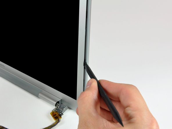

Add Note Edit Step 16  ¶
  • Insert your spudger between the front and rear display bezels at the lower right corner of the display.
  • Pry the rear bezel away from the front bezel to slightly separate the bottom edge of the rear display bezel.
Image #1 Image #2

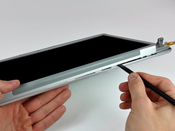

Add Note Edit Step 17  ¶

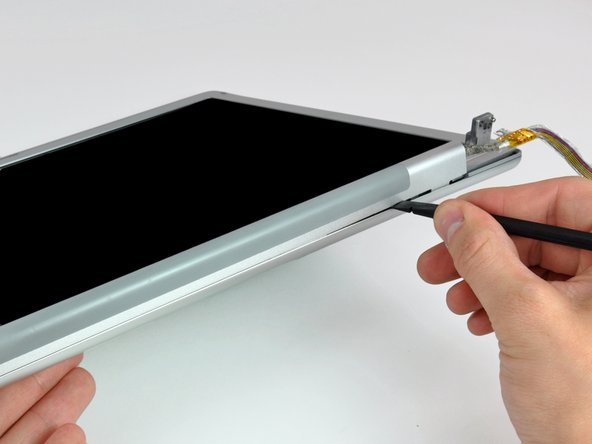

  • Insert the flat end of a spudger into the gap between the rear display bezel and the clutch cover.
  • Twist the spudger to separate the lower edge of the rear display bezel from the clutch cover.
  • Work along the lower edge of the rear bezel until it is evenly separated from the clutch cover.

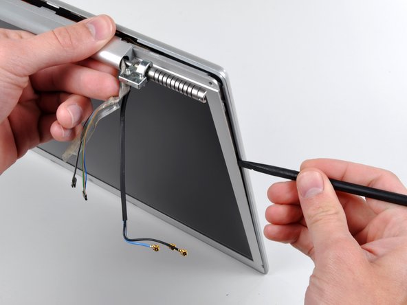

Add Note Edit Step 18  ¶
  • Now that the right and bottom edges of the rear bezel are slightly separated from the front bezel, use a spudger to pop the rear bezel off the tabs near the lower right corner of the display.

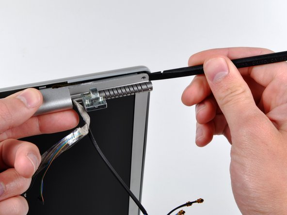

Add Note Edit Step 19  ¶
  • Insert the flat end of a spudger between the front bezel and the plastic strip attached to the rear bezel near the screw holes at the bottom corners of the display.
  • Rotate your spudger toward the rear bezel to separate it from the front bezel.

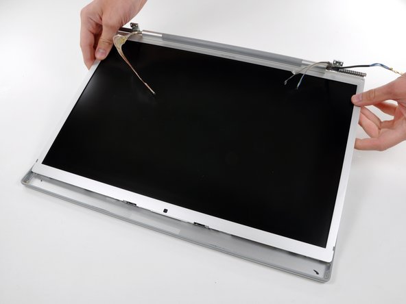

  • If necessary, continue separating the left edge of the rear bezel off the tabs on the front display bezel.
Image #1
Add Note Edit Step 20  ¶

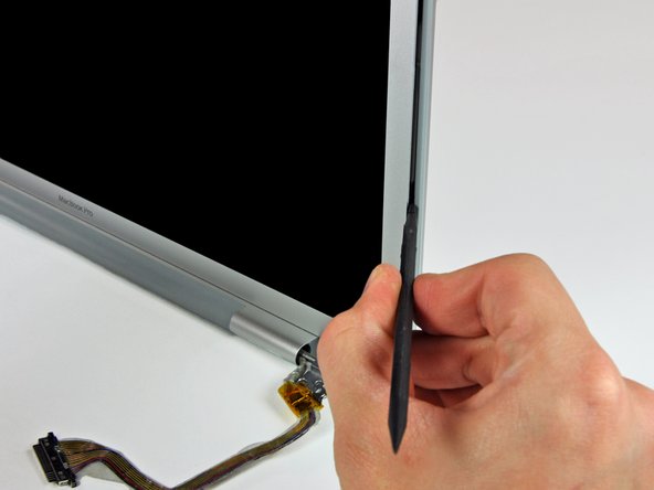

  • Slightly lift the lower edge of the display and pull it away from the rear display bezel.
  • The rear display bezel remains.

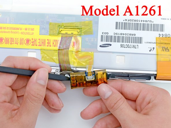

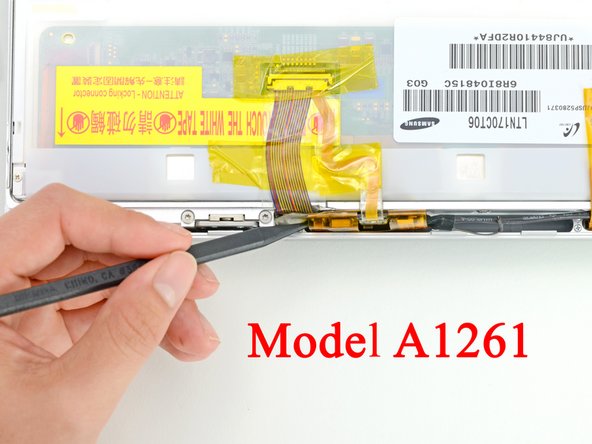

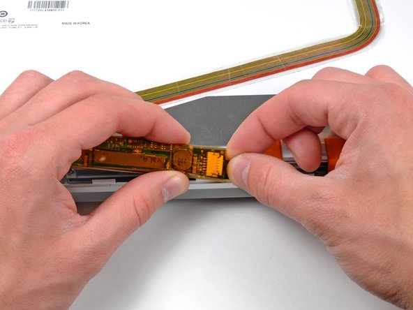

Add Note Edit Step 21 — Display Inverter  ¶

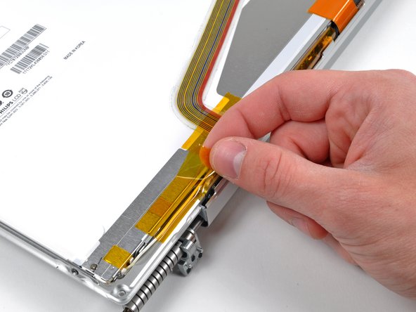

  • Remove the piece of tape securing the backlight cables to the front display bezel.

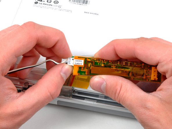

Add Note Edit Step 22  ¶

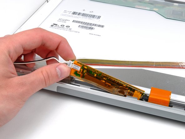

  • Carefully lift the inverter out of the clutch cover.
Image #1 Image #2
Add Note Edit Step 23  ¶

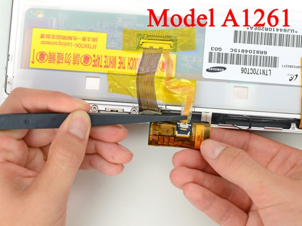

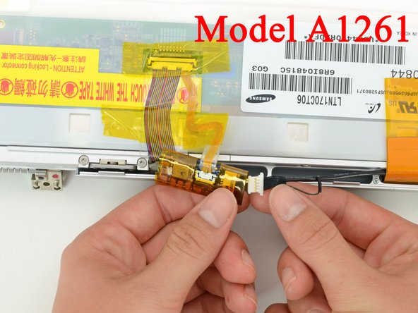

  • Disconnect the inverter cable by pulling its connector away from the socket on the inverter board.
Image #1 Image #2
Add Note Edit Step 24  ¶
  • Disconnect the backlight connector from the inverter board.
  • Be careful when removing this connector, as it may be firmly seated in its socket.
  • Remove the inverter from the display.

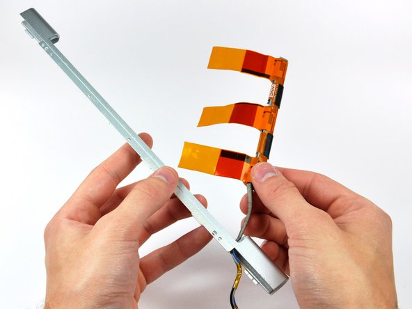

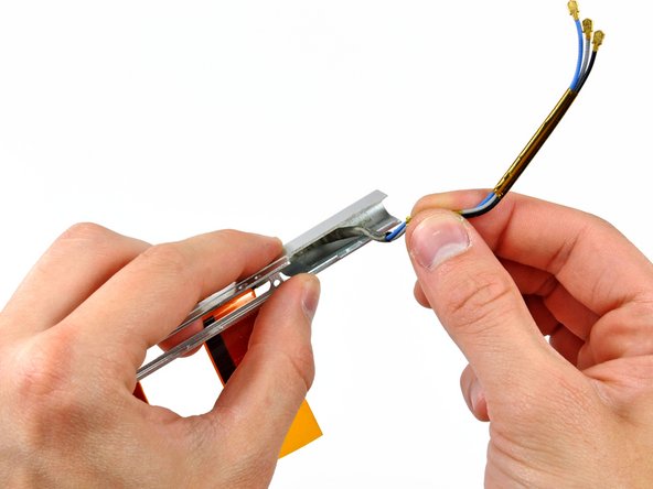

Add Note Edit Step 35 — Antenna Cables  ¶
  • If necessary, peel the antenna leads off the adhesive securing them to the clutch cover.
Image #1
Add Note Edit Step 36  ¶
  • Remove the antenna cables from the clutch cover, being careful not to damage the three antenna straps.
Image #1

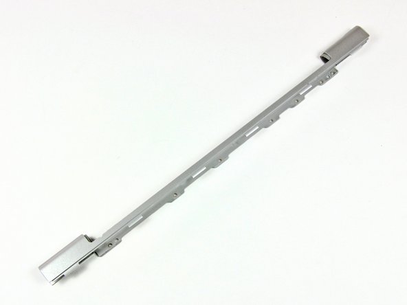

Add Note Edit Step 37 — Clutch Cover  ¶
  • Clutch cover remains.
