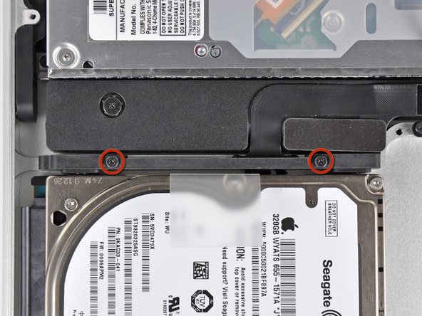

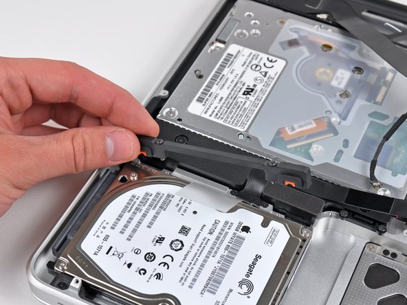

  • Remove the two Phillips screws securing the hard drive bracket to the upper case.
  • These screws are captive in the hard drive bracket.
  • Remove the hard drive bracket from the upper case.
Image #1

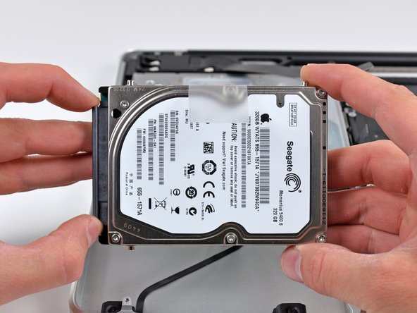

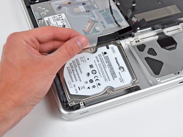

Add Note Edit Step 28  ¶
  • Using its attached pull tab, lift the hard drive out of the upper case.
  • Don't try to completely remove it yet, as it is still connected to the hard drive cable.
Image #1 Image #2

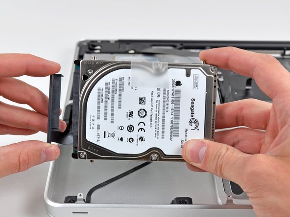

Add Note Edit Step 29  ¶
  • Pull the hard drive connector out of its socket on the hard drive.
  • Pull on the connector, not the cable itself.
  • Remove the hard drive and set it aside.
Image #1

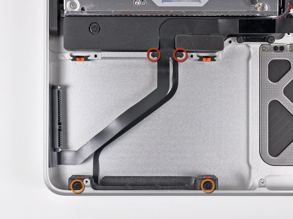

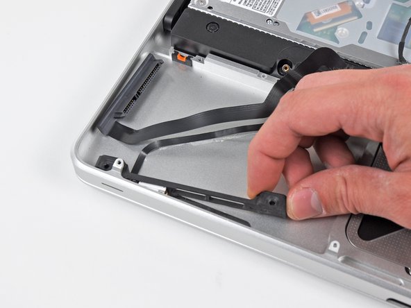

  • Remove the following four screws securing the hard drive/IR sensor cable to the upper case:
    • Two 2.5 mm Phillips screws.
    • Two 10 mm Phillips screws.
Image #1 Image #2
Add Note Edit Step 31  ¶

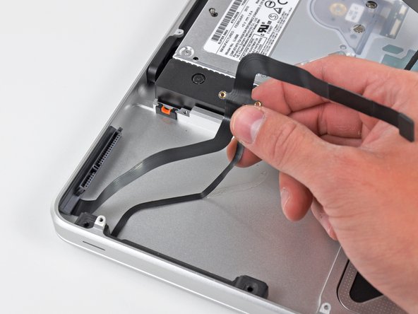

  • Carefully peel the IR sensor cable off the adhesive securing it to the upper case.
  • Pull the hard drive bracket/IR sensor housing away from the side of the upper case.
  • Remove the hard drive/IR sensor cable from the upper case.

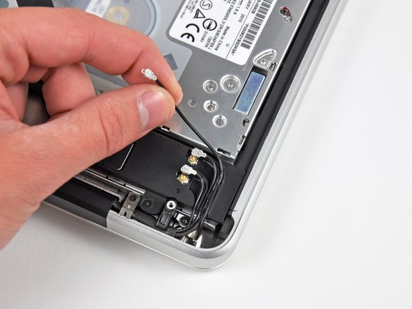

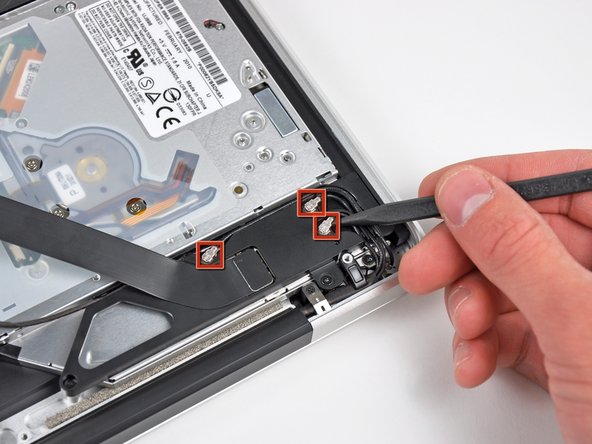

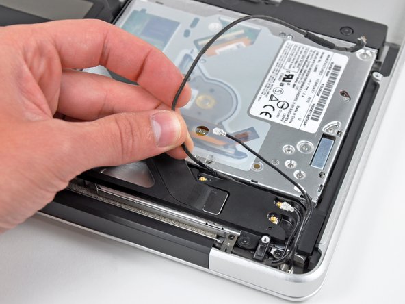

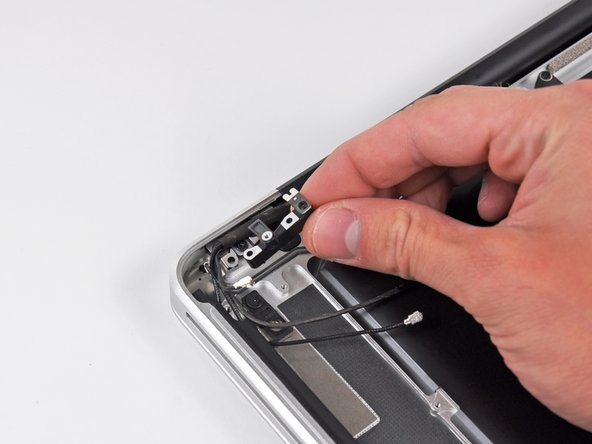

  • Use the tip of a spudger to pry all three AirPort/Bluetooth antenna connectors up off the AirPort/Bluetooth board.
Image #1 Image #2
Add Note Edit Step 33  ¶
  • De-route the three antenna cables from their channels in the AirPort/Bluetooth housing.
  • De-route the camera cable from its channel in the AirPort/Bluetooth housing.
Image #1 Image #2

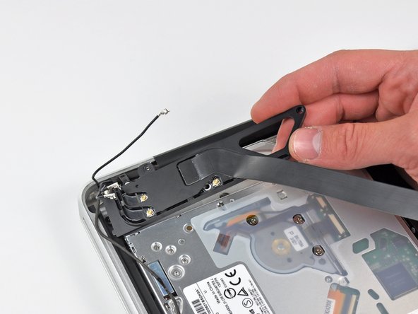

Add Note Edit Step 34  ¶

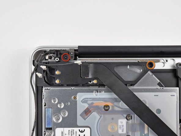

  • Remove the following two screws securing the AirPort/Bluetooth housing to the upper case:
    • One 3.8 mm Phillips
    • One 8.6 mm Phillips
  • Remove the AirPort/Bluetooth assembly from the upper case, minding any cables that may get caught.
Image #1 Image #2

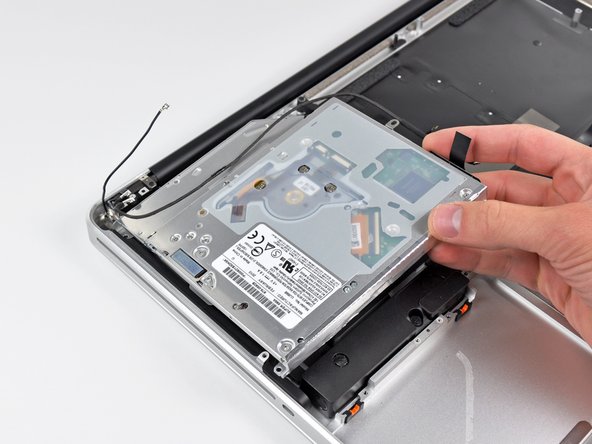

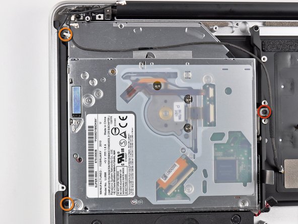

  • Remove the following three Phillips screws securing the optical drive to the upper case:
    • One 4.5 mm Phillips screw securing the optical drive bracket to the upper case near the fan.
    • Two 2.5 mm Phillips screws securing the optical drive to the upper case near the optical drive opening.
    • In some cases, all three may be 2.5mm screws.
  • Remove the optical drive from the upper case.
Image #1 Image #2

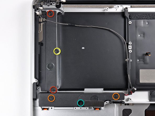

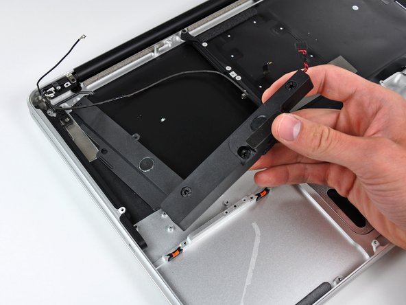

  • Remove the following six screws securing the subwoofer and right speaker to the upper case:
    • Two 3.2 mm Phillips screws.
    • Two 12.3 mm Phillips screws.
    • One 2.5 mm Phillips screw.
    • One 8.3 mm Phillips screw.
  • Remove the subwoofer/right speaker from the upper case.

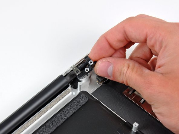

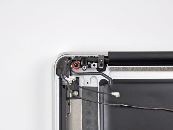

  • Remove the 8.6 mm Phillips screw securing the antenna/camera cable retainer to the upper case.
  • Remove the antenna/camera cable retainer from the upper case.
Image #1 Image #2

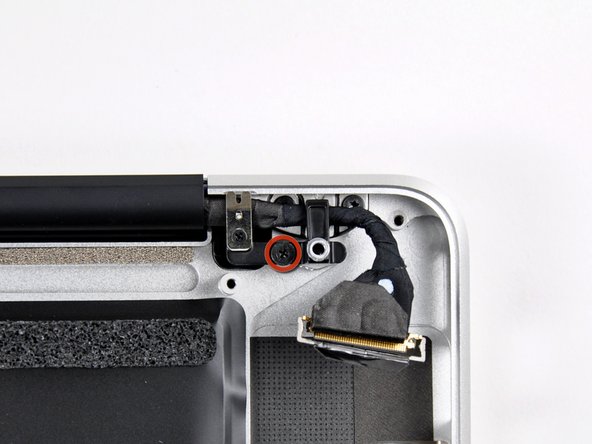

Add Note Edit Step 38  ¶
  • Remove the single 8.6 mm Phillips screw securing the display data cable retainer to the upper case.
  • Remove the display data cable retainer from the upper case.
Image #1

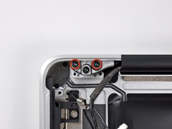

Add Note Edit Step 39  ¶

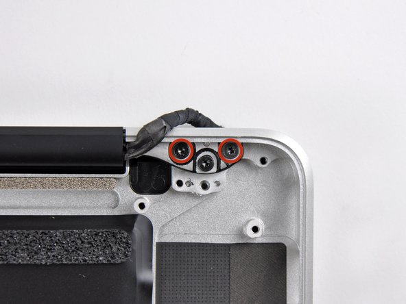

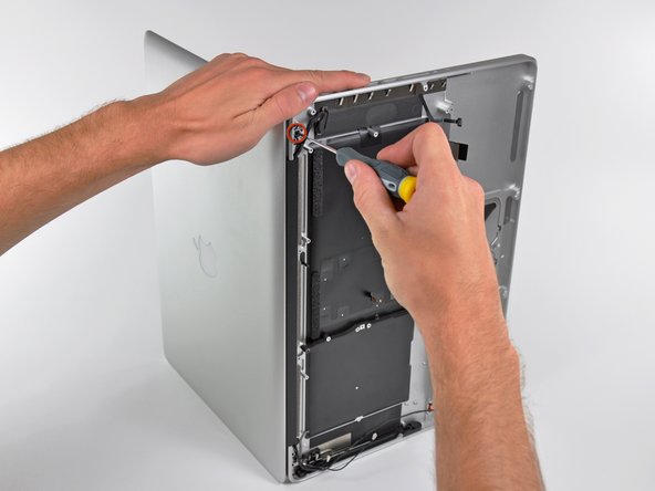

  • Remove two of the three 6 mm T6 Torx screws securing the right side of the display to the upper case.
  • We purposely have you leave one screw attaching the display to the upper case to aid in future steps.
Image #1
Add Note Edit Step 40  ¶
  • Remove two of the three 6 mm T6 Torx screws securing the left side of the display to the upper case.
Image #1

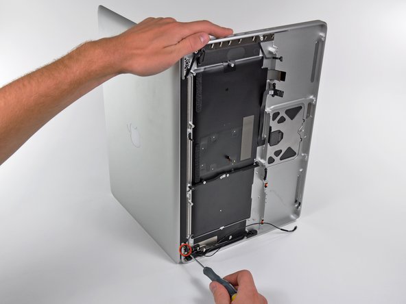

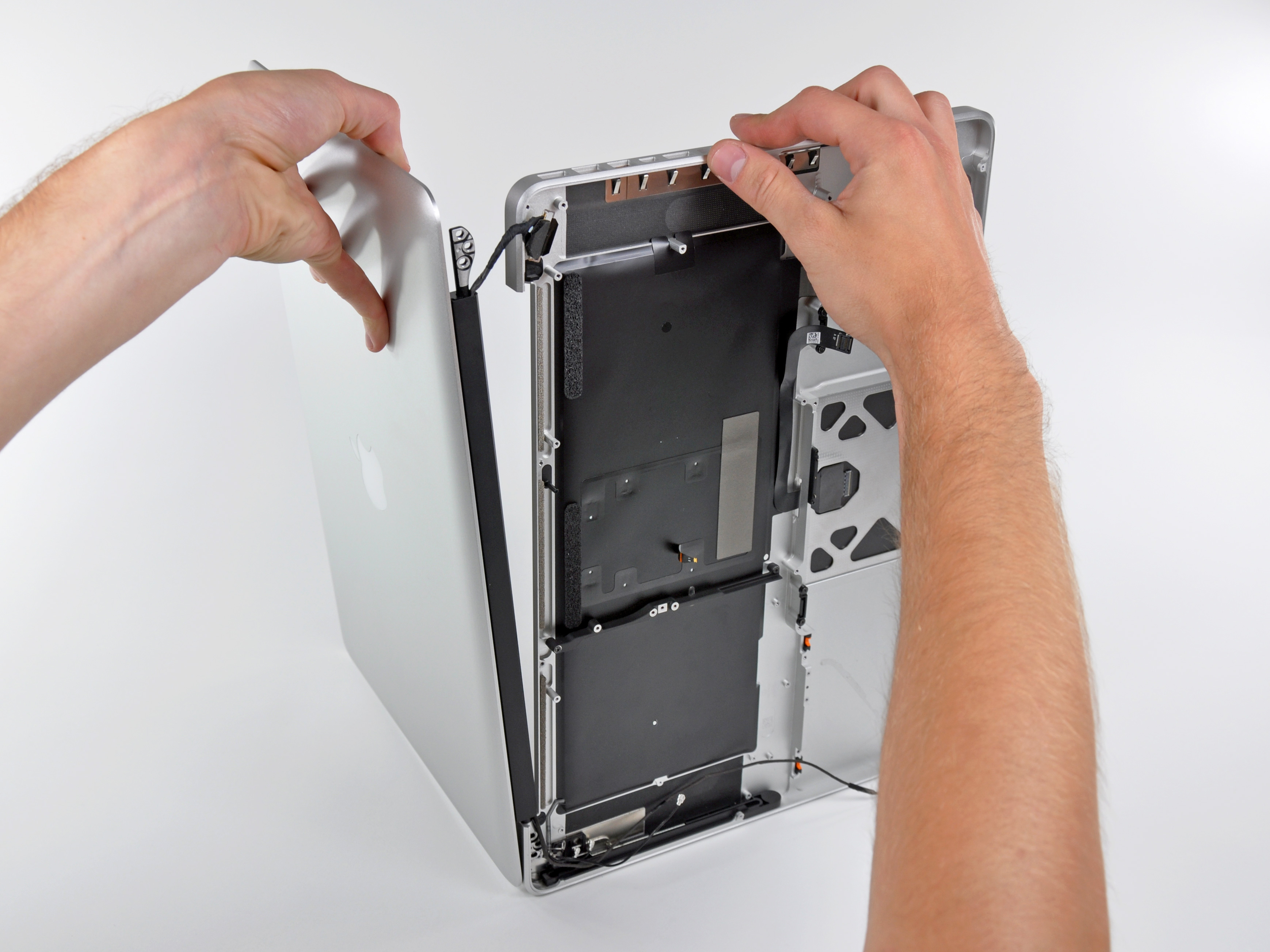

Add Note Edit Step 41  ¶
  • Open your MacBook Pro so the display is perpendicular to the upper case.
  • Place your opened MacBook Pro on a table as pictured.
  • While holding the display and upper case together with your left hand, remove the remaining T6 Torx screw from the upper display bracket.
Image #1
Add Note Edit Step 42  ¶
  • Be sure to hold the display and upper case together with your left hand. Failure to do so may cause the freed display/upper case to fall, potentially damaging each component.
  • Remove the last remaining T6 Torx screw securing the display to the upper case.
Image #1 Image #2 Image #3

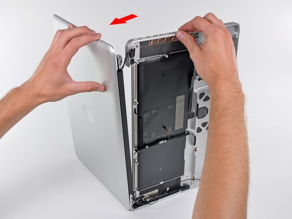

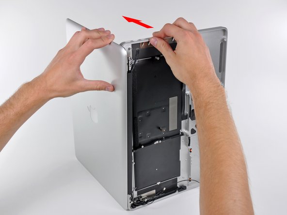

Add Note Edit Step 43  ¶
  • Grab the upper case with your right hand and rotate it slightly toward the top of the display so the upper display bracket clears the edge of the upper case.
  • Rotate the display slightly away from the upper case.
  • Lift the display up and away from the upper case, minding any brackets or cables that may get caught.
